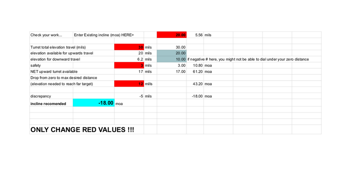

Thank you, with this help I was able to make a google sheet to help me find my optimal rail incline. Heres a copy of what I did on google sheets.
Check it out, just change value in YELLOW HIGHLIGHTED FIELDS ONLY
