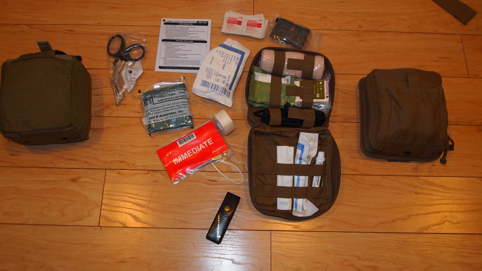

KIT LIST:
Tourniquet - CAT, SOF-T - the other brands I know of do not easily allow for it to be tightened well enough to be effective. Both of these are one handed operation - key element.
Quickclot Combat Guaze -There was a study of all available hemostatic dressings. They used pigs and did real time tests on clotting. This one came out way above in all categories. No messing around. You want the Z-folded guaze, not a sponge, not the powder. All other guazes are not the same.
Pressure dressing. I like 2 sizes, I use a 4" and a 6". I like the rolled variety. These are prepackaged a easy to use.
Halo Chest Seal - I do not know of another brand. They make vented and unvented. Proper use and knowledge of what to use come from the class.
Nasopharyngeal Airway 28F - this will fit most. This provides a way to keep an open airway in an unconscious patient with a gag relfex. You will learn about this in class. DO NOT FUCK around with this if you dont know. If there is further facial trauma with fractures going into the basilar skull, you could stick this into the brain. This will certainly kill them.
Trauma Shears - basic and cheap. Allow rapid access to wounds. Can cut tape, bandages, or whatever else. Nice Titanium ones can be found on Ebay or Amazon. They are nicer and stay sharper much longer.
If you shoot at a busy range, maybe throw some gloves in - keep yourself safe at all times!
Except for the shears, all items can be found at rescue-essentials.com There are other places, but they have a good selection, good prices, and flat rate shipping.
Unless you are actually an operator [(no, you are not)if you are, your employer usually furnishes this gear?], I recommend bright ass colors for your tourniquet, dressing packaging, and shears. Easier to find once you dump your IFAK, easy to see tourniquets are awesome on the receiving end, hard to miss.

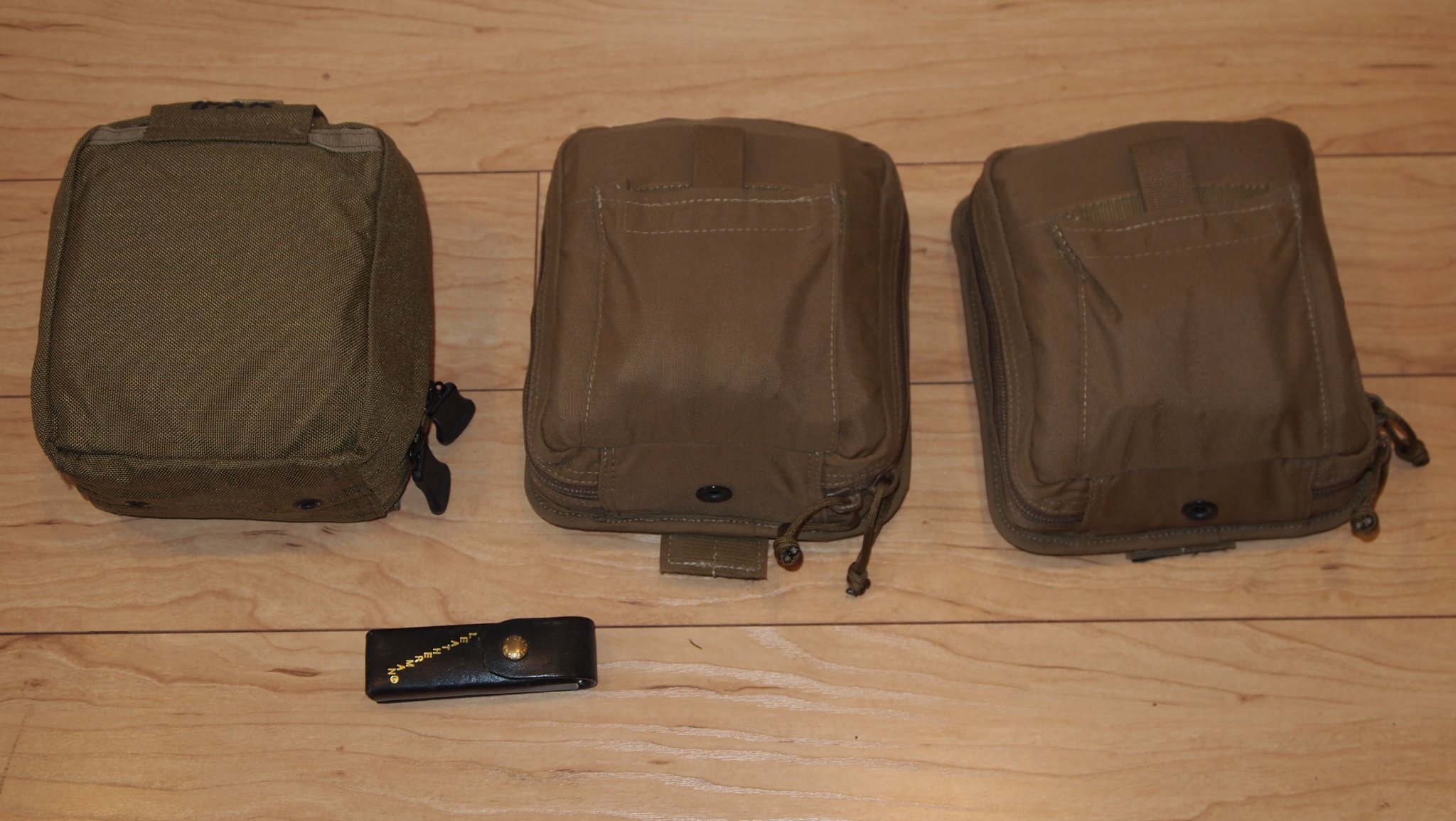

There are many ways to store an IFAK. Most of the well known brands of gear aimed at the tactical crowd makes a kit especially for this. HSGI, blue force, 5.11, many others.
I use a cheap 5.11 6x6 MOLLE pouch or the next size up. Its all I need and my list is a bit bigger than what is listed above based on my knowledge.

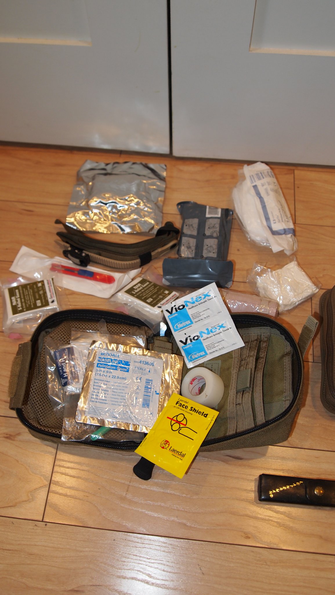

It looks like 8/28/2015 I initially answered into this thread knowing that a good IFAK is something I need.
Well I dicked about until Jared above jumped and said he could do something about my lack of preparedness.
I took Jared up on his offer to communicate and assist.
I told him I have the need for three kits
1. To go on a plate carrier for work needs. Think gunshots and trauma.
2. To go on my range bag. Think gunshots and maybe the need to deal with a boo-boo.
3. To go on my hiking pack. More likely to be used dealing with the kids getting a boo-boo, maybe a burn of sorts, and possibility to deal with more serious bleeding if need be.
Jared hooked me up with three kits. Leatherman is an old vintage standard type for scale.....
This is the plate carrier IFAK. In addition I had him send me two SOF-T style tourniquets for separate holders that came with my carrier. I think its pretty complete for my level of training and the extra gear is intended to have available to drop and go for someone to self help or others to provide immediate aid.....
The range bag and hike kits are pretty similar and again they provide me with a good spread of treatment options from boo-boo to Oh Fuck.
The care/triage cards are good adds I wasn't expecting.
Ill probably take these all apart and move some around here and their but from the conversations I had with Jared he provided what I asked and in well packaged kits. The canvas gear is made in USA and the contents are OEM not Chinese Ebay knock offs.
I wont go into pricing because what I asked for will differ from what you ask for. I will say that I dont think Jared is looking to get a share of your future earnings because you saved your life with this gear as some companies seem to be doing with their pricing.
Now Im sure real knowledgeable people can probably critique an IFAK and say "Why have that when you should have had this?" but I think that is counter productive.
All I see is the benefit that a guy that procrastinated for three years finally got off his ass and did something about his unpreparedness because someone with some knowledge, access and desire held his hand and made him do so.

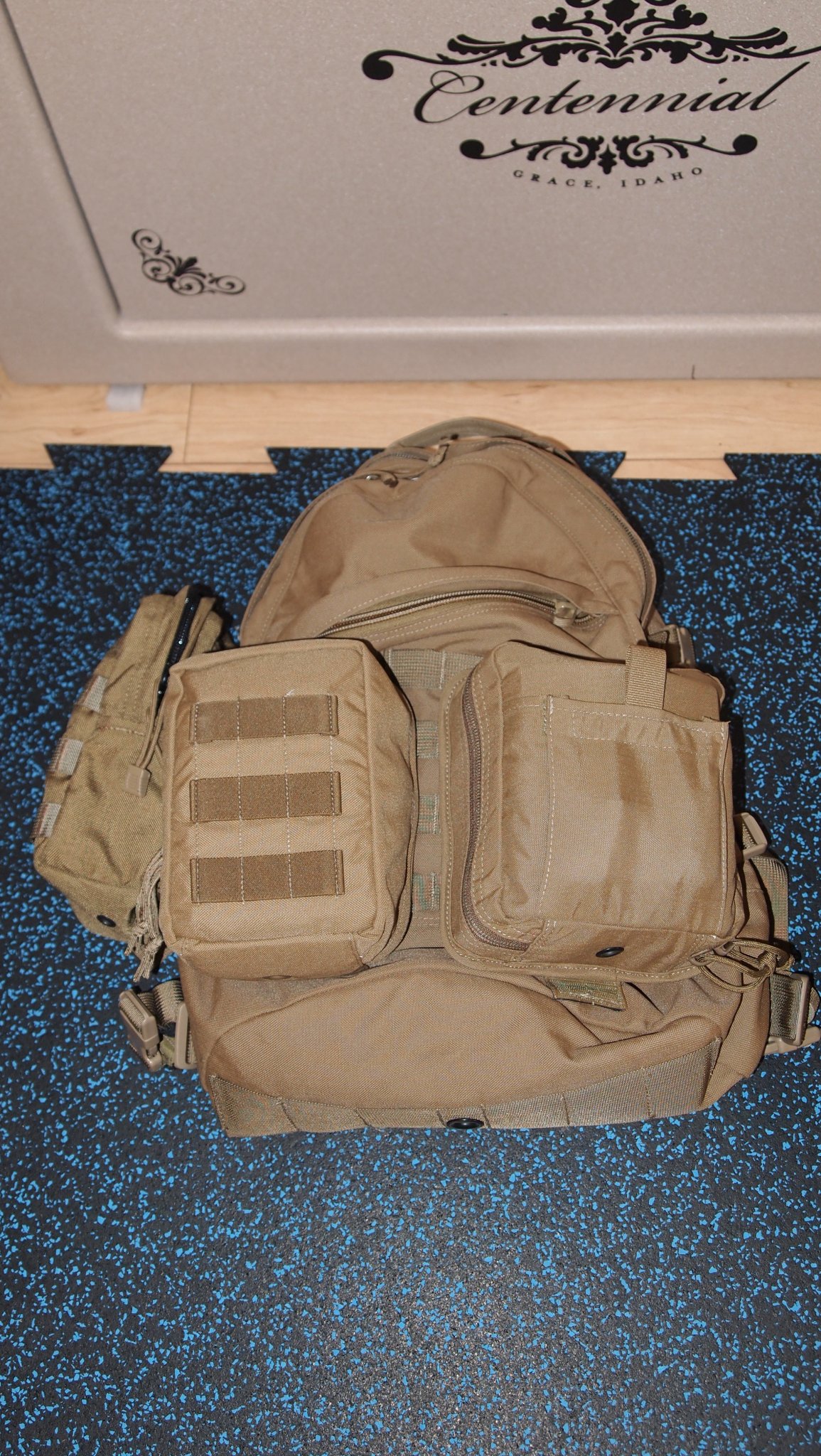

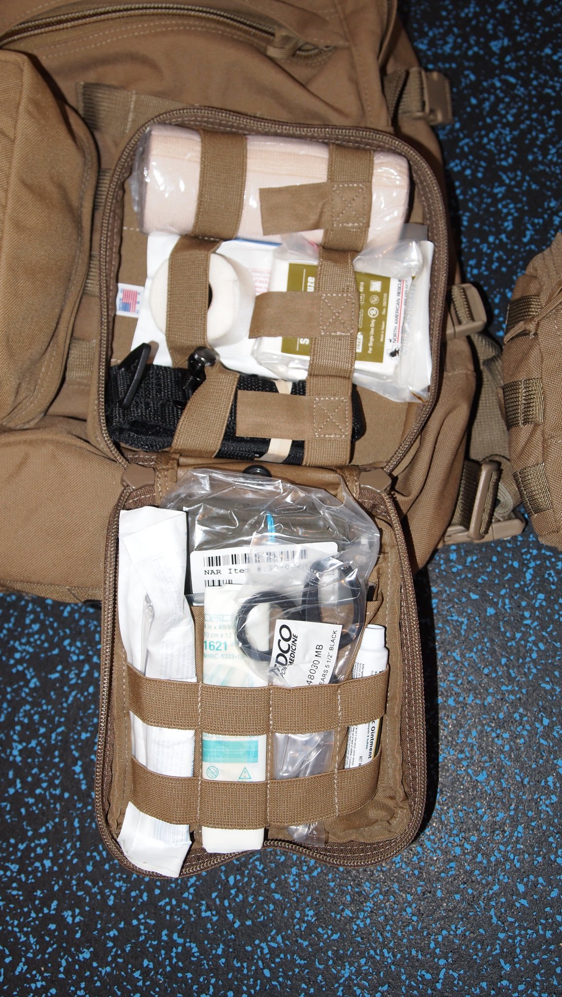

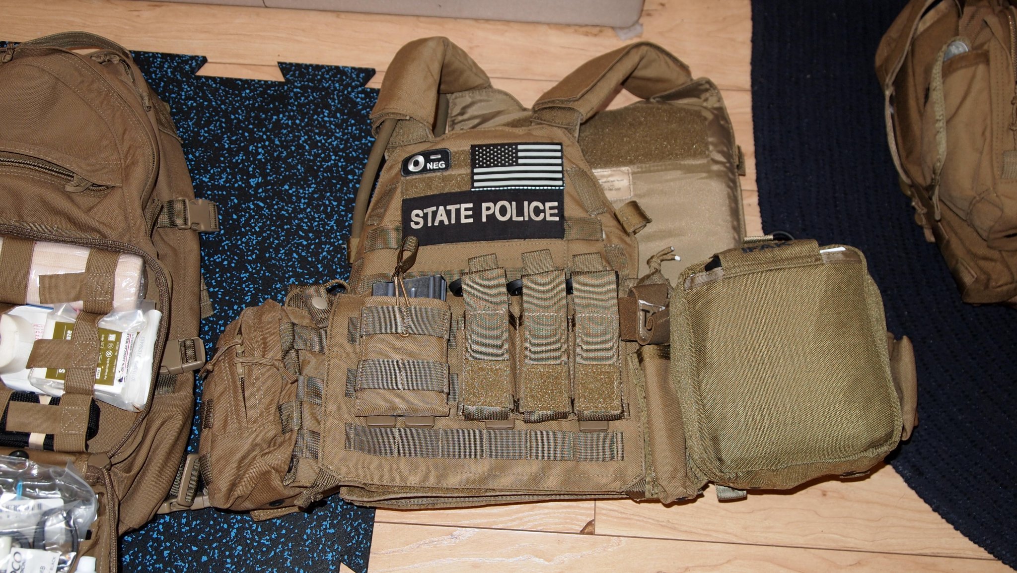

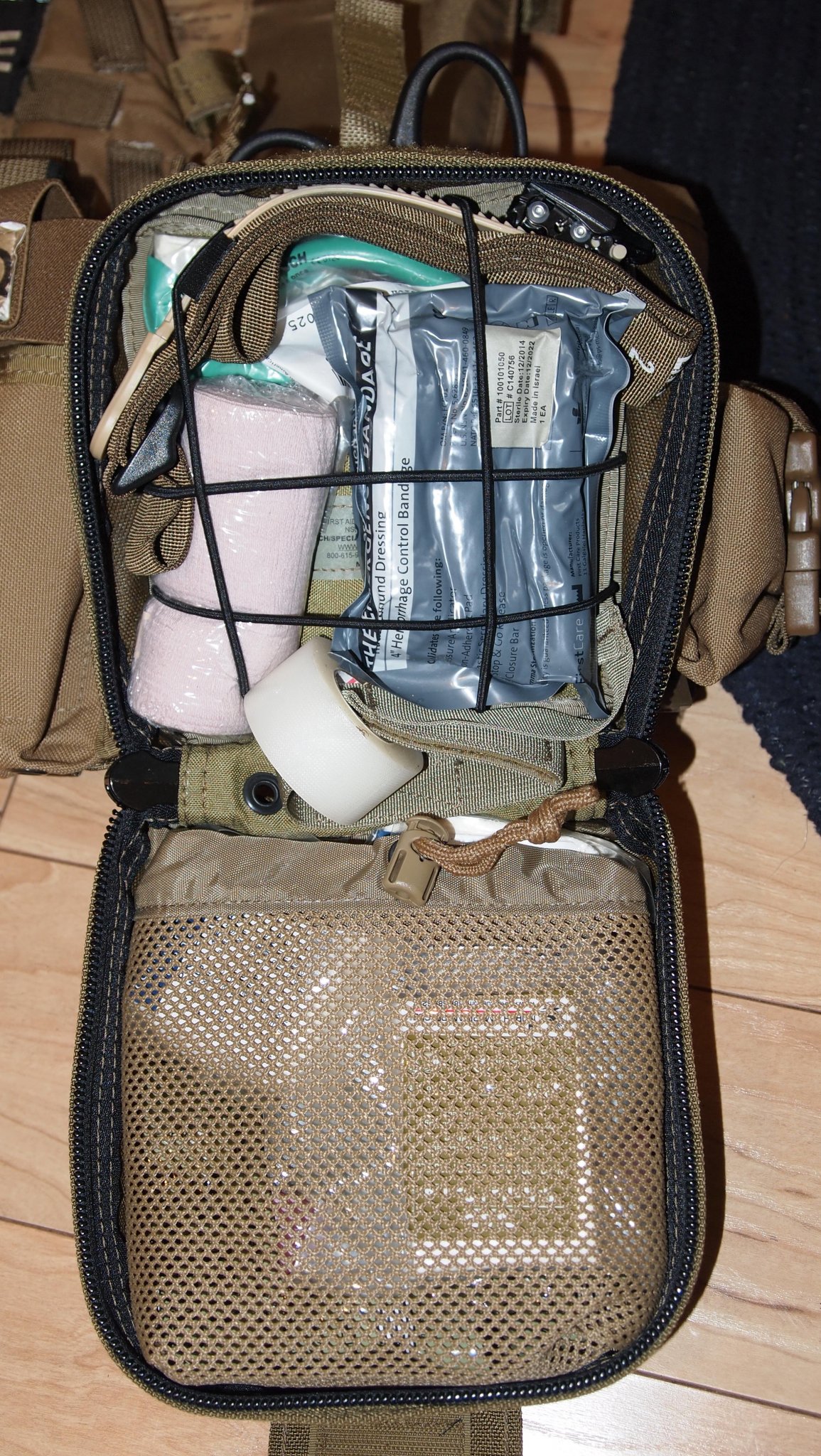

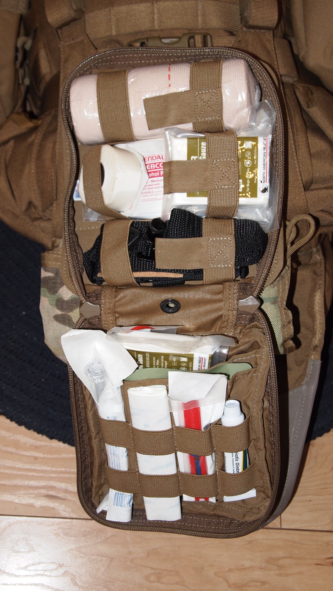

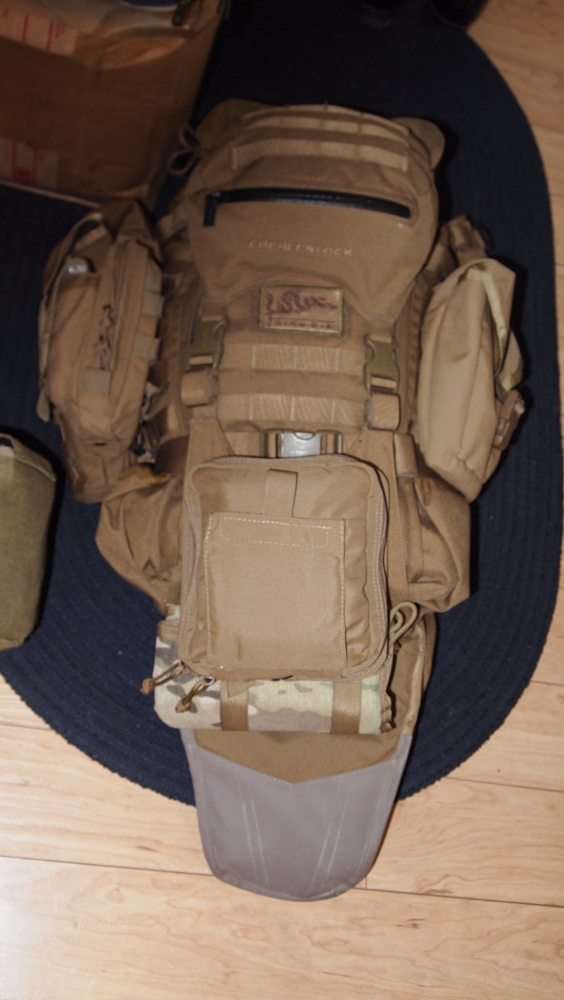

Got them set up......
Hiking with the family.....
Range Bag.....
Work.....
Got some small things to add but Im much better prepped than I was.
