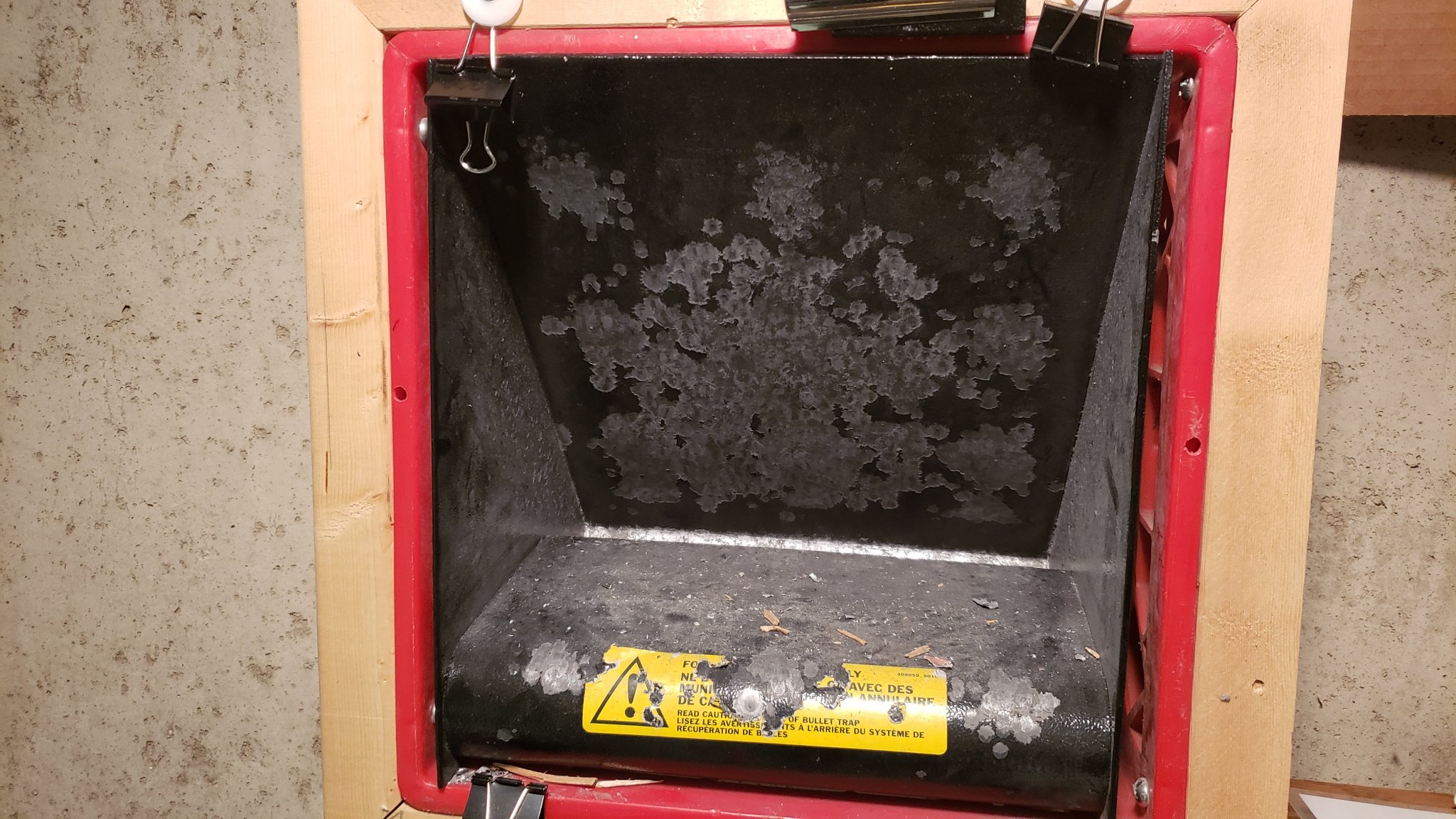

I wish there was a bullet trap you could have in your garage that was quite enough not to alert the neighbors, so you can do velocity testing on your rifle loads etc.

Ya I've got a setup in the corner of my dungeon, it's setup for air rifle and .22lr nothing high velocity. Perfect for these cold winter days. 20200215_075036.jpg
