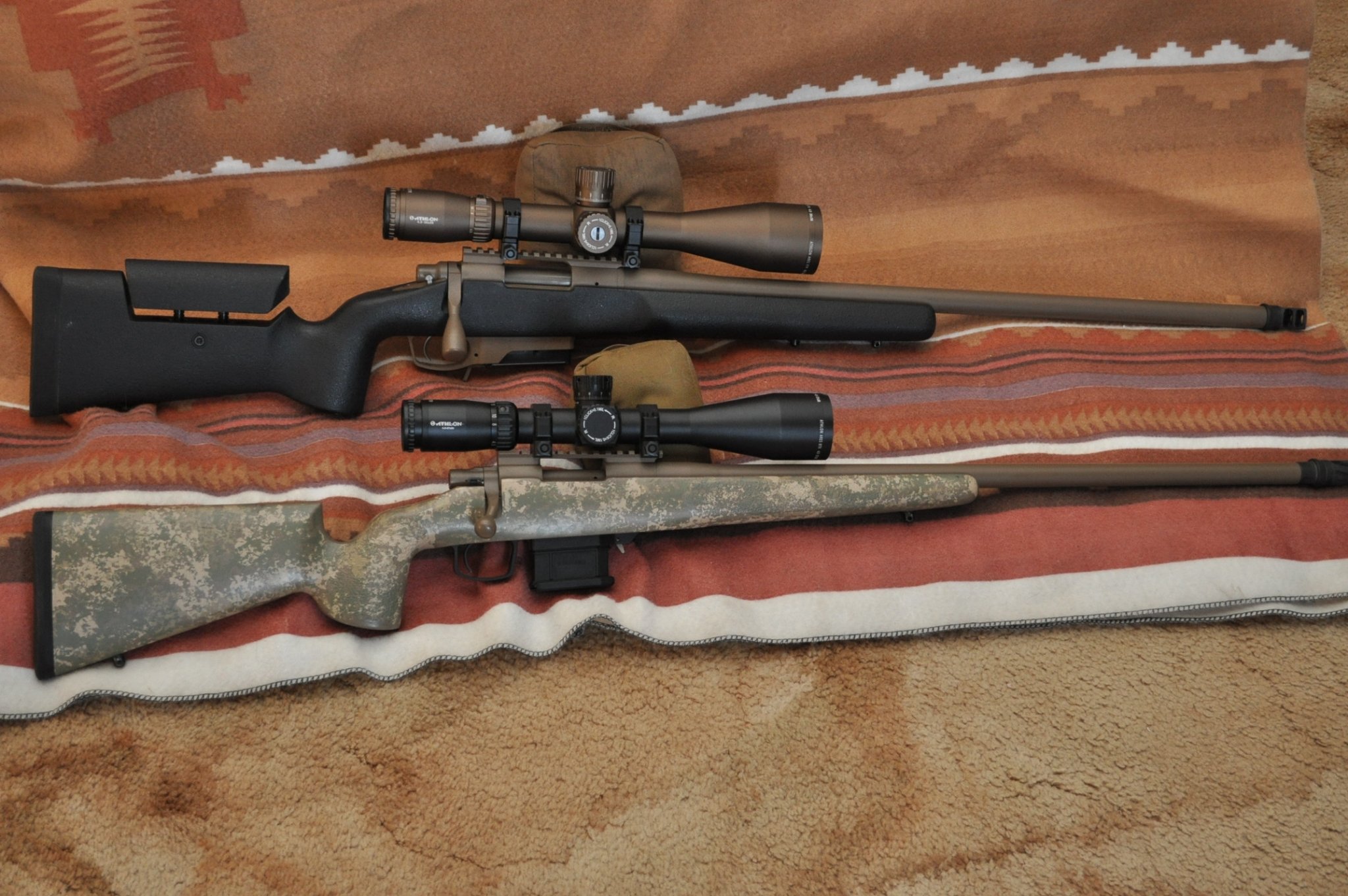

#37
I'm thinking Howa Mini with a good custom bbl in 6RAT. I did one for myself this past year, using a Bartlein light Palma contour 6mm/5R w/1-8tw, finished at 24". Don't think there's much velocity to be gained by going longer with a cartridge of this case capacity - tried a 28" Bartlein 1-7.8tw on a spacegun/match rifle upper in NRA XC high power matches several years ago, and haven't seen any significant drop in the velocity I'm getting out of the 24" bbl on the Mini relative to that 28" AR bbl. I'm using charge weights of around 28grs with most of the powders & bullets I've tried; you can get 2750fps, maybe 2800fps with 105s, which will get you to 1000yds easily enough. Good friend who built a 6RAT AR Match rifle very similar to mine is still shooting his occasionally, and has over 3k rounds through it - accuracy at 600yds is still very good.
My Howa Mini 6RAT is in a McM Game Scout stock with DIP aluminum DBM (using OEM plastic 5rd mags), with an EGW 20 MOA scope rail, and an Athlon Ares BTR 30mm 4.5-27x50 scope. It weighs a couple of ounces under 10lbs, and recoil is very mild. I put a TBAC flash suppressor/mount on it so it could be shot without the Ultra 7 suppressor and still not blast my eardrums to pieces as would be the case if shooting with a compact brake/mount w/o can.
Someone else mentioned a 7-08 - I built a 7-08 Improved 30* on a trued M700 w/PTG bolt, 26" Krieger 1-9tw in sendero contour, skim bedded in a B&C #2015 stock with PTG Stealth DBM, TriggerTech Primary, B-O 20 MOA steel scope base, Athlon Ares 34mm ETR 4.5-30x56 scope in TPS TSR rings, that weighs 13.75lbs. It's really pleasant to shoot with either an Ultra 7 or Ultra 9 TBAC can, running S168MKs at just under 2700fps with Hodgdon H100V, which has a flame temp just a bit cooler than N165. I know the old Sierra 168s aren't nearly as sexy as a Berger or JLK 168VLD, but they shoot great loaded to mag length, and I had a bunch of them, so... One of these days, I'll load some of the 168 VLDs to single load for shooting 1000yds, just out of curiosity. But this rifle probably weighs about as much as the OP's 6.5x47, which is one of the reasons it's so pleasant to shoot.
