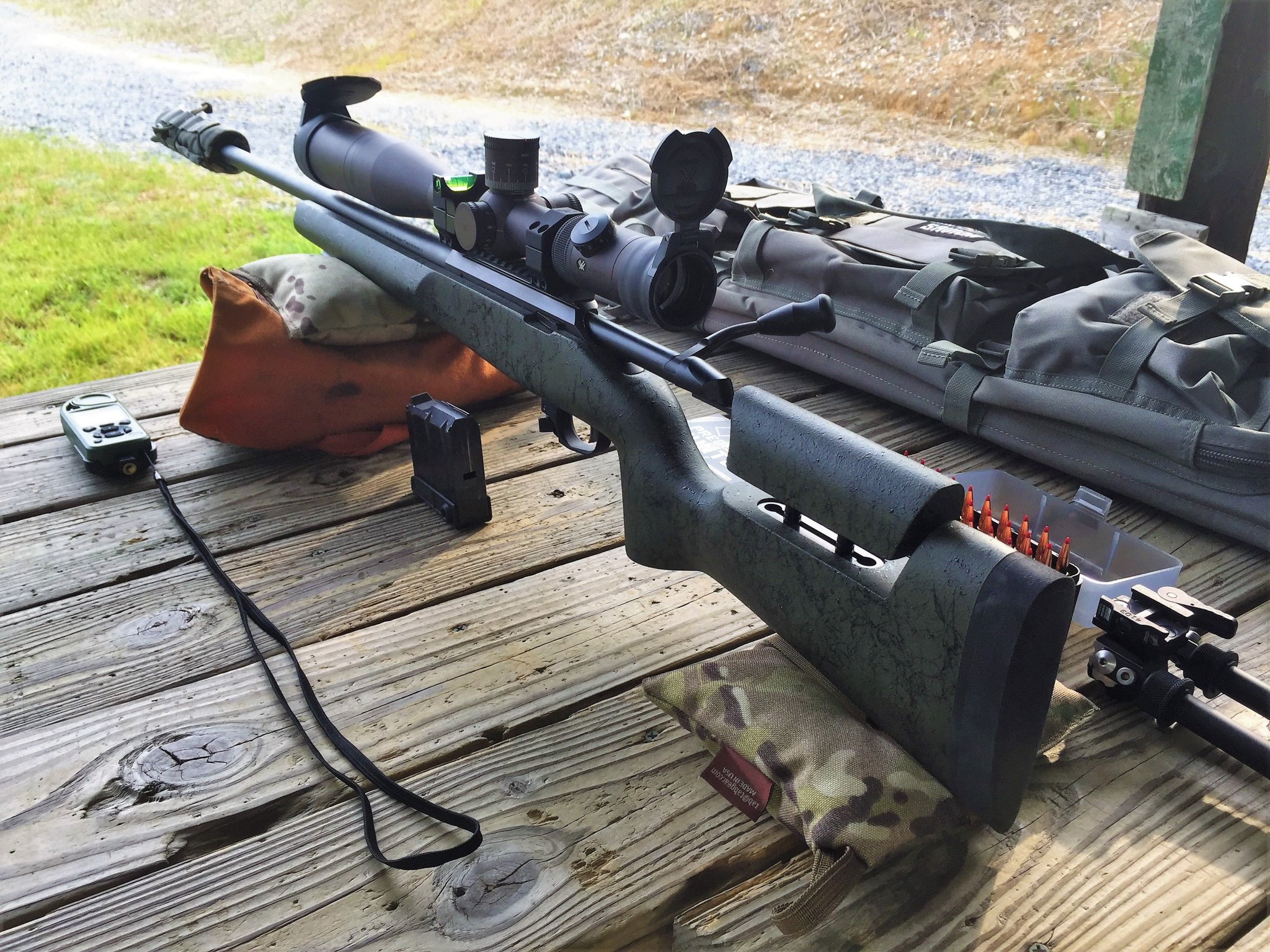

Tikka T3x CTR - 24" bbl, 6.5 Creedmoor. Vortex Razor HD 5-20x Mrad scope. Bell & Carlson Target/Competition Stock, Griffin Recce 7 Suppressor. Anarchy Outdoors bolt handle with EGW knob.
Hornady 147 gr. ELD-M over 42.0 H4350. Star-Line once-fired brass, primed with CCI #200 Large rifle Primers. This load has given me 2700 fps when brass was new. Need to chrono now with once-fired to see if there's any change.
3 things new with this setup:
1st time out with this stock (replaces the factory Tikka CTR stock).
Brass is now once-fired, rather than virgin.
Started using a mandrel for neck tension, rather than rely on my Redding FL sizer's expander ball.

Looks like you've pretty much got it dialed in👍
How are digging the ergonomics of the B&C style 6 stock, any complaints or mods planned ?
I have been looking at them for a while but havent handled one yet.

See, I really like the feel of these stocks. Call me old-fashioned (trust me - been called worse), but it just feels right for me. I got used to it with my Remington 700 which also has one. I looked long and hard at the KRG Bravo, but I just like the look and feel of the B&C. And - since I worked the bugs our of my CTR mags, I really like them too. I wouldn't mind if the B&C had a thumb-knob for the adjustable cheekrest clamp, instead of the Allen nut it comes with. I added one to the Remington, so I may add one here too. Not a huge deal, but that's really the only thing I'd change.

The forearm is a bit different, with the Style 6 being slightly rounded and the Style 2 being flat-bottomed. Other than that, they appear to be similar, with the exception of the adjustable cheekrest on the Style 6. I had one of the Style 3 Hook models on my Remington before the Style 6. All of them seem very rugged. Both of mine have absolutely no flex whatsoever. I haven't tried a Manners yet, so I can't comment.

Its Probably a combination of all these, but emphasis on the new stock.. My CTR stock has zero clearance around the barrel, I can change the POI just by how I load the bipod. My second Tikka to do this with the El Cheapo plastic stock. On my T3 Varmint .223 I went Lizzy Borden with a dremel in the barrel channel of the stock and all is well. My CTR is sitting in the safe patiently awaiting the UPS man to bring me a chassis. I do like that stock you have, looks nice and reminds me of the MCM A3-5, my favorite stock ever.
