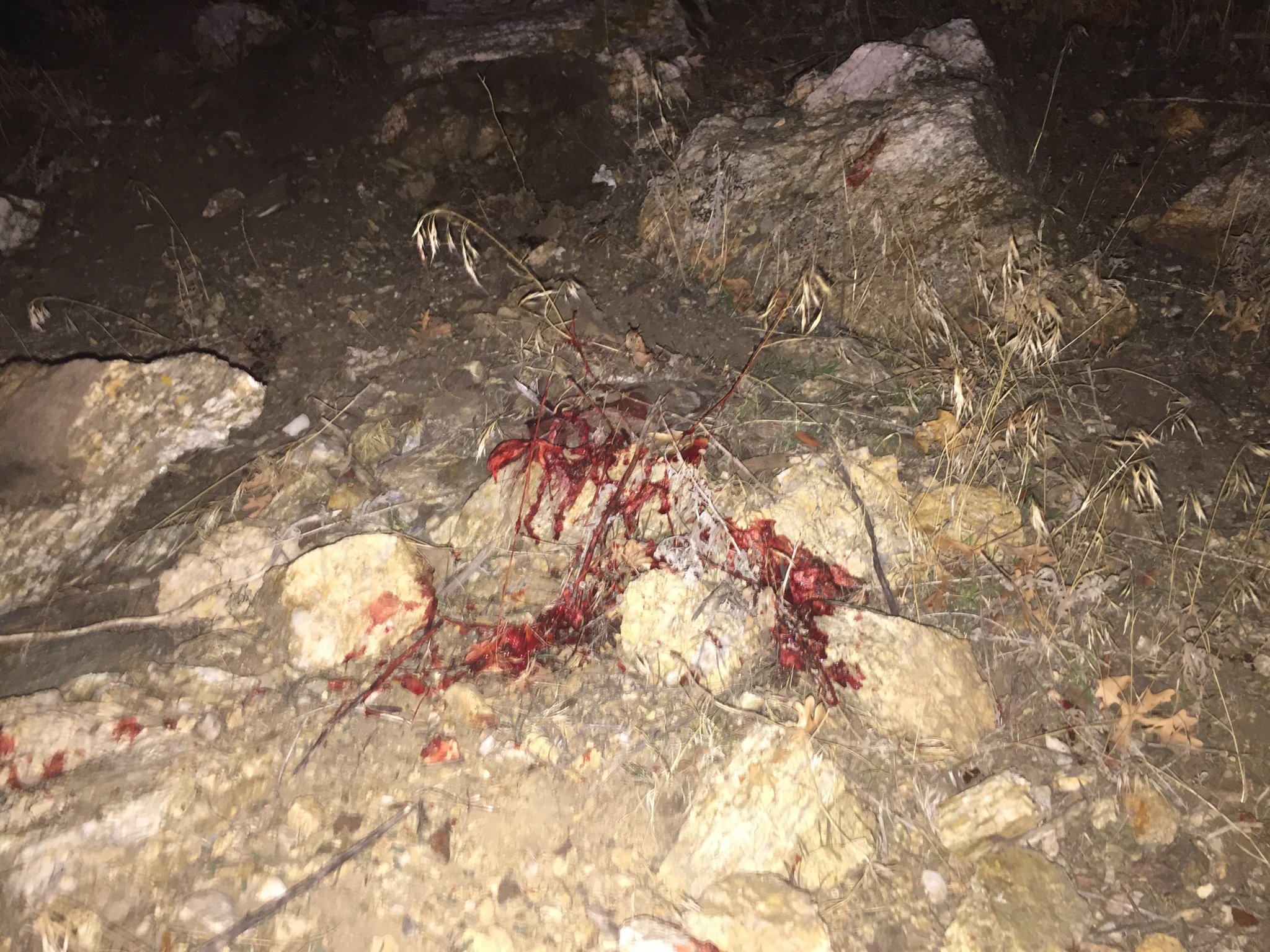

Scratch the first kill down for the 25 Creedmoor, a friends son shot his first deer at 610 yards this evening with my 25 Creedmoor whom I call “Quarter Lord”. Also a first was using the Blackjack bullets 131 grain Ace match bullet, seen left below next to three different 6.5 bullets (all 140’s).
The very flat shooting 25 Creedmoor needed only 9 minutes of elevation for a perfect coldbore hit at 610 yards.
Here you can see the offside exit wound:
If you would like to know more about the 25 Creedmoor, or this project, check it out here: Operation Quarter Lord
