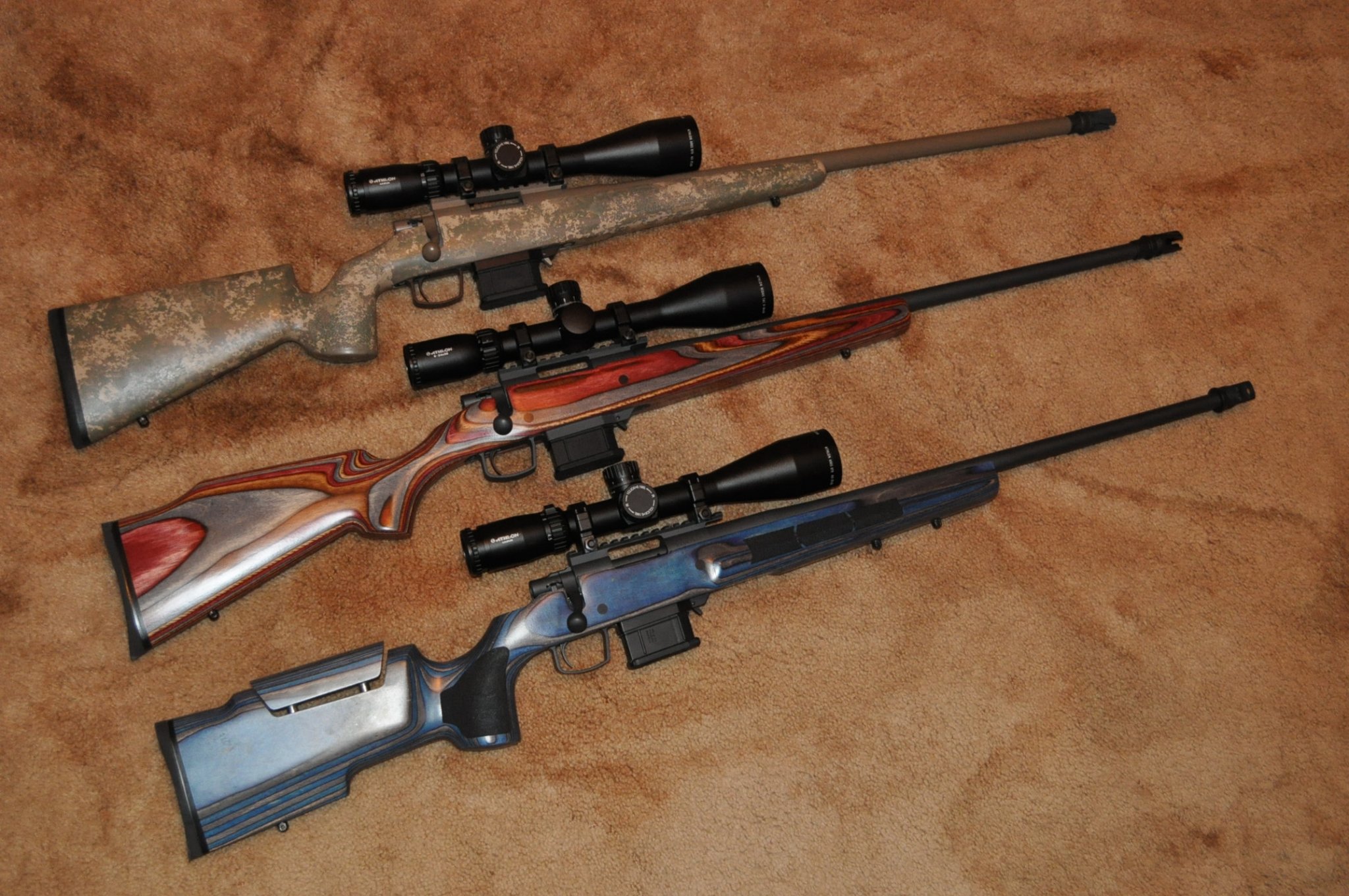

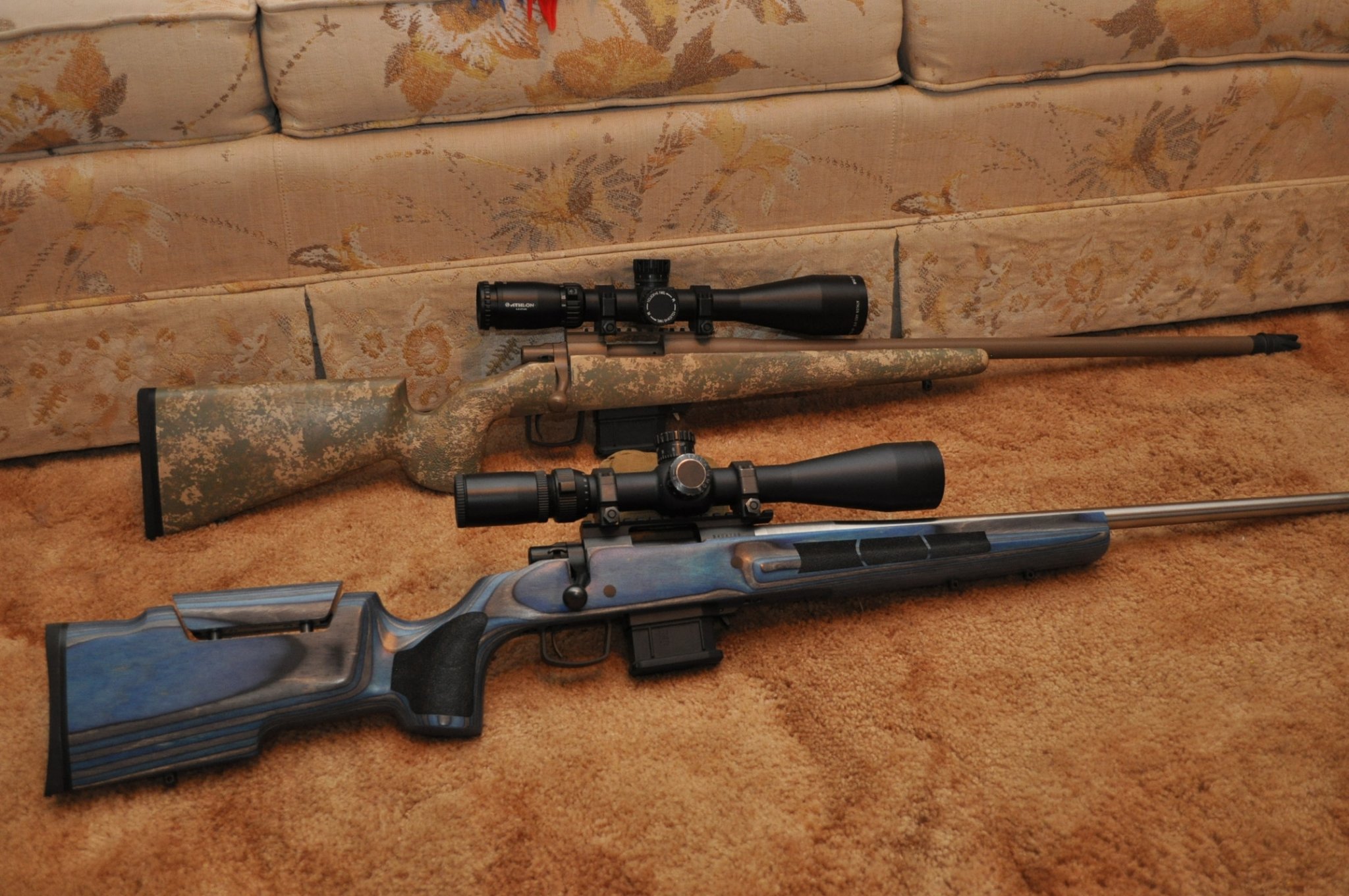

Here's a photo of my two Minis - 6 RAT in the Game Scout, 20 Tactical in the ProVarmint. The RAT has a 24" Bartlein in light Palma profile. The 20 Tactical is a 24" Bartlein #2B 1-9tw. I used DIP DBM on both, did the RAT in McM tan, and have done the 20 Tac in sniper gray since the photo was taken.

The 20 Tac in the ProVarmint weighs 10.75lbs, the 6 RAT in the Game Scout is 10lbs even. Not a good comparison on the actual stock weights, as the RAT's bbl in considerably heavier than that of the 20 Tac. They both have Ares BTR scopes in TPS TSR aluminum rings now, so the weight difference is all due to bbl & stock weights. I'd guess the light Palma on the RAT weighs 1/2lb more than the #2B on the 20 TAC, which would mean that the ProVarmint stock weighs at least a pound more than the Game Scout.
I've got two more Mini bbl'd actions in 6.5 G & 7.62x39. The 22 Grendel reamer arrived in the mail a week or so ago. Still waiting on a go gauge for it, and the Krieger #4 sporter blank is probably a few months out. I've considered keeping the remaining 6.5 G as is, and using the 7.62x39 for the 22 Grendel, but that 6.5 is a light sporter version, and I'd prefer to have a slightly heavier bbl for it if it's going to remain a 6.5 G. However, I do have a Bartlein 6.5 bbl in Rem Magnum sporter contour. If I do that, I'd have to buy another reamer & go gauge...but it would probably be worth it.

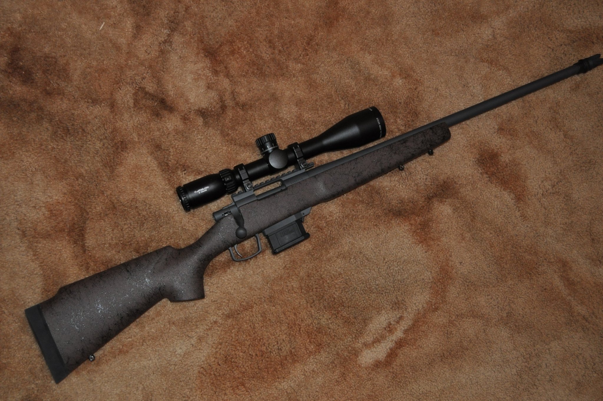

I went with a Boyd's Pro Varmint for one of my Howa mini actions; I had to open up the barrel channel (which is fair, considering that I had it fitted with a Heavy Palma) and lightly touch up the rear tang area. A little JB Weld for bedding, and Bob's your uncle.
I'm pretty happy with the way it turned out:

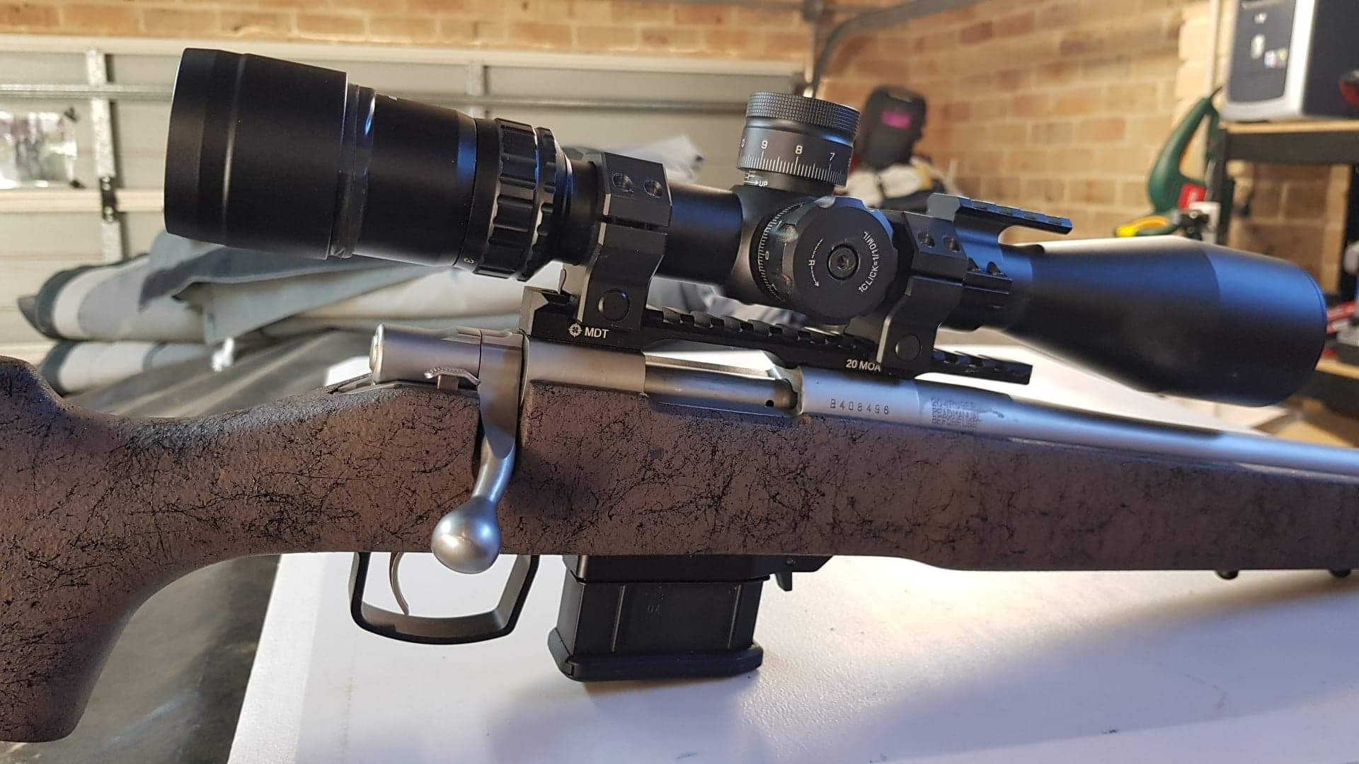

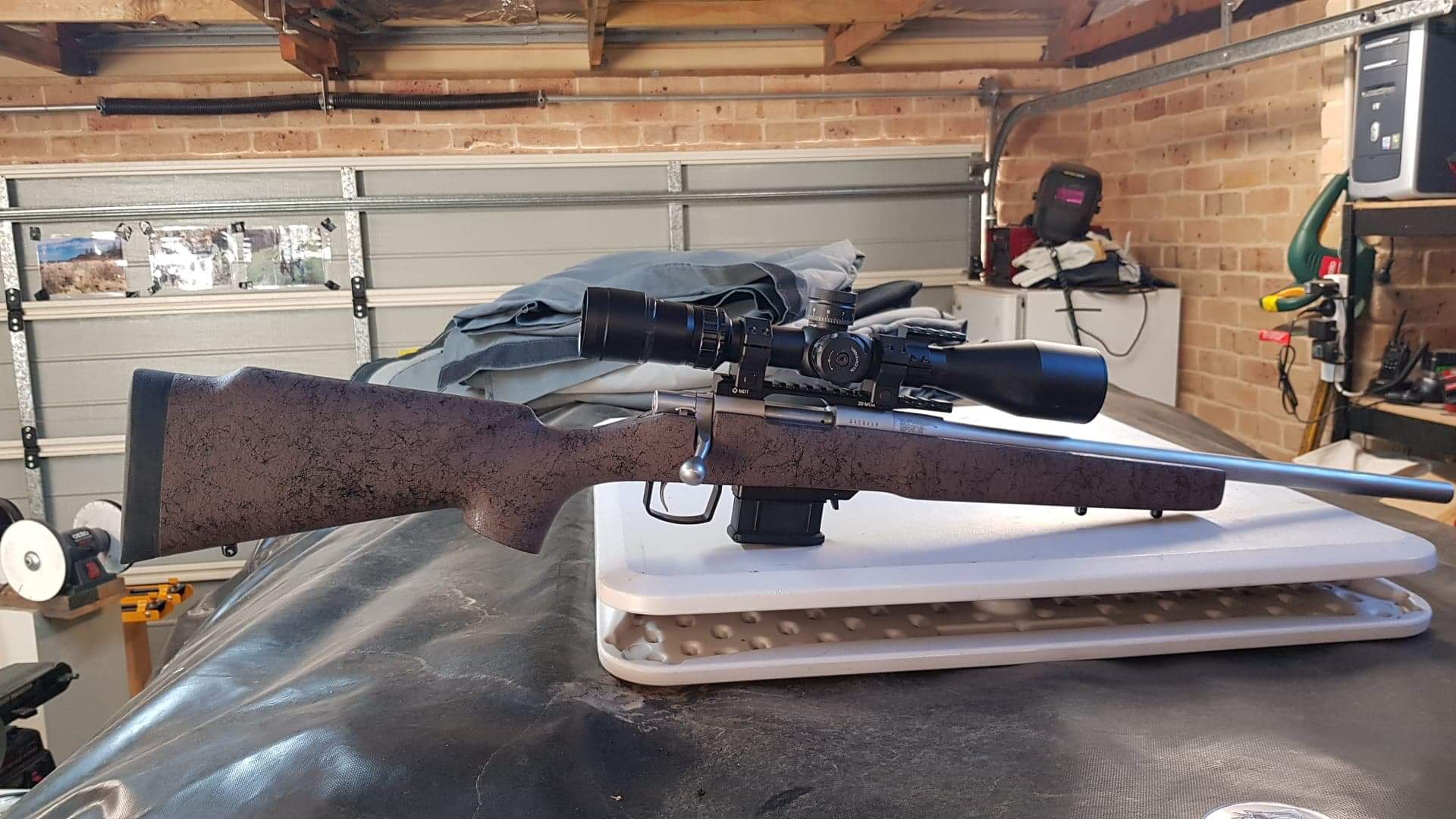

This is my .204 in the B&C stock with DIP Inc bottom metal. I haven't got around to shooting it yet but it feels a whole lot stiffer than the standard stock. The forend is a nice width, similar to my Target/Competition B&C.received_904486519909232.jpegreceived_335900880628938.jpeg

The last Mini that I re-barreled went into a B&C stock just like the one above. I put a Bartlein 6.5mm/1-8tw bbl in Rem mag sporter contour on mine, chambered it with a PTG 6.5 Grendel reamer, and finished at 24". I used the same DIP DBM, skim bedded it into the B&C stock, and CeraKoted the bbl'd action/scope rail/DBM in sniper gray. Mine's the same brown color as Wannabustbunnies' stock; I like the contrast & combination of B&C's brown stock and sniper gray, but had considered going with patriot brown, and now wonder how that combination would've looked.
Whatever - I like the shape of the B&C #1003 stock. I like the tight radius of the pistol grip, the comb height is just right to get my head up for near-perfect alignment with an Athlon Midas TAC 6-24x50 scope in TPS TSR low rings on an EGW 20 MOA scope rail, and the forearm is just wide enough for the flat bottom to be steady on a front rest, provide a solid base for a Harris bipod, yet is still narrow enough to be comfortable in offhand. My all-time favorite stock for the Mini is a McMillan Game Scout, which I have on the first Mini I built, in 6RAT with a Bartlein light Palma bbl finished at 24". I've also got Mini rifles in Boyds ProVarmint & Prairie Hunter stocks. The ProVarmint has an adjustable cheekpiece; it's very comfortable in prone, while the Prairie Hunter isn't, and has a much more open pistol grip radius. The Hunter is comfortable for standing offhand, but I've shot with McMillan A5 & Manners T4A stocks for so many years that I much prefer a near-vertical pistol grip. Stock shape/proportions are a very personal thing, so what really trips my trigger may seem downright uncomfortable to someone else. I do appreciate being able to call B&C and have a stock in a couple of days - as opposed to waiting a year to get the McMillan Game Scout, which I guess was the result of some confusion in the order. 2nd photo, from the top: 6RAT in Game Scout, 22 Grendel in Boyds Prairie Hunter, 20 Tactial in Boyds ProVarmint. All have DIP DBM.
