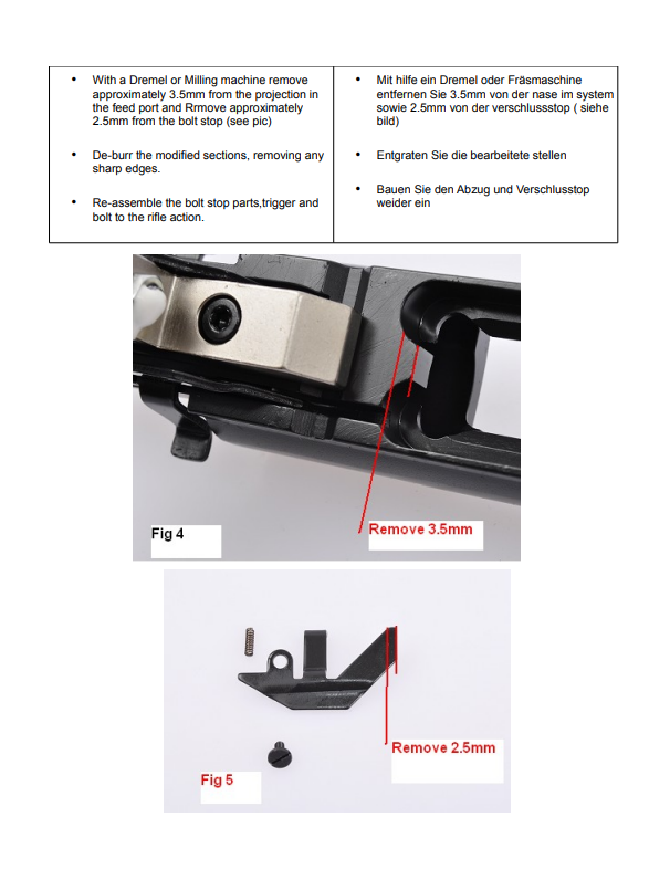

Look at figures 4 and 5 on page 4: http://www.webshop.roedale.de/media/content/RCS II H1500 user manual.pdf
While this is a different stock/chassis, what you have to do to make it work is what you need to do to make the PTG bottom metal work.
The tab on the bottom of the receiver needs to be milled off completely but go easy on the bolt stop because you can remove too much. Just take off enough so the bolt face clears the back of the case by maybe a 1/16th.
Excellent guide, screen capped here for ease of view

THanks for all the help everyone. Was super easy to get going. I removed a bit of the bolt stop (which doesn't look exactly like the above picture, but is similar) and cut out part of the magazine. Super easy with a dremel, and now we're in business. Already loving having a real magazine for this gun.

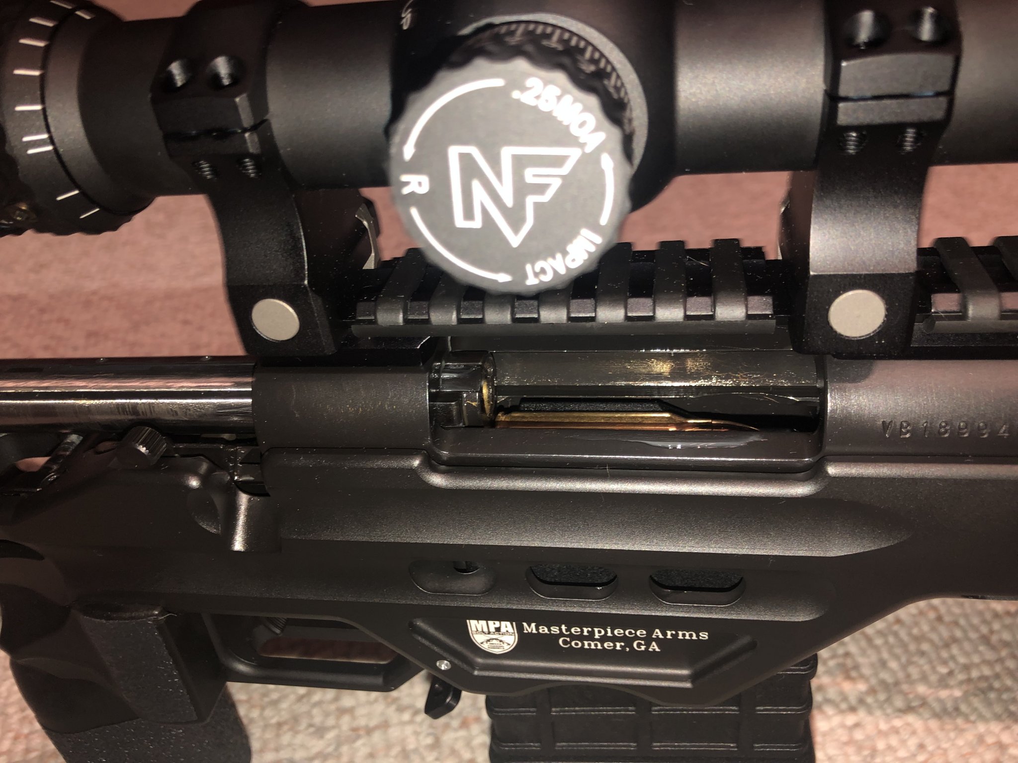

Try MDT .223 AICS mags. They work fantastic in my Weatherby Vanguard, in MPA chassis. $40 and readily available. Excellent quality to.
