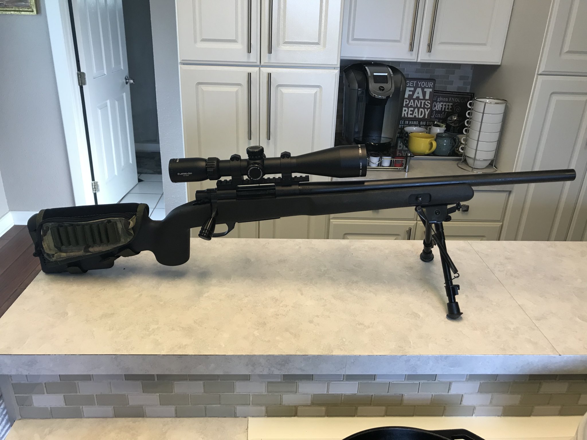

Back from the range.
Howa 1500 6.5 CM 24 inch heavy barrel. MDT ESS chassis.
Half moa out of the box. New barrel. No load work. Worn out brass. 110 thou off the lands in standard magazines. New mags on order.
I'm pleased.

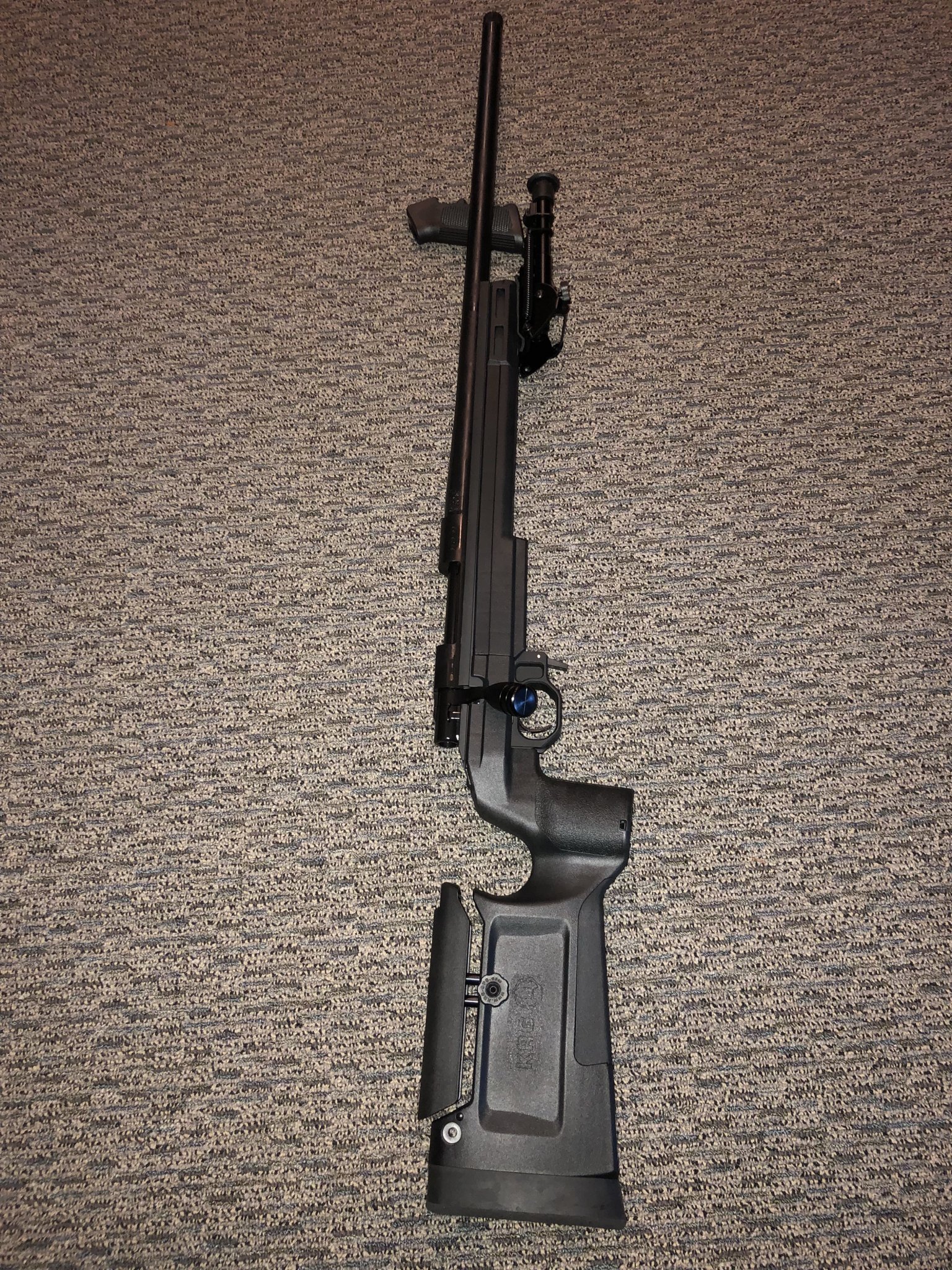

I just finished my 300 win mag build. 26 in threaded heavy barrel. I get lucky and received one with a threaded bolt handle. I have the brownells mdt chassis and the mdt skeleton carbine stock. I haven't started reloading for it yet but it was just under 1 inch at 100 yards for 5 shots and hit out to 870 yards on my first range trip. Wade stuteville recommended I contact Matthew Stewart at Stewart rifle for any smithing relating to howas. The ultimate plan is to have the action partially trued by Matt but leaving the threads untouched so I can run prefits. Overall I'm extremely pleased. I am hoping to shrink the groups a bit with handloads though.

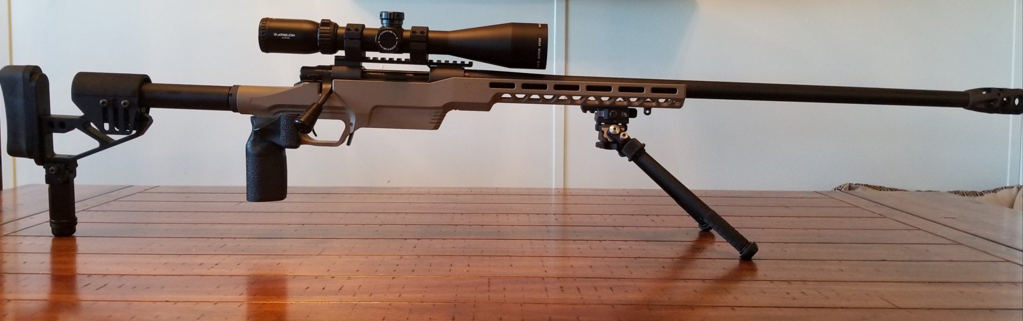

Came home to my Bravo waiting for me after a three month underway, went ahead and threw the action into the chassis. Already love the way it looks. Can't wait to get it in there for real and get the scope mounted, and take it out to the range.

Good looking setup! I have the 24" threaded barreled action at home, and the FDE KRG Bravo is on a FedEx truck somewhere around Chicago on its way to Virginia.
I have a 25 MOA rail on the way - just need to decide on what scope I can afford.

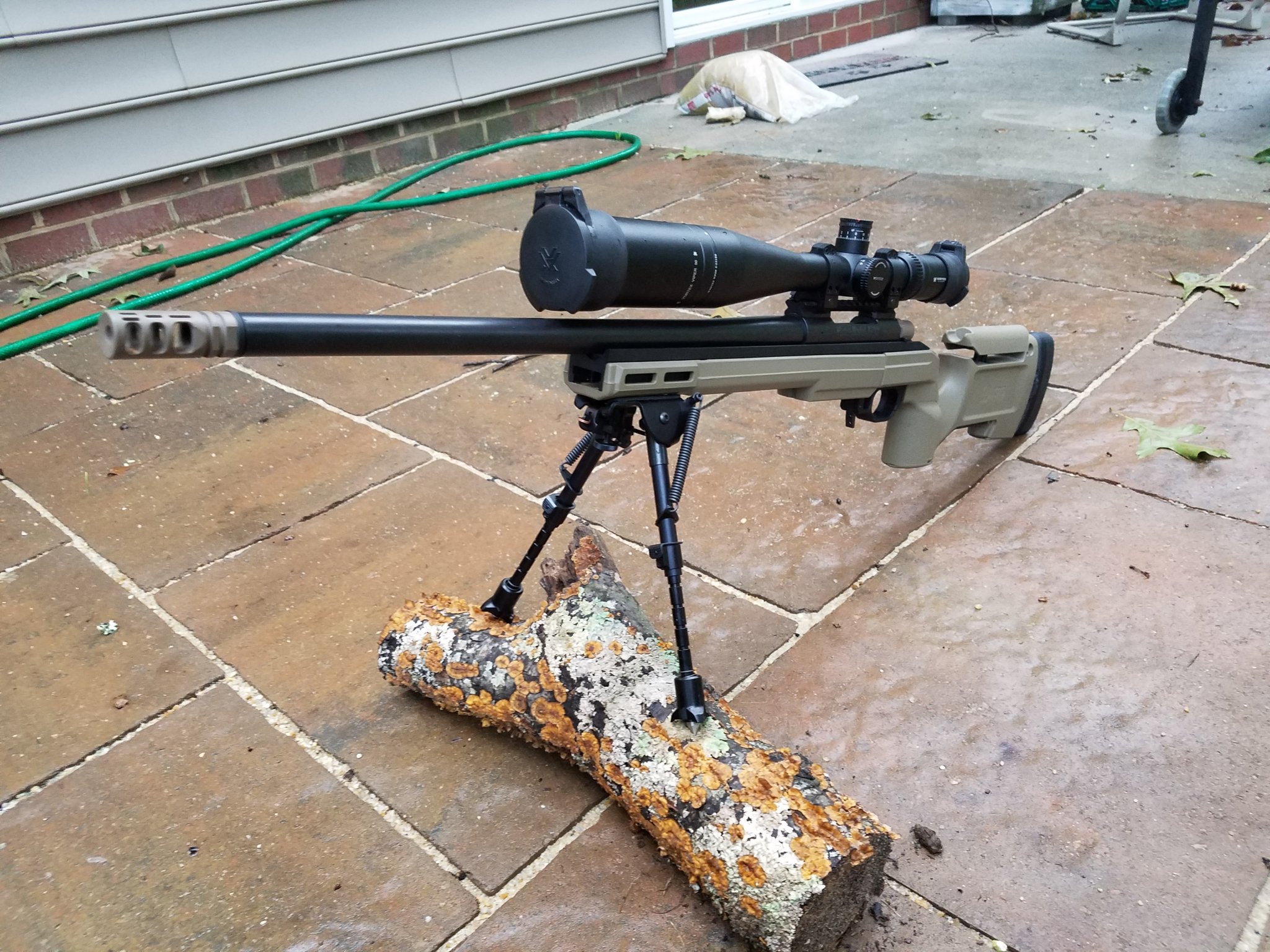

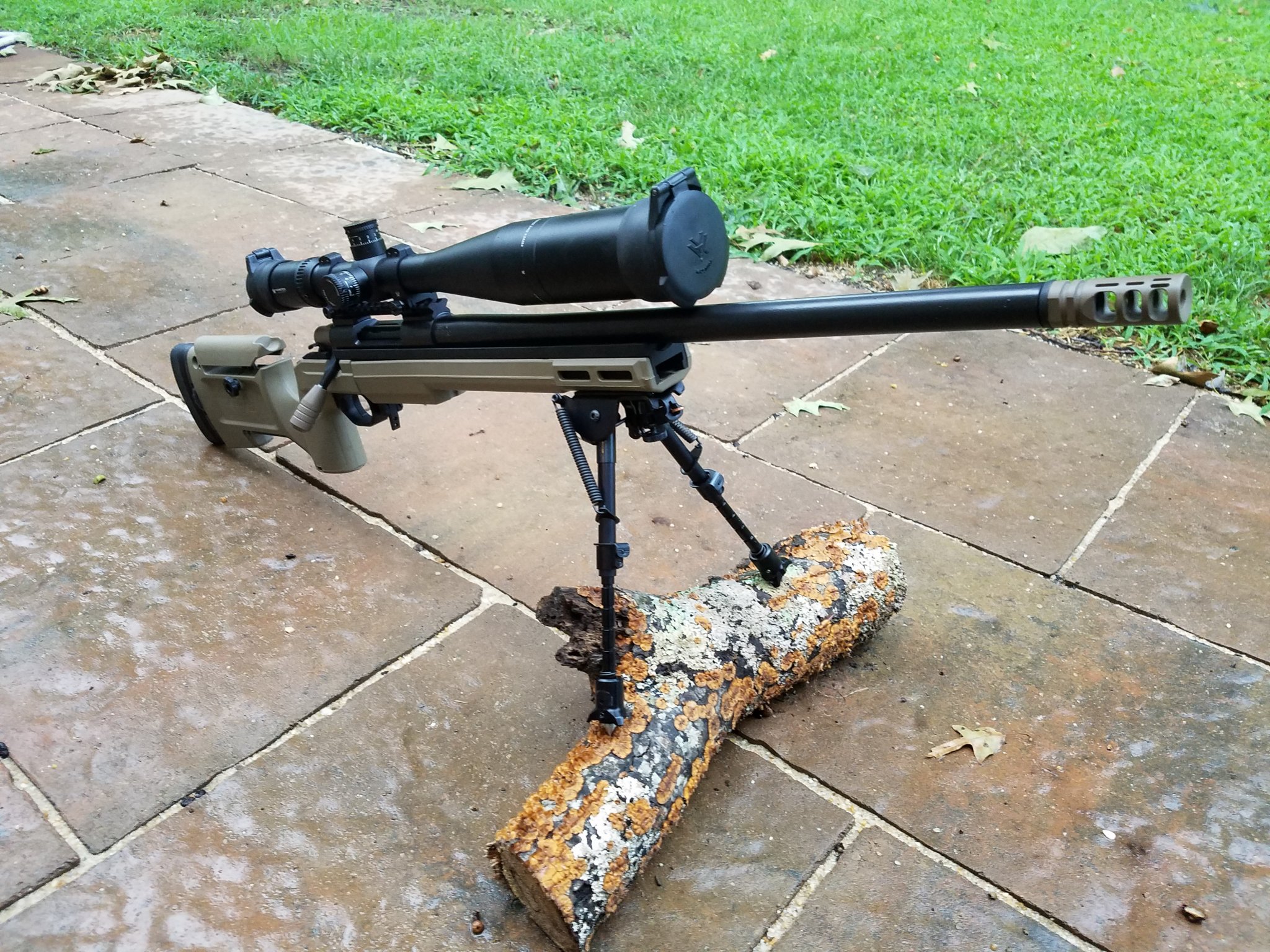

I put a 20 MOA Nightforce base on it and put a Vortex Viper HS-T 6-24x50 I purchased with my Mil discount. Took it out to the range to get it on paper and see if I could get any decent groups to print. Best three round group I shot using Hornady 168 gr BTHP Match ammo. I have a few other flavors to try later on. After the range session, I took it home and disassembled it to get the barrel threaded, new knob for the bolt, and then get everything Cerakoted. I'm happy that I was able to get these results with a fairly inexpensive build, hopefully I can do better with it once I get it back.
Coincidentally, I'm also in VA.
Cheers,
Brody

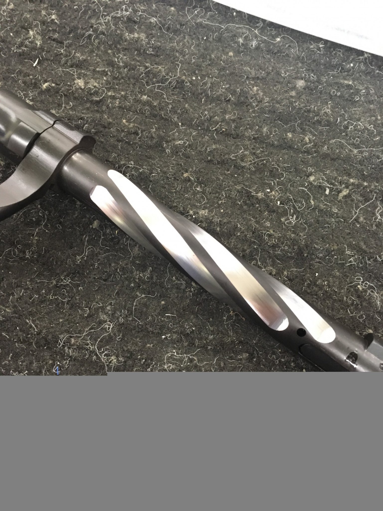

My barreled action came back from my Gunsmith today, had the barrel and bolt handle threaded. Put a VG6 308 brake and an oversized knurled knob on the bolt. Cerakoted the barrel and action in Black Graphite. The brake, bolt knob and bolt hood were Cerakoted FDE. Put in in the KRG Bravo chassis with my Harris bipod that has Hawk Hill spikes installed. Topped it with a Nightforce standard duty 20 MOA rail, and a Vortex Viper HS-T 6-24x50 sitting in Vortex Pro low height rings.
I'm pretty ecstatic how the Cerakote turned out. Can't wait to take it to the range later this week and check on how it does.
