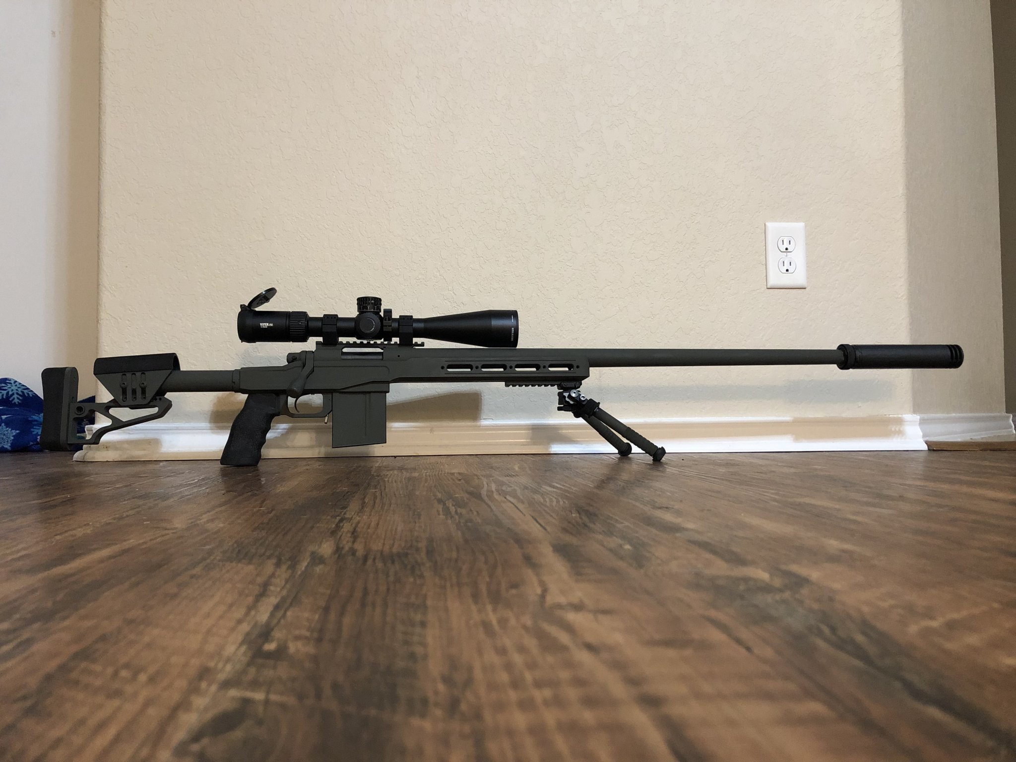

I have been shooting my 26" barrel with a 9" can on it for over a year now. Once I got over how long it seemed, I am quite comfortable with it in a match situation. My rifle altogether is a pig though, so not a useful comparison for hunting.
