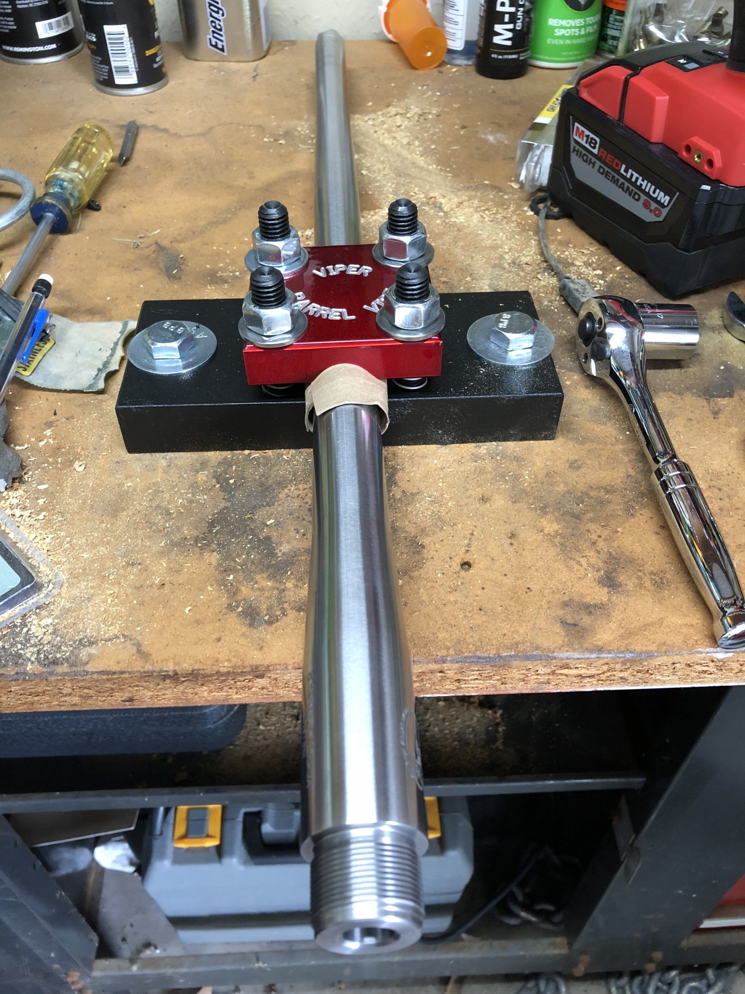

About to do my first barrel install with a viper barrel vise. Any risk of functional barrel damage by torquing the vise down on the barrel too hard? Have a half inch impact that will quick work of it if no concerns.

Its an aluminum vice, you’re really only going to get so much clamp from it before adding more torque to the nuts looses effectiveness. I shield the barrel by wrapping it in a large post-it note(any paper will do), and tighten with a box wrench. Maybe 20 ft/lbs on the nuts will do fine. Do not use an impact.

Thanks guys. Don’t have any anti-seize on hand so looks like I’m headed to the store when the boy wakes up. Any suggestion on type?

I torque the bolts on my Viper vise to about 30 ft/lbs, and wrap the barrel in some thin cardboard. Works fine for barrel torque up to around 100 ft/lb, though I normally use 60ft/lb for my barrels.
I use copper based anti-seize from the auto parts store for barrel threads, don't have any on the studs of the viper vise and they've been fine.

I heard that the viper isnt enough to remove factory barrel, I havent found that to be the case though (in my sample of 1). I tightened the 4 nuts with a box end wrench until it got all the way solid but no more, not sure I would trust an impact to hit that point before it starts going past what the threads could bear.
I used a toilet paper tube, Ive also used a business card in between the barrel and vice to avoid marring it.
I could tell that the nss action wrench didnt afford me nearly enough leverage so a good breaker bar made quick work of it. I barely even had to push with the breaker bar. It never once seemed like the viper wasnt up to the task .
Ive been very pleased with it.

I wrap my barrels in hockey tape before I put it in my Viper vice. This accomplishes two things:
1. It provides extra grip to prevent the barrel from turning in the vice.
2. Protects the barrel.
I tighten the vice as tight as I can with a small rachet wrench and socket. I also apply copper anti-seize to the barrel tennon threads.
