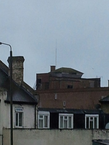

G'day, Sorry for not replying sooner, The key to getting constant returns with the ConX is stability, I had the same troubles as you and I found that my breathing and heartbeat was the cause, The Target/Bulls eye mode it the correct one to use but I feel happier using the Tree/Brush Mode, The beam on the ConX should be slap ang in the middle of the Aiming Circle, I tested mine by Ranging a CB Ariel at 229yds hand held and sure enough it is in the middle, Other folks have said that they have more success using the ranging mode which is where you do not have any Icon on the screen.
The ConX has quite a small vertical Beam so getting it on target is important, As I said I ranged that CB Ariel which was only 1/4" wide at 229yds away and I ranged it where the tip of the Ariel was right on the top centre edge of the Aiming Circle and it looked like a thick White Hair through the rangefinder where the Aiming Circle lines looked about 3 times thicker than the Ariel, You can just make it out in this picture, Where it is bolted to the Top of that 1" Pole, sorry about the picture but that Ariel really is hard to see but it stands about 4 feet high from the top of the pole.
Just try and control your breathing or movement when Ranging a target, It took me about 3 days to a week solid to get use to it after using a different type of LRF, you need to Aim it like you would your Rifle as in being very steady,
hope that helps, give us a call and let us know how you get on because It is a great LRF when you get to understand it and how it works.

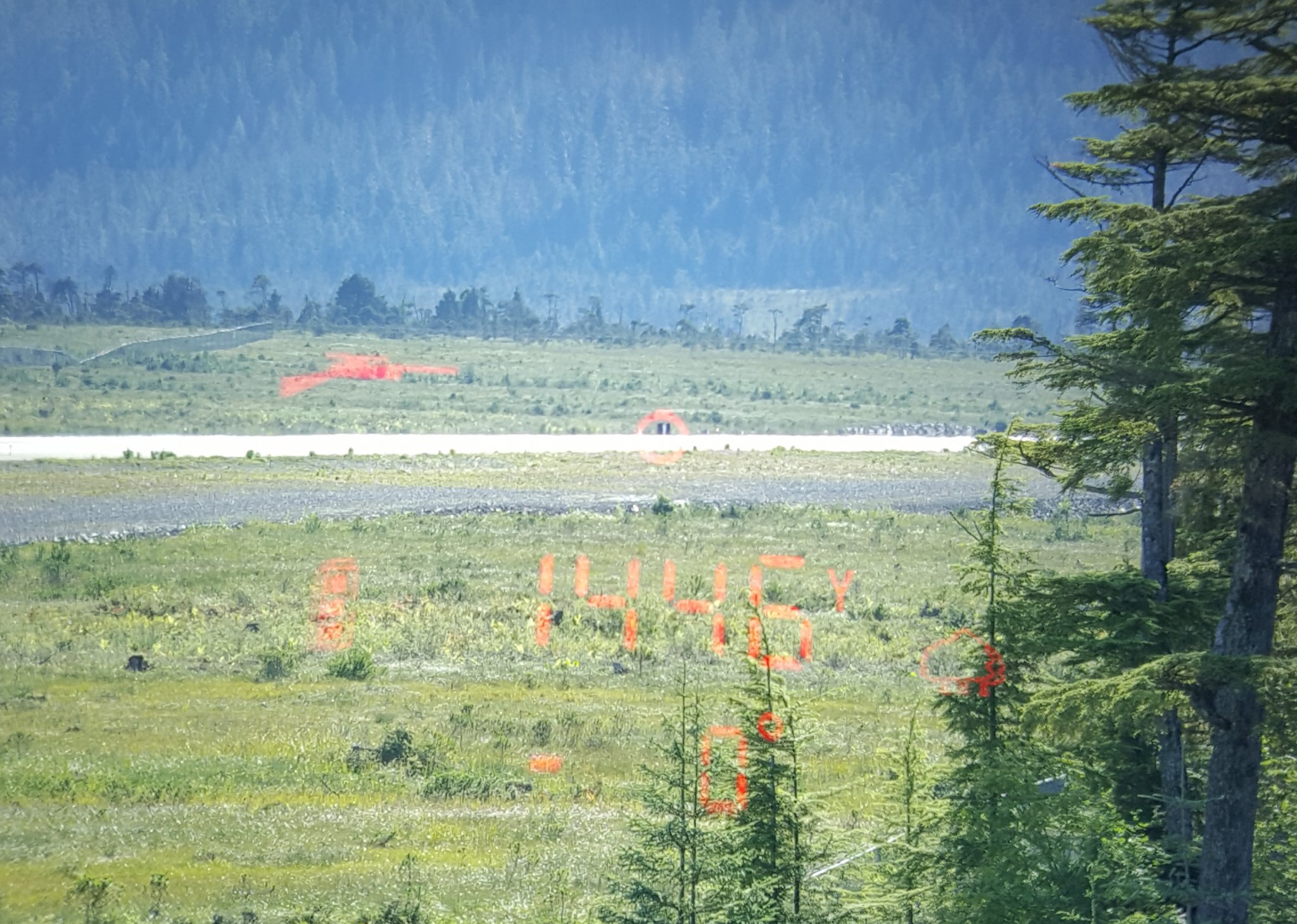

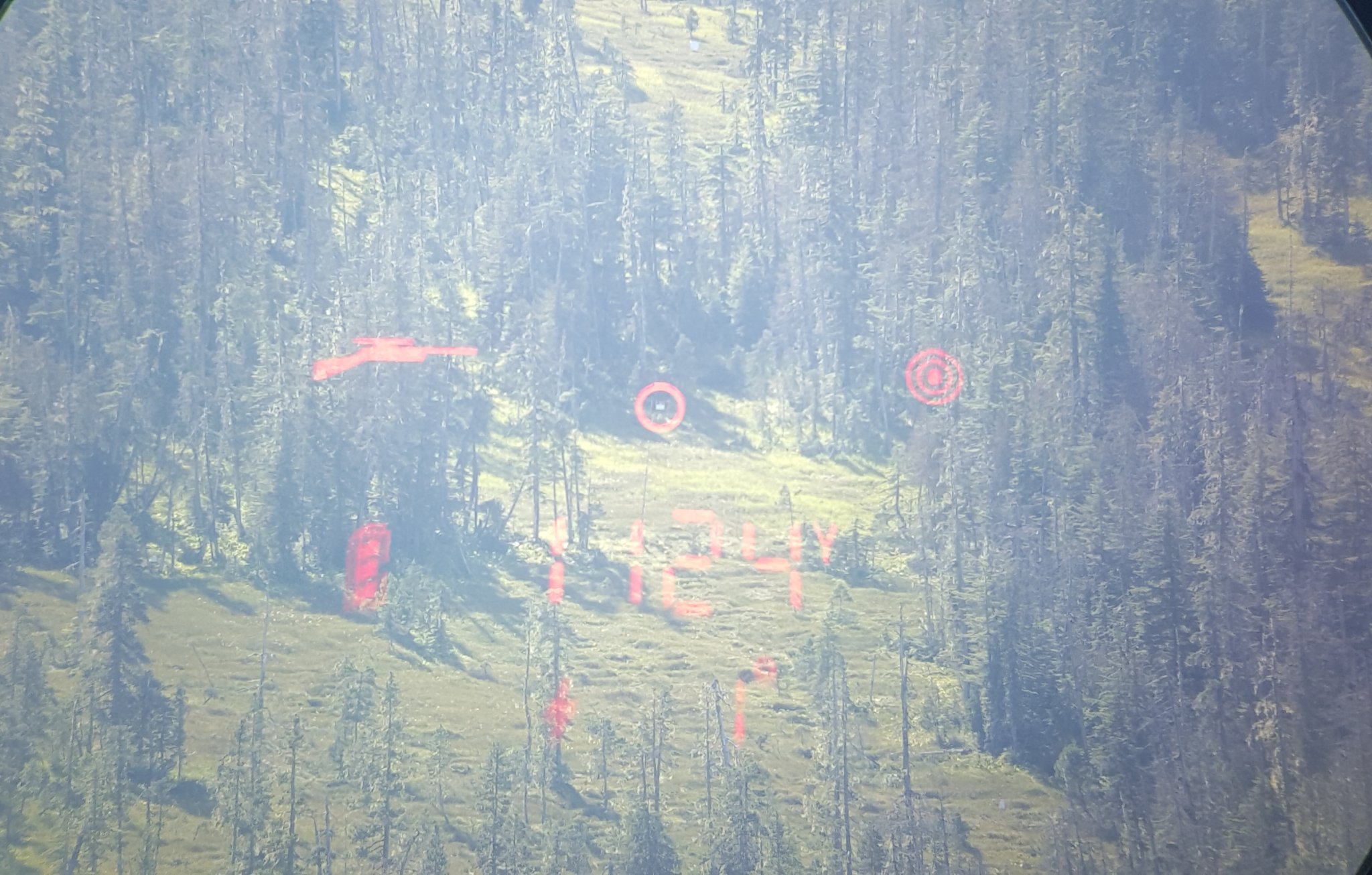

Took me a bit to figure this out as I was used to the speed of the sig kilo 2k. At longer distances it's common to have to hold the button down for up to 3-4 sec to get a reading, which of course does not help at all with stability. When paired with a tripod or very solid support with a long button press I can usually get a good return on steel "targets" out to 1300yds overcast, 1000yds in full sun.
12"x24" steel @ 1119-1125yds verified by gps, radius, sig, leica.
Farthest return I read although it is larger than what I would call a target. Approx 5'x5' runway indicator sign.

Cool, well that last Photo is almost equal to a 1 mil X 1 mil target at that range of 1446yds, and the first is equal to a 1/4 mil X a 1/2 mil at 1124yds So that is pretty impressive, Well done,
Thanks for posting.
john.
