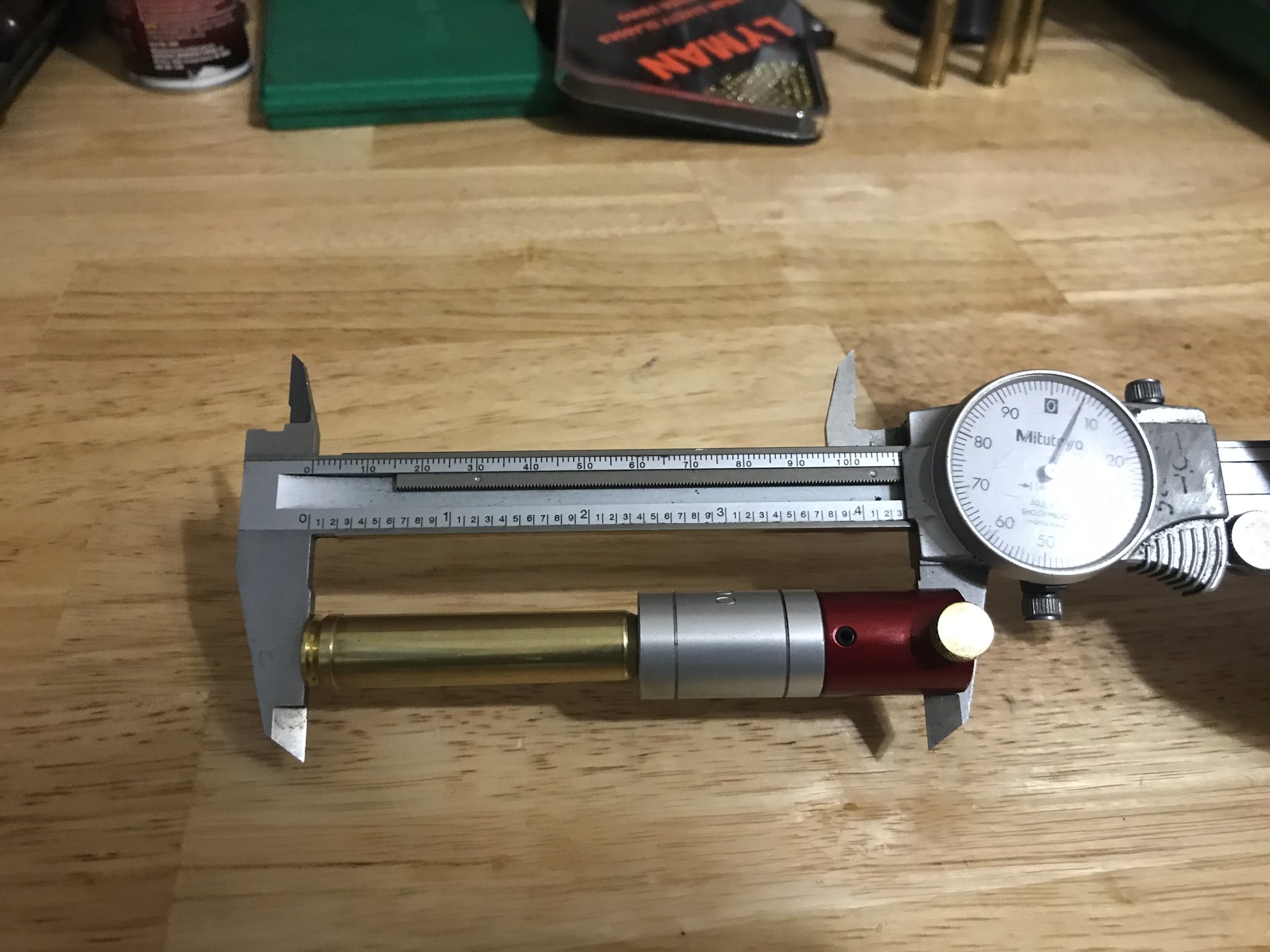

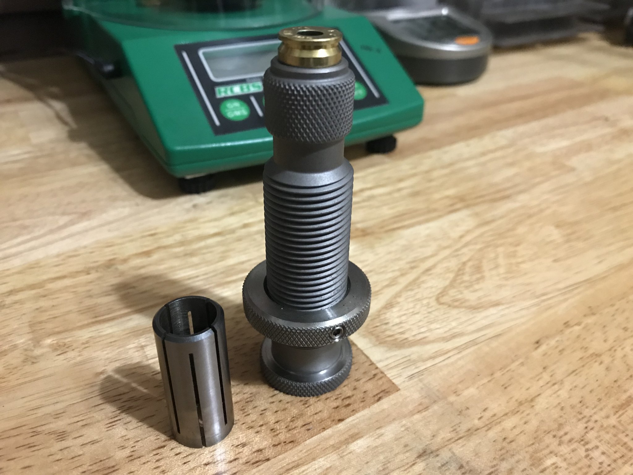

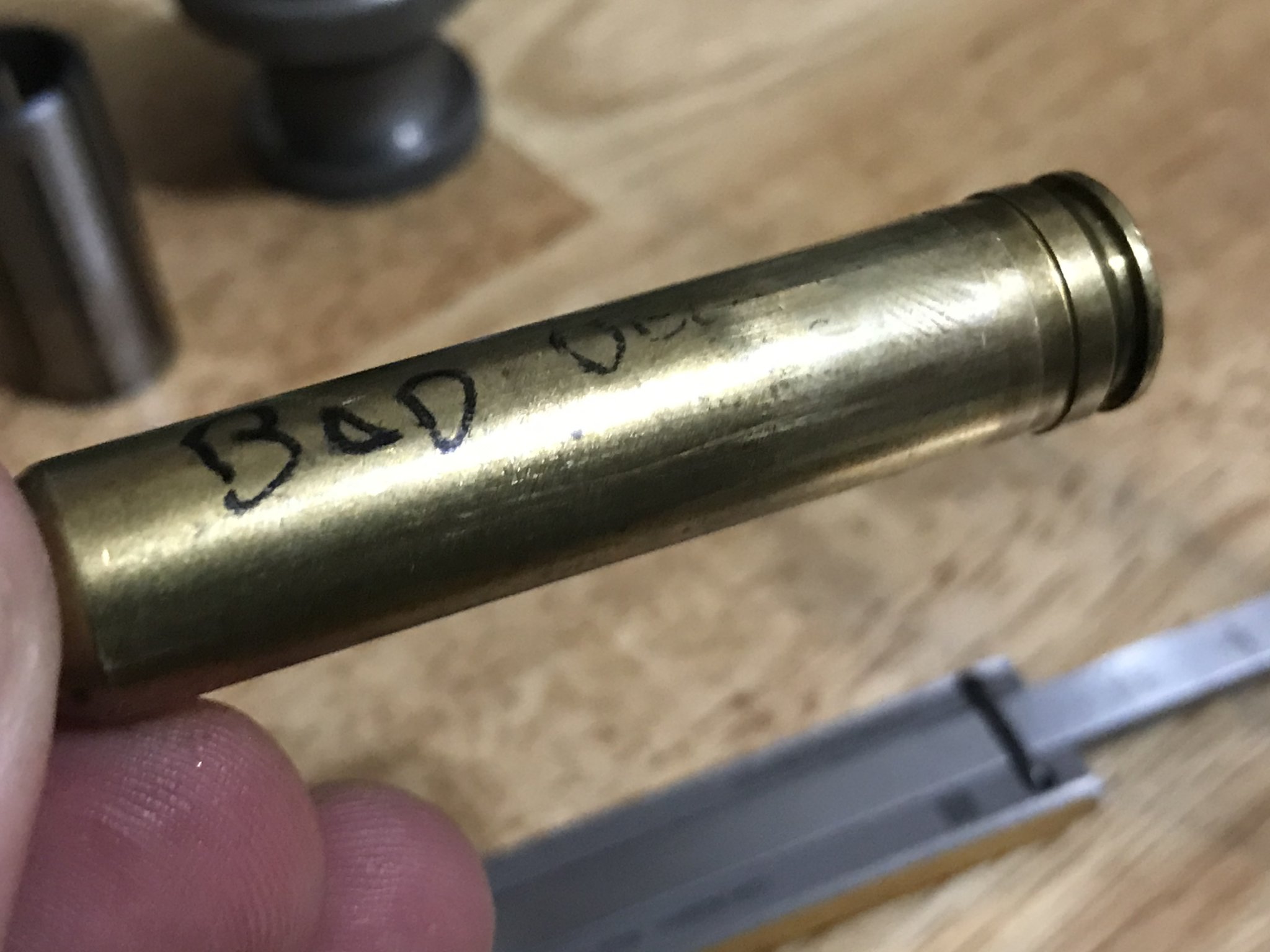

I am just starting to try to squeeze as much accuracy out of my 7mm rem mag as I possibly can. So far I have been testing loads with new brass (Norma and Nosler) and I have found a couple of recipes that I am getting great groups with. But now it is time to size my once fired brass and I am trying to narrow down the best sizing methods. I have both the Redding competition FL die and the Redding competition neck sizing die for it, but I keep reading about the Larry Willis collet dies. Do they FL size the case? I keep reading that if I want to get maximum accuracy I want to just neck size the brass so that I am headspacing off the shoulder instead of the belt. (Please excuse me for sounding like a nube) So should I use my neck sizing die until I have chambering issues then FL size them? Or should I just order the Collet dies and stick with that?
I use Redding FL sizing die (and match seating die) for my Mk13. 99% of the time they are sufficient provided the die is set up correctly relative to your target headspace. I shoot for a cartridge - chamber headspace clearance of .002” (.003” max). I headspace based off the shoulder like any other cartridge.
I also have the Willis belt sizing die. I occasionally use it to resize the webbing just above the belt but its primary utility for me is it’s use as a “case body” gauge. After I run a case through the sizing die and measure casehead-shoulder with my Hornady head space comparator tool, I’ll drop the sized case into the top of the Willis die to see if it falls freely into the die body up to the belt. If it does, the case goes on to be primed.
Willis die with collet (being used as a gauge in this pic)
Hornady head space comparator tool with D400 bushing (gray)
I think the Willis die more of a nice to have vs mandatory unless you have a large number of fired cases with excessive diameter (bloating) just above the belt, preventing the brass from being smoothly chambered after full length sizing. Then perhaps it’s worth it to try and save those cases. It’s also not 100% effective as some cases are just too far gone in the webbing.
Example of bloated webbing above belt
Man I appreciate you taking the time to reply with pictures. That is extremely helpful. I will probably order the willis die just to have it and use the same way that you do.
