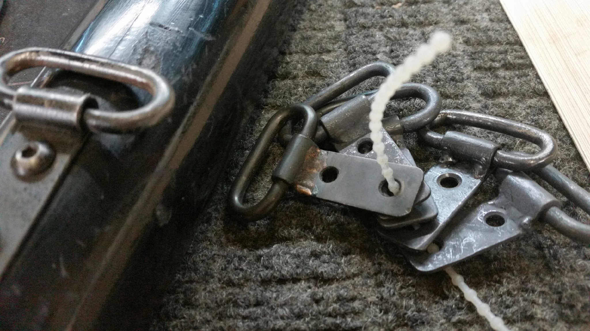

Got a question from a gentleman that is former USMC and does great things for the shooting community.
He asked me a question about Desert Storm M25s.....
Do you know what swivels were most commonly used on the M25 builds
during Desert Shield/Desert Storm timeline?
Anyone got an answer I can pass on to him?

I have a gun being built on a Pre-1987 McMillan stock. I'll see if I can get some pictures for you.

"Issue M14 with weld modification. In standard location. Weld tin strip that holds swivel. Tight sling pulls them apart."
I would bet that was more or less standard for the M25s as well. They were basically M14NMs with scopes. Some had the special block and some didn't.

The two co-inventor's of the XM25 circa late 1980s are generally to be considered, SOTIC instructor Tom Kapp (RIP) , and BPT owner Mitch Mateiko. There was 'flexibility' regarding configuration details on the XM25 and M25 rifles, but here's what I know:
Here's Mitch with the prototype XM25 circa 1988 (Ft. Devens, MA):
Below is his personal XM25 built on a McMillan M2A stock, along with the unique BPT-made backing plate for the front slign swivel and bipod stud. As was often done on NM M14s, two small welds were added to the swivel to keep it from bending open under an extreme tight sling hold. (Note: the below part is what I got from him in 2017. The swivel I got did not have the two small welds.): I hope that helps:

Hey BANGBANG,any interest in selling a couple of those front NM swivels,i could use them for a couple builds im working on.Thanks
