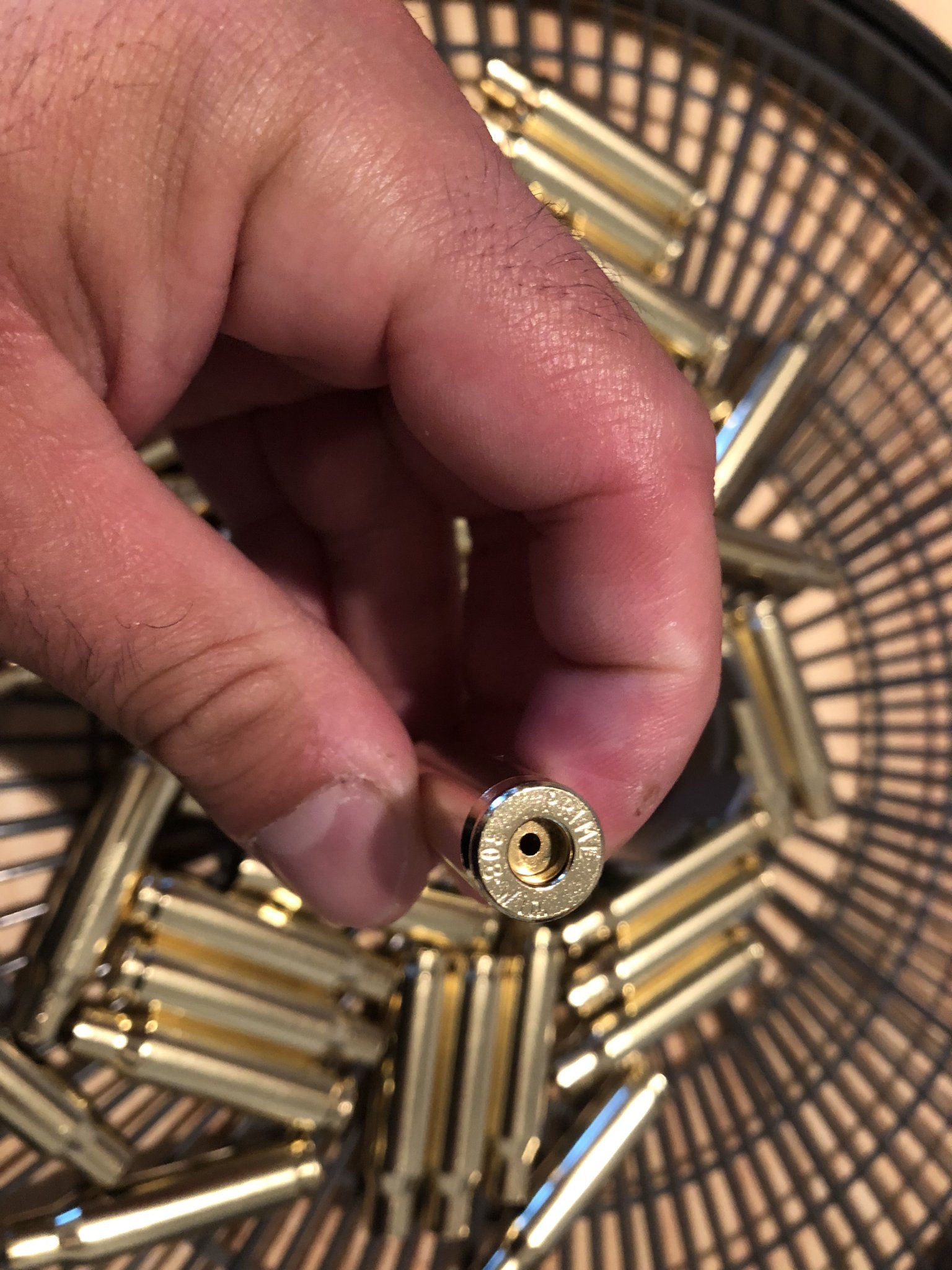

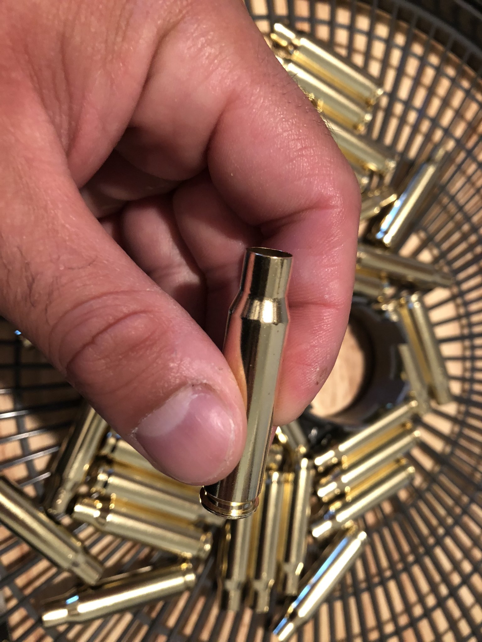

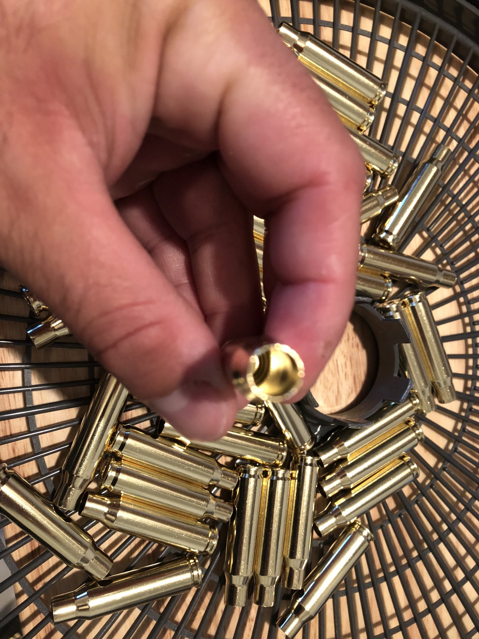

I decided to work on a .308 load and began to process some brass that I had stored away. The brass is Prime, once fired out of an FN SPR rifle. I deprimed and clean the brass with a wet tumbler and then let it sit overnight in a Frankford Arsenal dryer. When I got around to resizing the brass, I noticed that it was extremely difficult to size them. The die would stop approximately 1/2" from the base of the brass and would not budge much. Eventually I got a stuck case in my RCBS die. I bought a set of Hornady dies and tried again, making sure that everything was lubed well enough to not give me issues, but got the same results. At first I was using Hornady One Shot as a lube, then switched to Imperial Die Sizing wax, but there was no difference. Eventually I got a stuck case in my Hornady die. I measured the base of the Prime where it seems to be getting stuck and got 0.471. I compared it to some Hornady once fired brass I had laying around which measured 0.466, so only a .005 difference. Any ideas what might be going on? Will the .005 difference be getting the cases stuck?

Brass is not dirty, it is squeaky clean. It was wet tumbled in stainless media for about 3 hours. Die was cleaned and lubed as per instructions, as well as the brass. I did not lube the expander ball, but that's not the part that seems to be giving me problems. I will try it anyway. I haven't had any problems reloading other cartridges, its only this one. I was wondering if maybe heating the brass overnight in that Frankford Arsenal had made it so hard that it is not stretching as it should.

That brass looks way cleaner than any once fired brass I've ever seen. How long are you tumbling?
I tumbled in stainless steel media for approximately 3 hours using Armor All car soap and Lemi Shine. Then I dried for about 8 hours.
