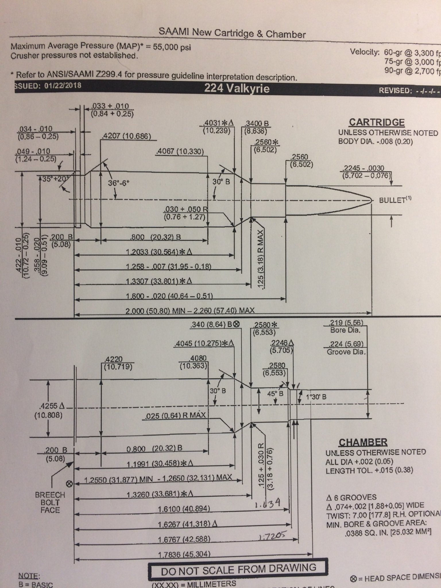

I am humble and appreciate advice that can be of benefit. I purchased a barrel from Airborne Arms chambered in .224 VK ($500). The first barrel arrived short chambered. The replacement is out of spec according to SAAMI with a freebore of 1.8175 and after 300 rounds won't group well, let alone meet their 1 MOA promise. I presented them with my findings and they informed me that my chamber was reamed to this specification on purpose. I stated that I ordered a .224 VK barrel and expected a barrel that was within SAMMI specs. They insist that SAAMI allows this variance. He gave an example that the 6.5 CM has 5 different throats while SAAMI only lists one. I am new to this game and don't want to trash anyone, rather present facts and gather information.
1) Can a manufacturer sell a barrel out of published SAAMI specs and still list it as the SAAMI chamber?
2) Does SAAMI indeed allow such variances that are noted to be outside of the published variances on the drawings?
3) I argue that I received a product I did not order based on the out of spec freebore but am being told otherwise. Whats your opinion?
Thank you

Seems to me they would really be opening themselves up to severe liabilities if that gun exploded for any reason. Unless they documented the barrel would not be saami specs I'd say they are in the wrong. I'd demand a refund and if they refuse, start with the better business bureau, then file a claim in small claims court. They wouldn't have a leg to stand on.

It’s hard to wrap my head around such a large gap. Doesn’t this lead to a loss of pressure and therefore volicity?
Minimally but plenty of stuff shoots good way off of the lands as well. While not a sierra document to match your bullet Berger recommends a test for their secant vlds that goes to .130 off of the lands. That loss in pressure could also mean you can handle more powder to make up that velocity but maybe it also puts your pressure band in a more optimal position. Only way to know is to test.
http://www.bergerbullets.com/getting-the-best-precision-and-accuracy-from-vld-bullets-in-your-rifle/
Edit: sierra has a blog article that says they also like up to .08 off https://sierrabulletsblog.com/2014/11/20/long-throats-and-accuracy/

How did you measure the actual length of the freebore? Is the 1.817 the base to ogive length? How much is it jumping at mag length?

Addressing the freebore over true SAAMI spec, I don't think you really have much of an argument there. As mentioned, it's not uncommon for factory guns to have longer freebores. If it was short it could be a safety hazard, but long, no, and a lot of longer throats shoot great with many bullets. Mine is a bit on the longer side and it hammers with everything I've used.

I'm very aware of SAAMI specs but with how many manufacturers use longer than standard freebore with great accuracy plus the fact that it would be difficult to prove that it's the cause of the poor accuracy I just don't think it's the proper avenue in this case. The company advertises a 1MOA guarantee and the product delivered twice now does not meet this guarantee with factory ammo or handloads even after their in house assembly of the upper. That's all that matters, not debating back and forth about freebore being the culprit. Not working as advertised is reason for a return for almost any item in the retail industry, especially when it's already been replaced or repaired once.
