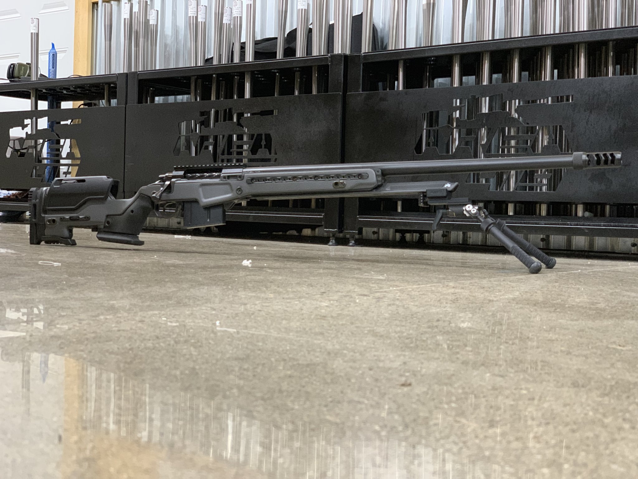

UPDATE ON POST #40
Thanks for all the insights everyone. Decided to go custom as we (my dad and I are doing this one together) couldn't justify the price of the AXMC. Thanks for the post @redneckbmxer24, that is just what we were looking for but we just didn't feel like it was worth the extra cost. I'm sure it's a very nice rifle but we just decided custom was the route to go.
Huge thanks to Wade at Stuteveille Precision for answering all our questions and getting this put together for us.
Placed the order today. Here are specs:
J Allen Chassis Long Action CIP, Titanium Gray, Arca Rail 6"
Defiance Deviant, LA, 20moa, magnum bolt face, Nitride finish action (black)
Bartlein, .308, #7 (MTU), 1:9 twist, 28", Straight flutes - Shallow, Cerakote barrel graphite black
Chambered in 300 Norma Magnum
APA Fat Bastard Gen 2
2 x AI 5 rd cip mag
Trigger Tech Diamond - Flat Shoe
Optic - TBD (Leaning towards NF 7-35 or ZCO 5-25)
Mount - TBD (Probably Spuhr Mount or Era-tac Adjustable)
Bipod - TBD (Probably Atlas 5-H or Cal Gen 2)
Now the wait.........
UPDATE - 1/6/18
She is finally done and on the way. Can’t wait...
I’ll do a full workup once I get to the range and get some time behind the trigger.

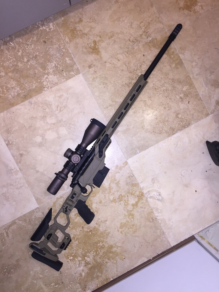

I went custom for mine. I had the exact same intended use and couldn't be happier.
Mine is a SAC 300NM
Defiance Alpha 11 Action
Bartlein Barrel - 26" Heavy Palma 1:9 Twist set up for 230 Berger Hybrids
Cadex Chassis
TBAC 338 Ultra
RL33 and Norma Brass @ ~2900 fps
Old pic prior to receiving stamp for suppressor. Now running the Area 419 break and TBAC adapter.
I love this rifle. You cant go wrong with whichever you choose. I went custom so I could have it set up just like I wanted.

How do you like the 338 Ultra on a 300NM rifle? That's probably the largest cartridge I'll ever consider getting a rifle in and I have a 338 Ultra on order. I'm curious as to how manageable the suppressor makes it.
I use the 338 Ultra on both a 15 lb 300 Norma and a 22 lb 338 Norma (both improved). The 338 Ultra turns both of these rifles into pussy cats. Recoil is completely manageable, with a noticeably longer and smoother impulse. I can easily spot impacts with both rifles off of a loaded bipod. Noise reduction on these rifles with the 338 Ultra is pretty much as good as it gets. I can't tell a difference in noise/blast between my 6.5x47 with an Ultra 9 attached and a 300 Norma improved with the 338 Ultra attached.
Bottom line, this is pretty much the best can you buy for the Norma mags. It is extremely impressive and makes these big cartridges a joy to shoot.

I haven't measured the overall length, but it's long. If I take the brake off, it barely fits into a TacOps large drag bag. The rifle barely fits into a Pelican 1750 case (including brake), but the rifle needs to go into the case at an angle.

That’s very close to what I got. Defiance LA 20MOA, Bartlein, Fat Bastard (it’s LOUD). I went with an XLR CIP chassis and CIP mags. They work with the 3.765 Warner 198 load I run. Neither Greg Young nor I could get the standard Trigger Tech to work in the Deviant, but the Diamond may be GTG. I went with a Spuhr 20 MOA mount for a total elevation of 40. I went the Razor Gen II route, but of course the ATACR has more magnification. I just got the Atlas 5-H.
