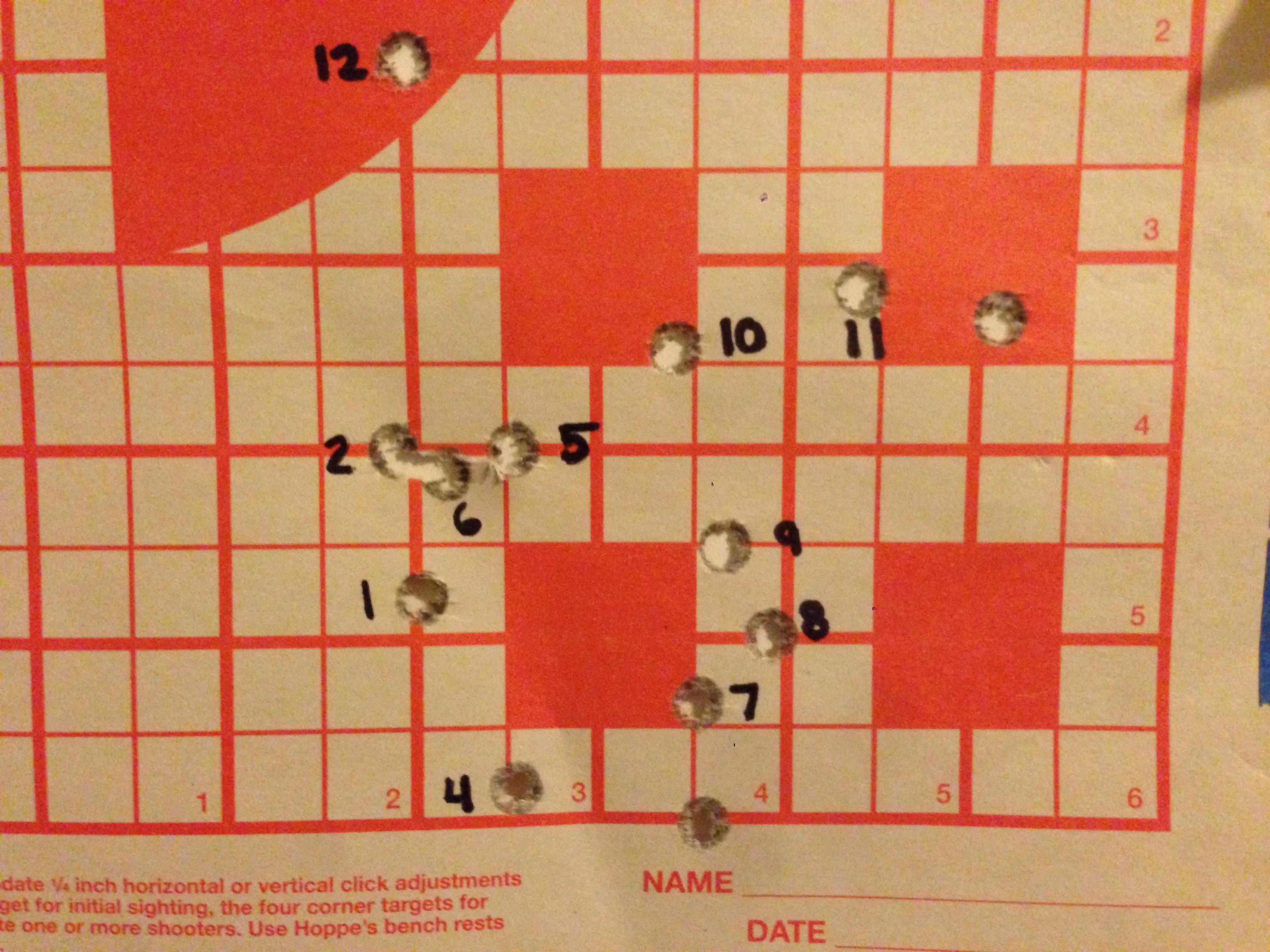

I read this thread yesterday and was able to make it out to the range today for the first two parts of the ladder test and let me say this if you do the test right you will find results and very quickly! hoping i can get back to the range and shoot my five shot groups and start playing with seating depths. So far my new 223 build looks like it is going to like any where from 22.5 to 23.1gr TAC behind a 69smk, my 22.5 22.8 and 23.1 made a nice 1" group at 300 yards and the 23.7 and 24.0 powder charges impact at 300 yards was ruffly 4" above that group!

Shot this ladder at 325 yards with 208 a-max. Im having trouble analysing it. Anyone see any groups?

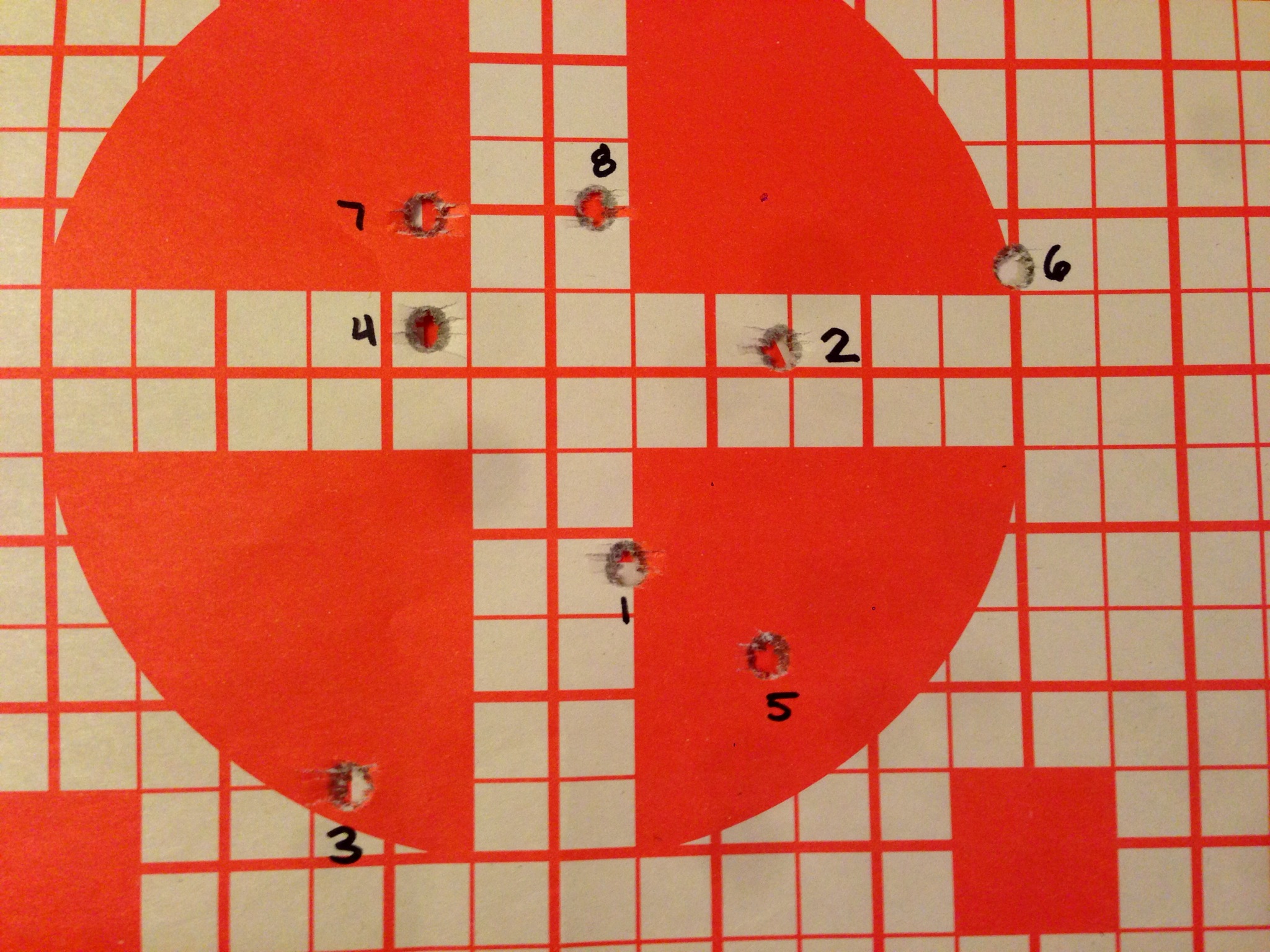

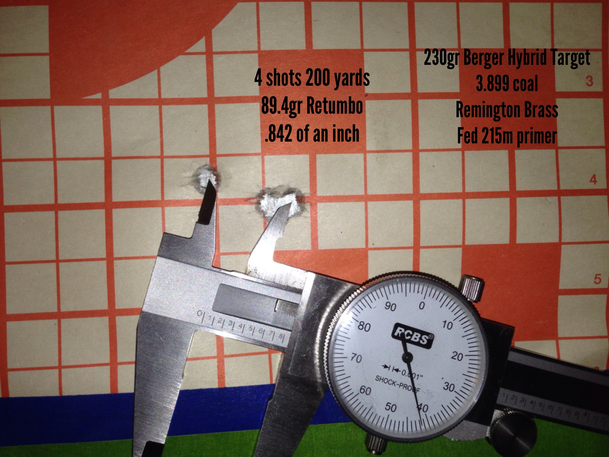

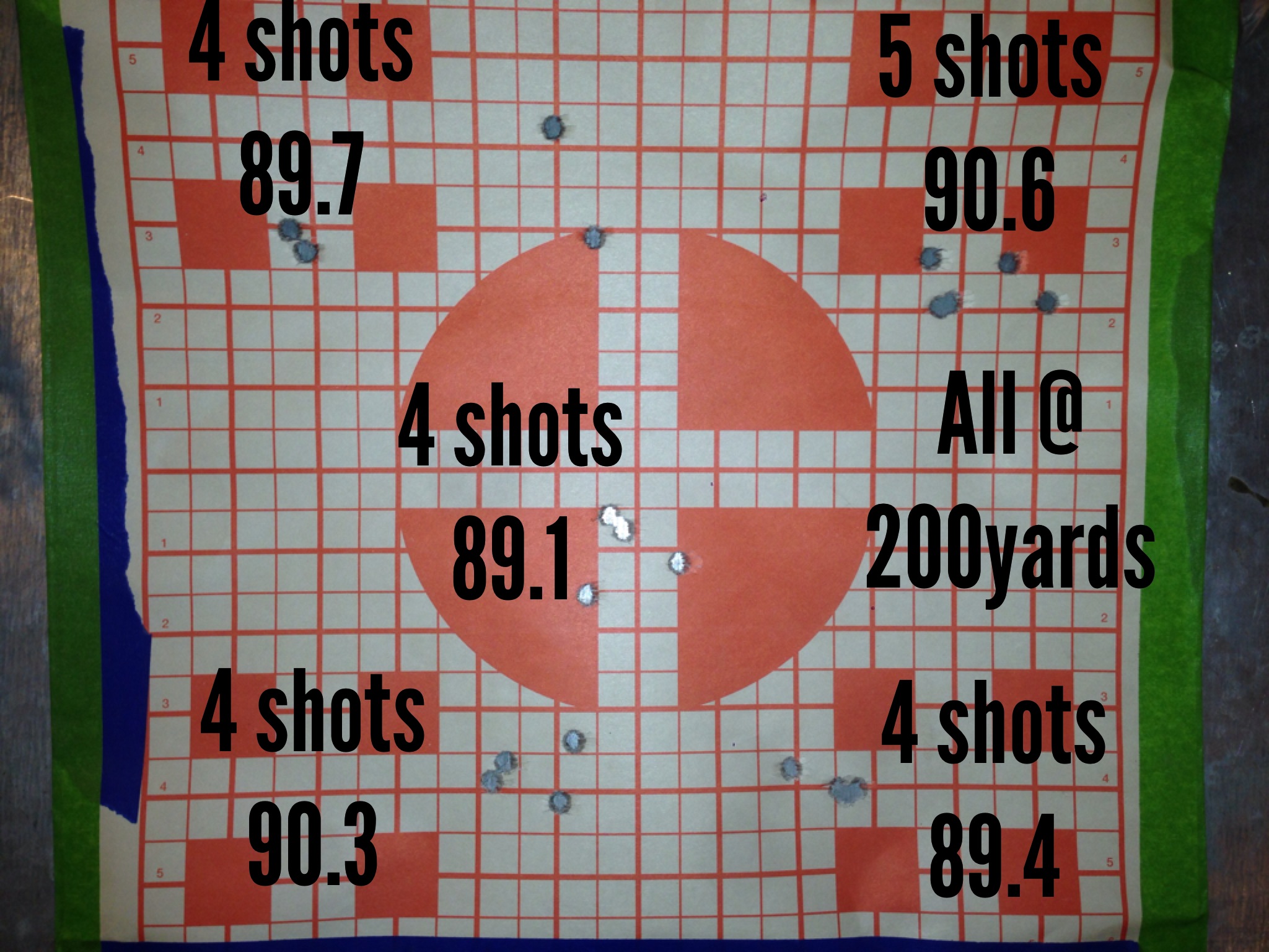

300 RUM 230 berger ladder tese
Here is my first ladder test I've ever done. Thank you to all who have made this thread possible. Here is the info.
Phoenix Custom Rifles 300 RUM
Blueprinted/Trued 700
PTG firing pin/spring
H-S Precision Sendero takeoff stock

I loaded the 300 Rum with brand new remington brass, fed 215m primers, 230 berger match hybrid target, brass oal @ 2.40, coal 3.918, and retumbo.
Shot @ 300 yards prone with rest and rear bag. Zero wind, 50 degrees, 2100ft elevation. Dialed 2 moa up from my 200 yard zero with an estimated muzzle velo of 2900. Shot two sighter shots and then proceeded.
1.) 84.0
2.) 84.5
3.) 85.0-bad primer didn't ignite
4.) 85.5
5.) 86.0
6.) 86.5
7.) 87.0
8.) 87.5
9.) 88.0 MAX
10.) 88.5 MAX+
11.) 89.0 MAX+
12.) 89.5 MAX+
From looking at the pic I believe shots 7, 8, 9 are the node. They Measured .869 ctc at 300 yards.
What do you guys see? I am I reading this correctly? I may go back and load shots 7,8,9,10, 11, 12, and maybe 13,14,15 just to see if I can see my max pressure. What do you think? Also I want to move my coal to 3.900 so I am not in the lands. After the primer failed on shot 3 I lifted my bolt and pulled back but only the case and powder came! Bullet was stuck and powder everywhere. Luckily I always have my range box with me and quickly cleaned up the mess! This is getting fun if I am able to improve the 7,89, group! I also have 3 pounds of H-1000 and 8lbs. of Retumbo. Im thinking of doing a new ladder test with H-1000, would this be a waste of time and money? Please let me know if I'm on the right track, Thanks!
Sniper Uncle
Patriot Marksman Trainee
Belligerents
Gaps, I'd say your on the right road. I'd be careful about the higher shots, though as you are all ready above "max." maybe go for 0.2 or 0.3 grain increments and stop as Soon as You See Pressure signs. Also, you might refine your 7/8/9 charge weights, and get five shots in that 87-88 grain region. By doing so, you will fine tune your ladder. I wouldn't do very many more ladders, though, I'd probably head off into 3-5 shot groups around the 7/8/9 node that you seem to have identified. These groups will give you more of an idea about if you are actually getting good groups in that charge weight range.
I use a piece of 2' wide paper with "hot-spots" stuck on it for an economical target, you can place the spots 6" or so apart, and then have all your groups on one paper for easy reference, and the 3/4" dots make a good aim-point.
Good work, though. Oh, and BTW, personally, I would try a bit with the H-1000. I figure you may as well get a good idea if you have a good second choice for powder----what if you can't get your first choice?

Thanks for the info. Sounds like ill do just that and see what we are working with. I wish i had somewhere to get past 300yards!

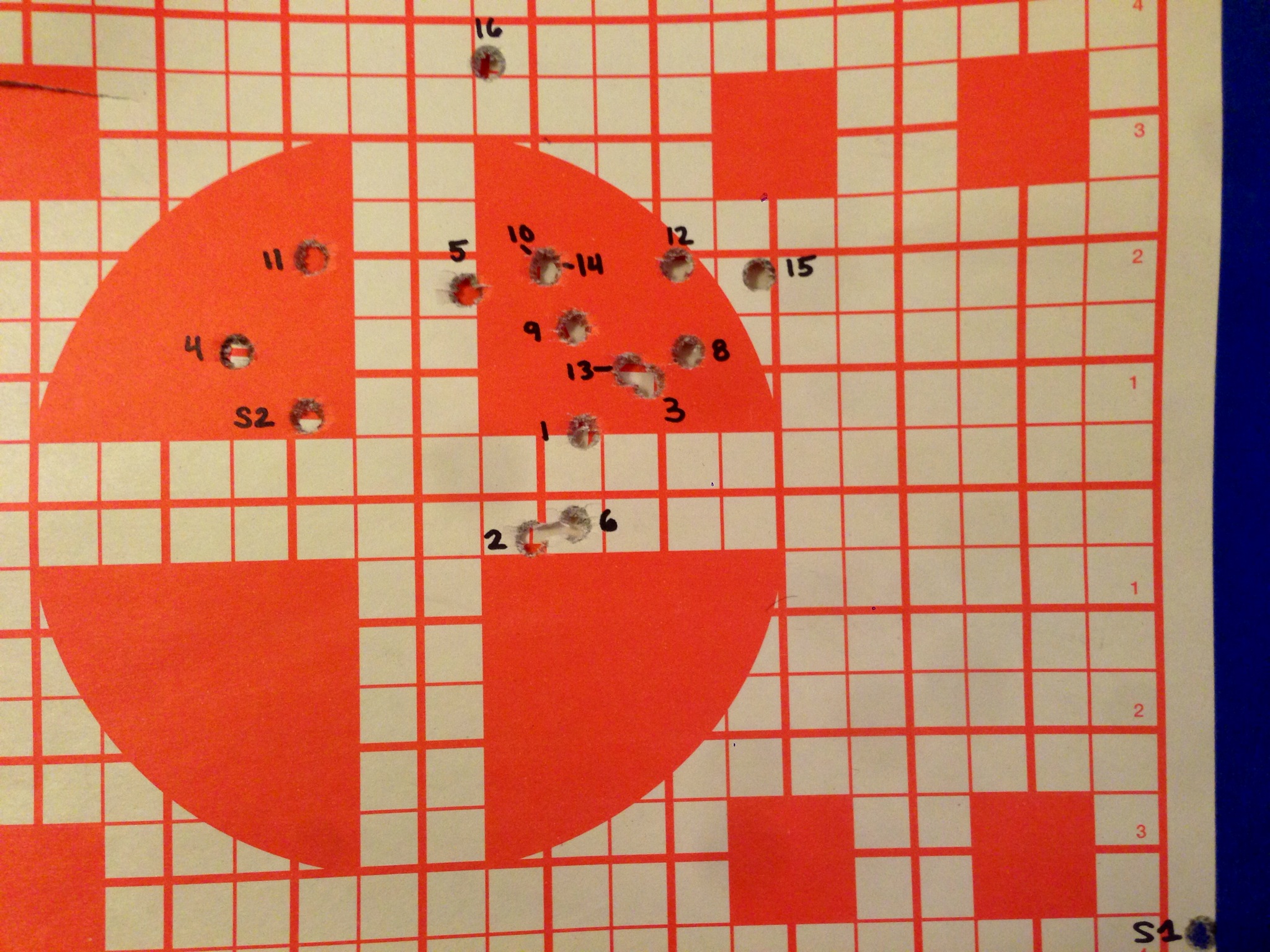

Went and shot a refined ladder test with retumbo starting at 86.7gr and going to 90.0gr in .3gr increments. I wanted to accomplish 2 things with this finer test. One was to see where max pressure was and two was to see if there was a node at higher charges. The only primer that was cratered was #14 and I am not the best at this but the bolt may have been a little stiff at 16.
The vertical displacement on shots 10-15 look really good, especially shots 10,11,12. All of my trigger pulls felt great but I wonder if I pulled 13 just because its the only one thats off!
I think I will load 3 shots of 10, 11, 12, and see which one groups best and that will be my winner. I may do 3 of 14 and 15 too just to see.....
What do you guys think I do next???? Thanks for any input!
Berger max load is 88.2
1. 86.7
2. 87.0
3. 87.3
4. 87.5
5. 87.6
6 87.9
7 88.2 no go. failed primer, wtf!
8. 88.5
9. 88.8
10. 89.1
11. 89.4
12. 89.7
13. 90.0
14. 90.3
15. 90.6
16. 90.9

Here are the final results of the Retumbo ladder test. I loaded 4 shots of 5 different charges and shot them for groups at 200 yards to see which one grouped the best....

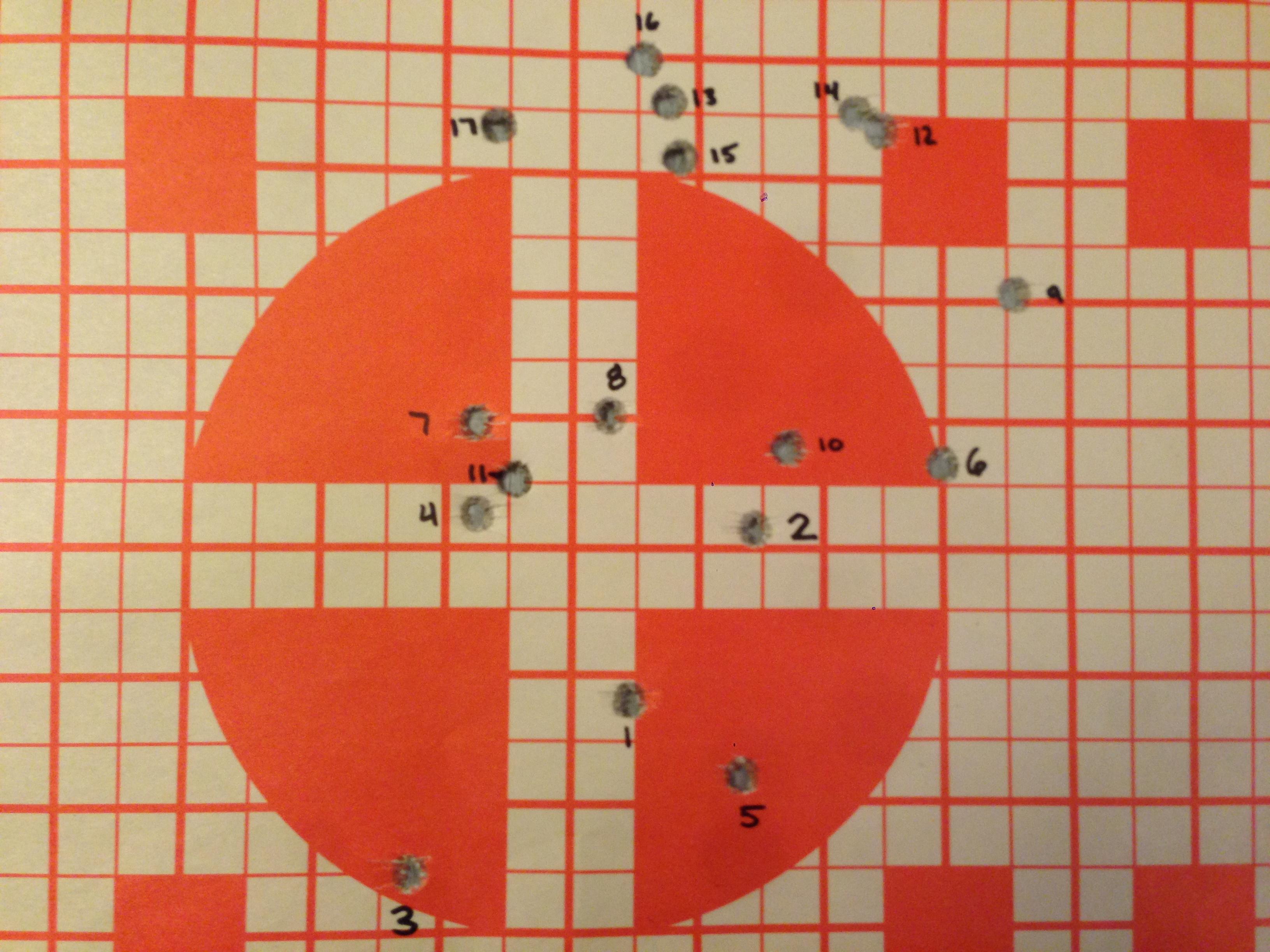

I was also able to finish the first portion of the ladder test with H-1000. This was shot at 300 yards.
***84.8gr of H-1000 is Bergers Max Load***
1. 80.0
2. 80.5
3. 81.0
4. 81.5
5. 82.0
6. 82.5
7. 83.0
8. 83.5
9. 84.0
10. 84.5
11. 85.0
12. 85.5
13. 86.0
14. 86.5
15. 87.0
16. 87.5
17. 88.0

I was able to get out and see how the my retumbo load shoots at some distance. The load is above max at 89.4gr retumbo, coal 3.899, 230gr berger match hybrid target, fed 215m, remington brass. It averages 3,008fps. Skip to 5:20 if you only want to see my rifle shooting, if not watch the whole thing!

I would let it cool at least 90 sec between shots...or until it was no more than warm to the touch. If you can wait longer do it. I don't like shooting a hot barrel if I don't have to...
