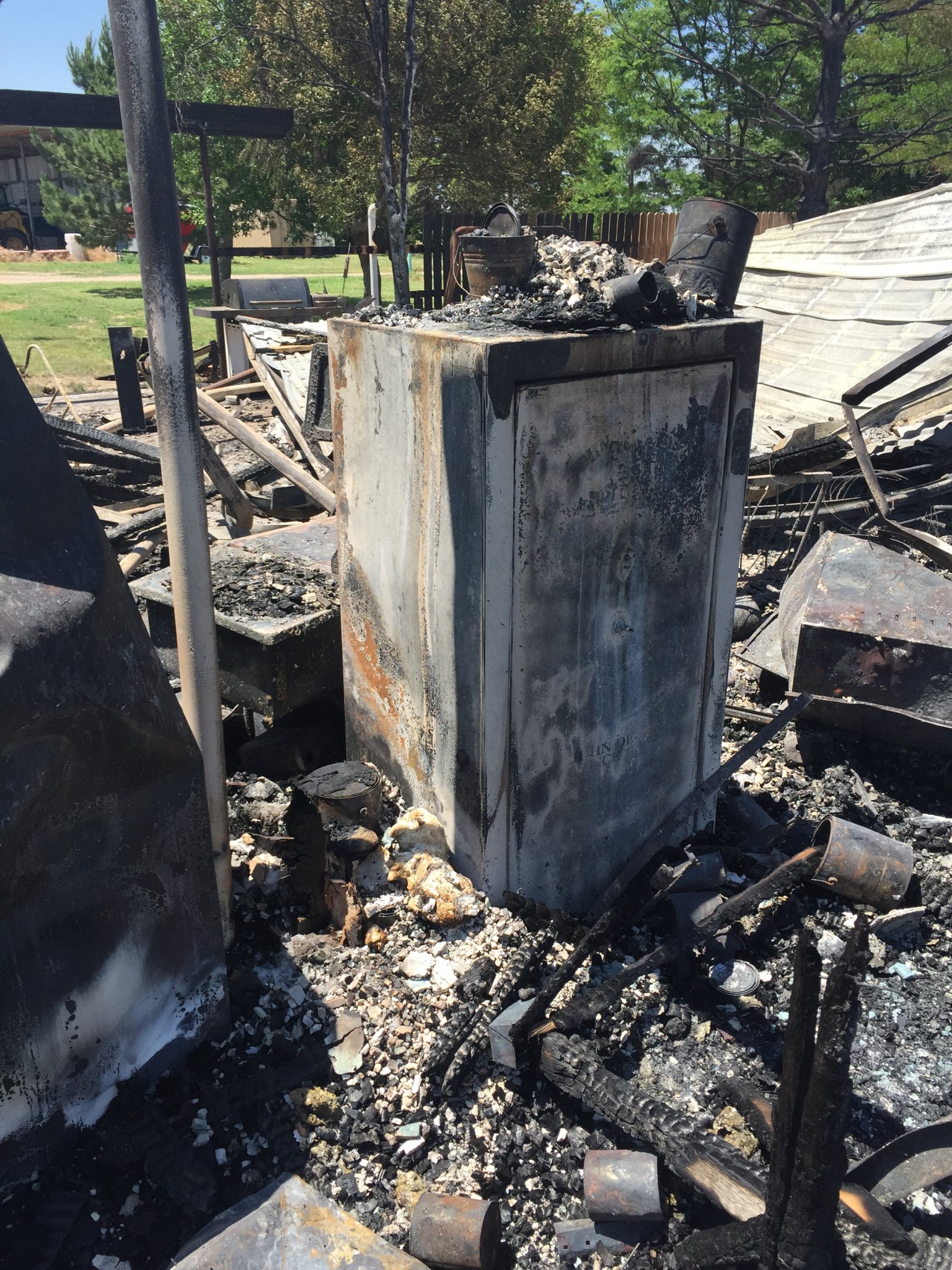

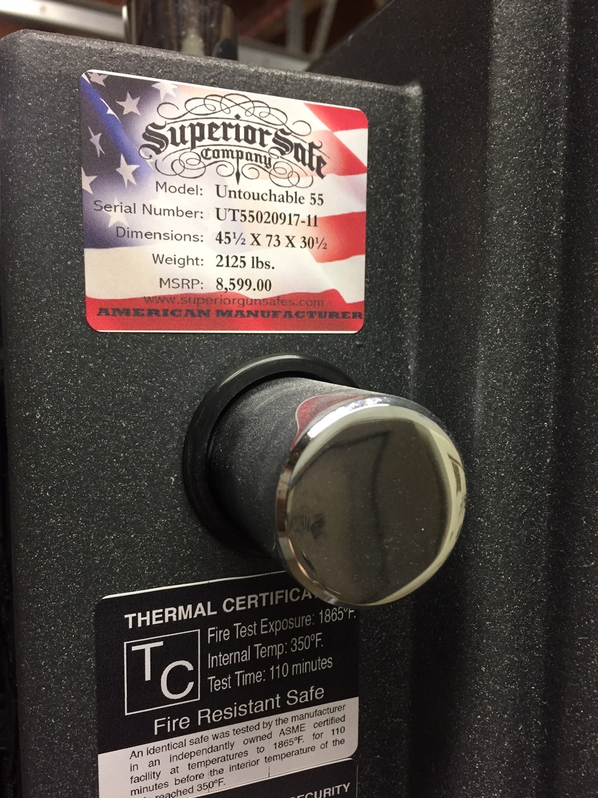

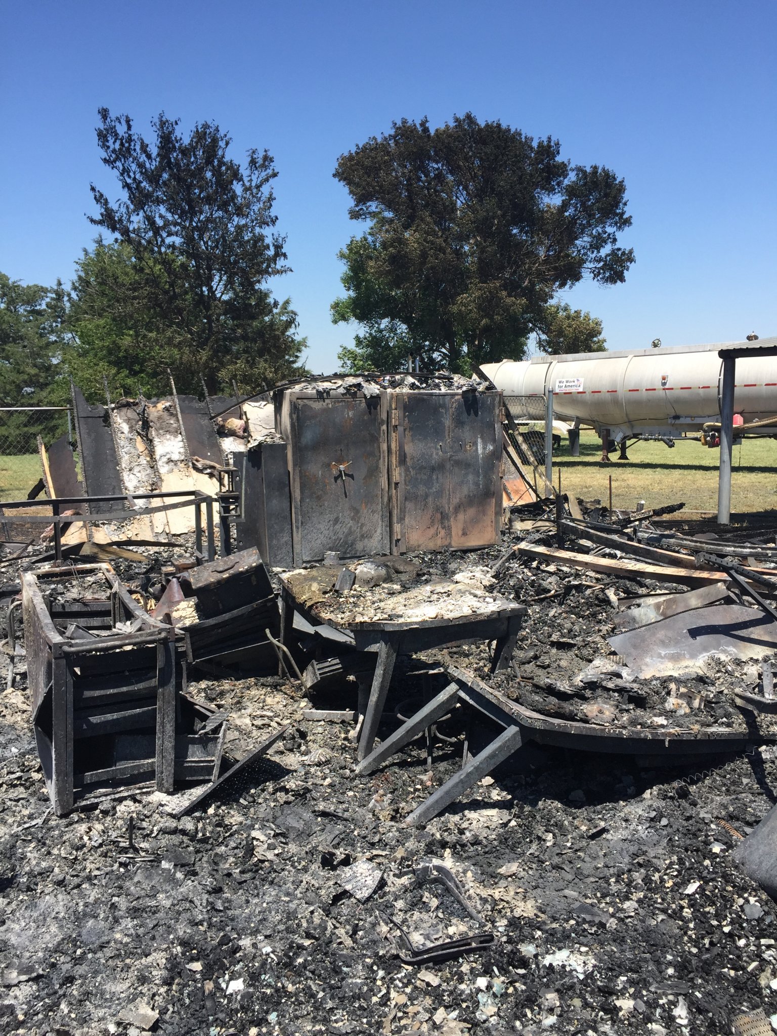

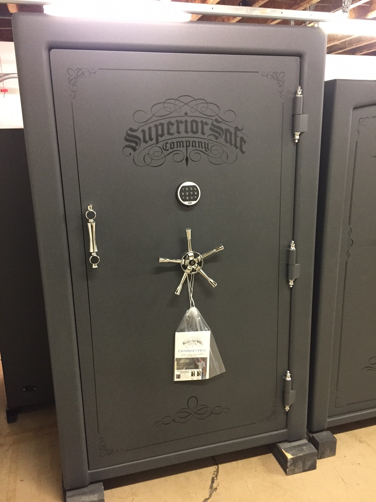

Here is what I saved for and purchased. Class-B rated. That means a professional can get into it in about 5mins. It will most likely take the average crackhead with power tools 30mins to get into it. By then, my alarm will have the cops there. Moreover, if the guns are stolen, I have additional insurance to cover my noise makers.

After actually going through a fire a couple years ago I would recommend not going with a cheaper safe. We had a couple smaller middle of the road Liberty safes like you would pickup at cabelas and a 1980's double door Meilink safe I bought for a really good deal but didn't know much about. First off how long it takes for the fire department to get to your home makes a difference and where in the house/garage the safe is located is huge. I'm in a rural area so response time was around 35 minutes (kudos to our vfd because that is a good response time for the distance they traveled). One of the Liberty safes was very close to where the fire started and that was in the middle of the garage/house so the fire burned there the longest and didn't get water very quick. The other two were near an exterior garage wall and the FD was able to get water on them pretty quick and keep the temps down somewhat. The liberty safe in the middle was toast and so were the guns in it. Anything synthetic or rubber melted completely off and finishes were destroyed from heat and smoke. Optics were completely destroyed. The liberty safe near the exterior of the garage was burned bad but the guns inside for the most part only showed smoked damage except for a few heat damage spots near the seam of the door. The Meilink near the exterior wall showed no heat damage inside but some definite smoke damage. Where the handles and locks were gone or damaged we just cut into the safes to retrieve the guns and it was interesting what we found. Safe in the middle of the house/garage had virtually no gypsum board left intact. Most was crumbled up and laying in the bottom half of the safe between the shell and liner. The liberty safe near the exterior had some pretty major compromises in the gypsum liner but was intact for the most part. The Meilink was a different deal. Once the outer shell was cut we found a solid concrete type poured in insulation. Besides smoke damage because it's door seals were old and shrunk up there were no real signs of excessive heat anywhere. So my take away from this experience is that a safe needs to have some sort of poured in concrete fire liner and a two stage door seal system. The first seal needs to seal out smoke till the paulsol heat expansion seal gets hot enough to expand and seal. A metal liner is a big plus for theft deterrent as well. Keeping the smoke out is a big deal. I have never seen something so corrosive as smoke from a house fire!!!!!! Hope this information helps and I hope you guys never have to go through it!!
