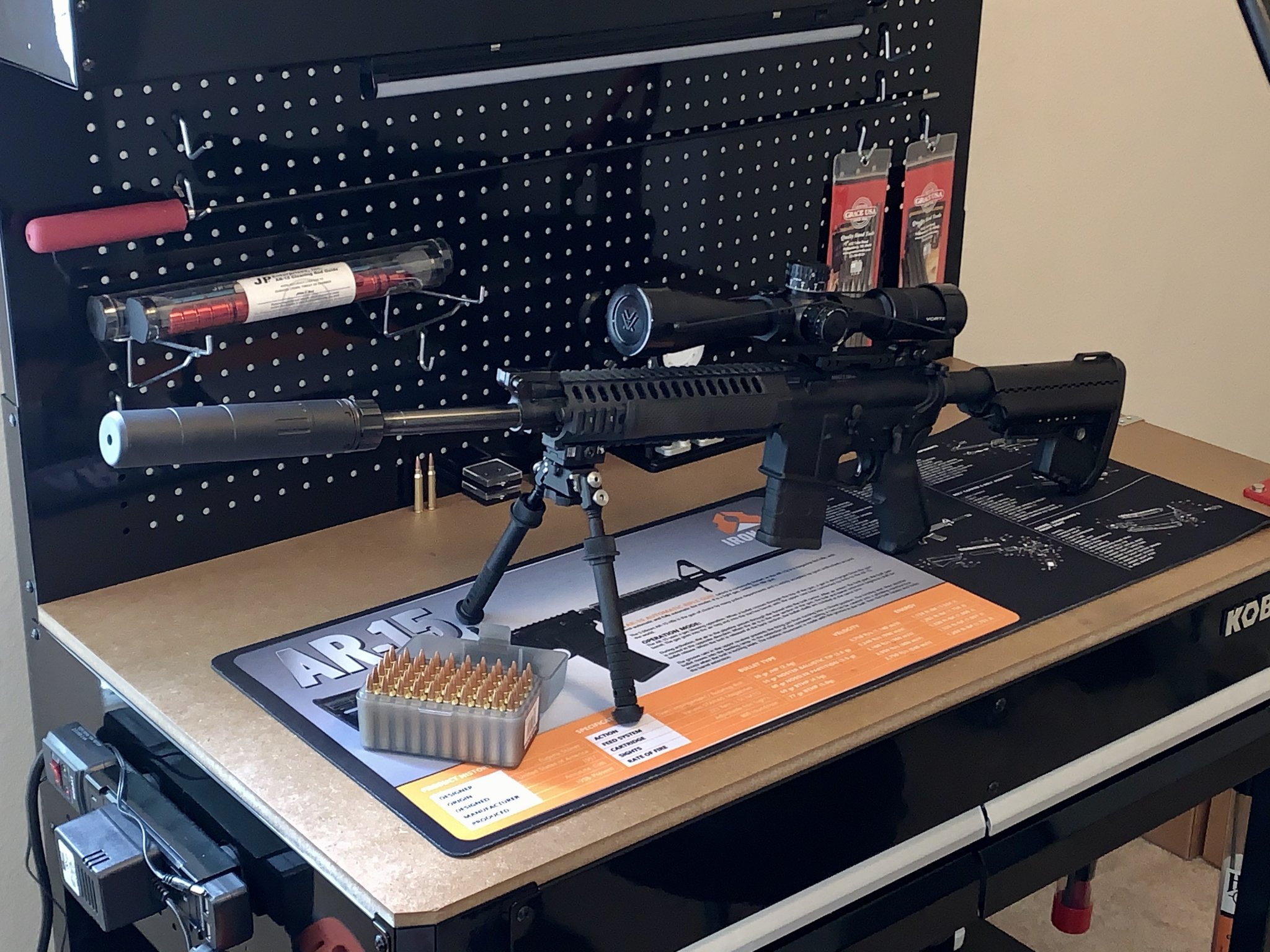

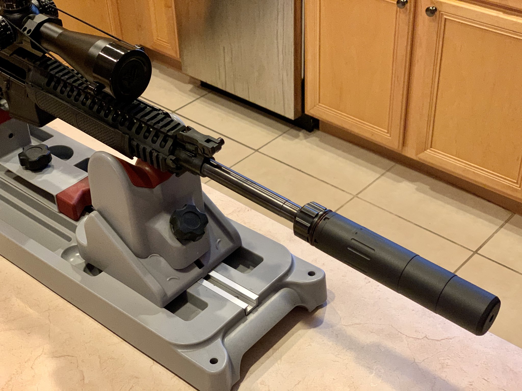

Groups open up significantly with suppressor
TSloper
Oct 1, 2019
54
55
24
LWRCI M6A3 (16.1”)
AAC M4-2000 Suppressor
I’m able to achieve consistent groups (1 MOA to just under 1 MOA) when shooting without the suppressor at 200m. At 100 yds with the suppressor the groups are worse than my 200m groups.
I’m not sure why this is happening. Charge weight off for suppressor? Thermals? Harmonics?
Any guidance on diagnosing would be appreciated. The alignment is perfect when mounted. I have a Geisselie rod to check. No indications of a baffle strike.
My first inclination to sweep the charge weights and see if that is the culprit.
Thanks,
Tim

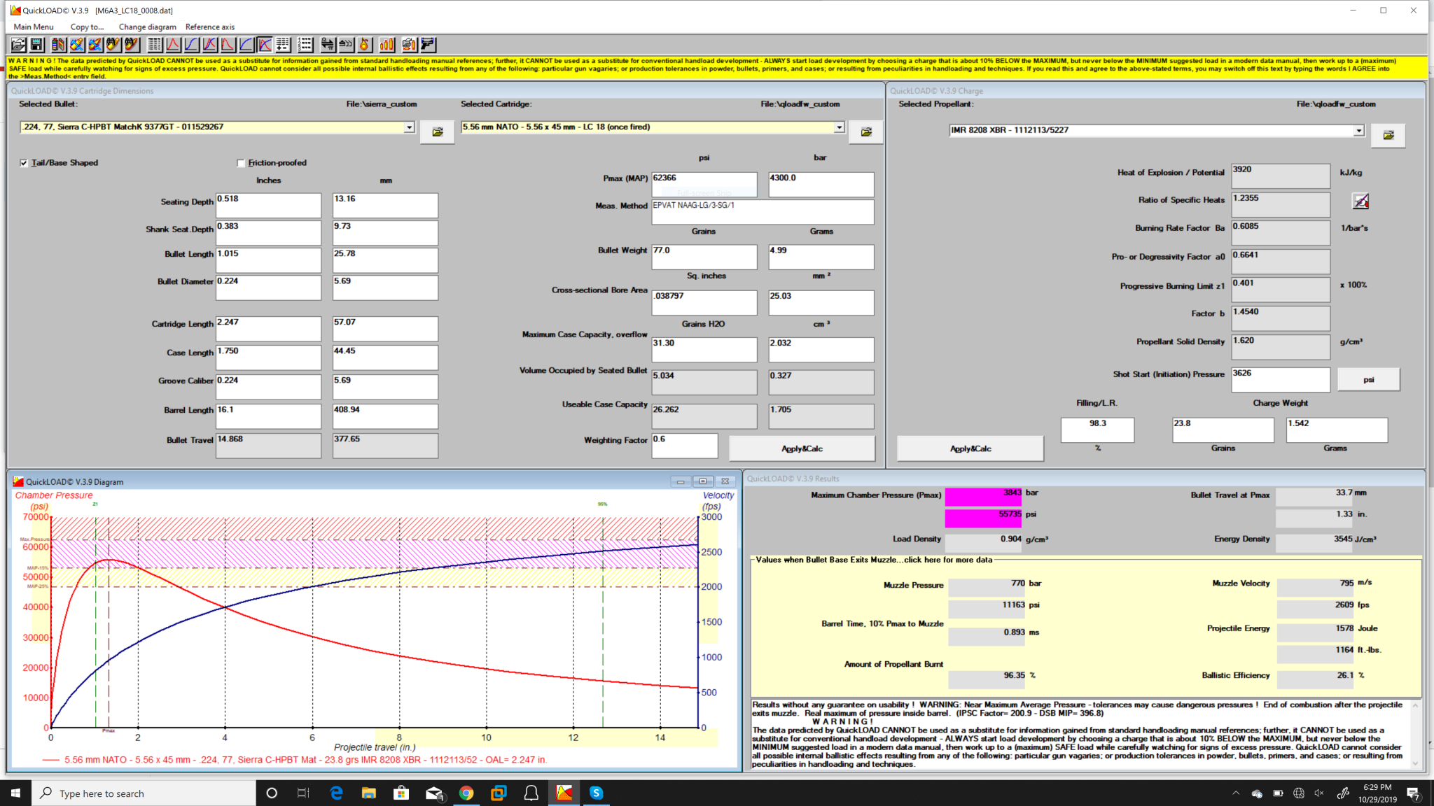

I will measure some cases tonight. Attached is my QuickLoad output for the load I'm running. Ba is dialed in to match the non-suppressed velocity. All other metrics are measured as accurately as possible (case volume, etc). I'm definitely not riding the line at 23.8 gr per QuickLoad. Magnetospeed V3 MVs are as follows...
15 rnds un-suppressed @ 23.8 gr once fired LC 18... 2609 fps
10 rnds suppressed @ 23.8 gr new LC 18... 2624 fps
As for gas control... in full disclosure I forgot to switch to the suppressed setting on the M6A3 before going suppressed. Unfortunately I've seen the large groups suppressed before with the gas block set correctly. I WISH that was it.
Tim

Quick load can help with establishing a baseline for estimating/predicting pressure dynamics but unless you have the equipment to take direct pressure measurements when firing the rifle for comparison, it’s purely theoretical. Most of us don’t have a need for such equipment anyway, given the other ways to detect pressure signs.
Your MVs are not substantially higher suppressed vs unsupressed which is a good thing.
Any significant changes in standard deviation and extreme spread when shooting suppressed vs unsuppressed?
Also were those measurements taken when the bore was “cold” (first 20 rounds through the rifle in that session) or warm?
I like to take data over 10 rounds from a cold barrel then continue to shoot then 50-100+ rounds later, gather data for another 10 rounds on a warm, heat soaked bore to measure a given load’s sensitivity to chamber and barrel temp. I only do this sort of test after a given load has shown promise after initial testing.

TSloper
Oct 1, 2019
54
55
24

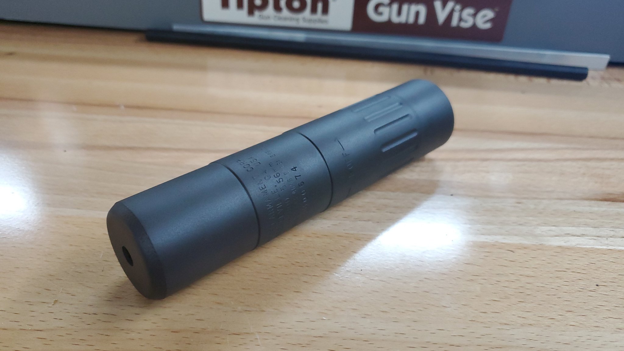

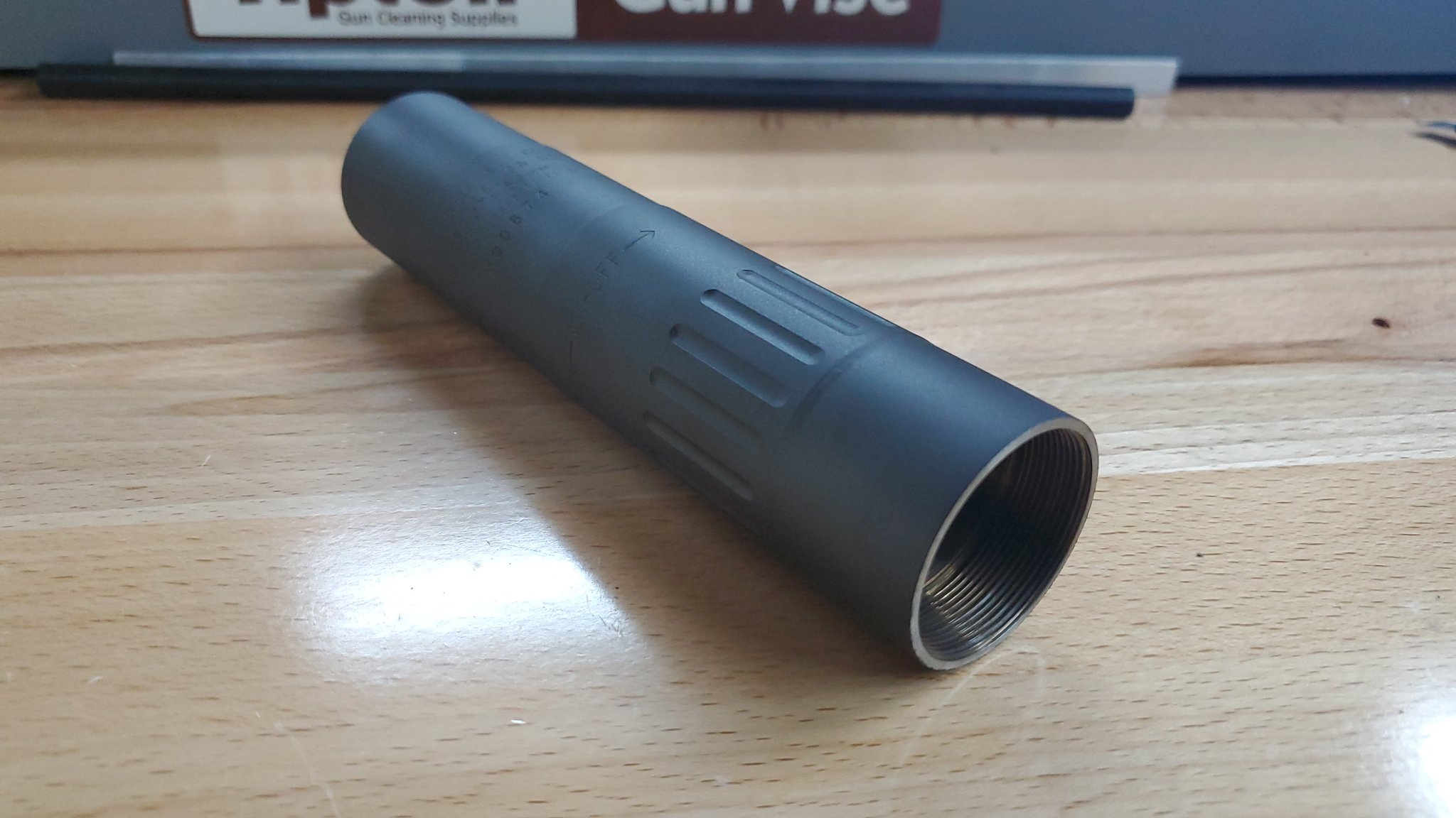

So I made it to the range yesterday. Here's the issue... the damn M4-2000 wobbles horribly once a round or two has been fired. The teeth don't engage properly when fully tight so it backs off to the closest full engagement of the teeth and at that point there is a tremendous amount of play. When fully tight I can't change the alignment relative to the Geissele checking rod. When the can backs off there is enough wobble for the Geissele rod to touch the can. I did fully clean the mating surfaces yesterday before going to the range so there is no carbon buildup to take up some of the slop.
So options as far as I can tell...
1. Call AAC and let them deal with it completely. The can went back to them a few months ago for refinishing and it looks like they changed the latch while it was there. This may have been the point at which this problem started I just didn't notice it until I started focusing on reload accuracy/grouping. Not to keen on sending in the upper but may have no choice.
2. Try a Viton o-ring to take up the slack with full teeth engagement. I have the Geissele rod so I can ensure the can isn't out of alignment when installed. This honestly would be my preferred path if it works. O-rings are cheap.
3. Take off the flash hider and carefully remove material on the 45 degree mating surface of the flash hider to allow it to engage the next pair of teeth. This would achieve a perfect fit but what a hassle.
4. Let the carbon build up but given the amount of play I'm seeing I don't view this as having a high chance of completely eliminating the play.
On a positive note I spent some time un-suppressed dialing in my new Vortex Viper PST Gen II 3-15x FFP... I had 3 touching at 100 yds. It is by no means enough of a sample statistically but I've never accomplished that before with my ACOG. I'll get to the 200m range next week and see how things are looking. This lot of 8208 XBR seems to have a sweet spot at 23.8 gr on my rifle without the suppressor. MV average is 2609 with this load (77gr SMK, CCI 41).
Tim

TSloper
Oct 1, 2019
54
55
24
ECCO wrote back. I'm going to send the suppressor out tomorrow and have it converted to an Omega mount pattern. It sucks having to pay for something like this but it beats the cost and time of getting a new can.

TSloper
Oct 1, 2019
54
55
24
Ordered a Dead Air Key-Mo Omega mount and flash hider. Can’t wait to have this thing performing as it should.
Reactions: nn8734
TSloper
Oct 1, 2019
54
55
24
This endeavor was worth every penny. 100 yards / 77gr SMK / 23.8gr 8208 XBR. This was off of a brand new Atlas bipod on the bench. That’s 4 touching with the 5th being my screwup. My groups before the ECCO work were 2-3 MOA. I repeated this on another group of 5.
