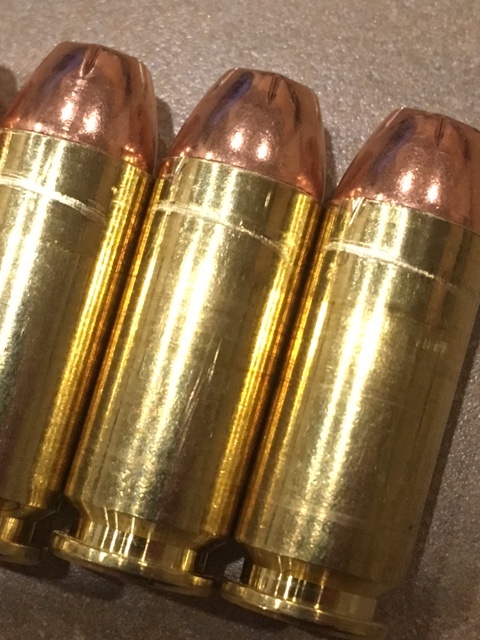

GLOCK 29SF: I have a KKM fully supported chamber, wolff steel guide rod, 22# wolff spring. I'm using factory 10 round mags with the factory base plate to get the best results. If I put the pierce +0 extension on the mags or shoot a glock 20 mag out of this 29 it jams about once every other mag. This gun jams a lot. Its not limp wristing and I know others are going to say leave the gun stock. I am shooting with this KKM barrel to shoot cast bullets, so I'm not bulging the brass, and it is also way more accurate. The problem I continue to run into is the slide strips the back of the next round just fine, but then for some reason causes the tip to steer up and left lodging into the back of the barrel in the upper left corner. It does this with all types of different bullets and more common in the hotter load levels. I love this pistol for how powerful it is and such a small package, but the damn thing jams most times I shoot it. It also seams to jam way worse with the pearce extension on it too.

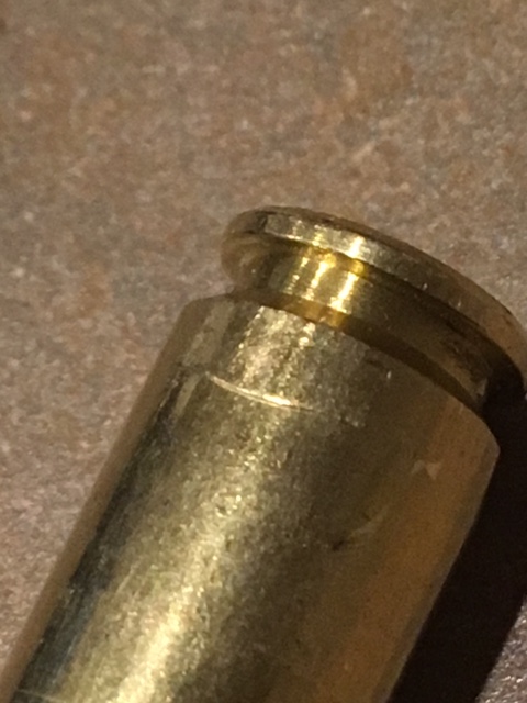

GLOCK 20 gen4: This pistol is completely stock so far. I plan on getting a KKM match barrel for it eventually. As of now though, it is bulging brass badly. It has been completely reliable, but with factory s&b and underwood ammo it is bulging so bad it is about to fracture on some cases. As far as handholds go, I started very light with both the 180 nosler JHP and the 220 hard casts with long shot powder and new starling brass. Hodgdon manual says for 180 JHP starting load: 8.5 and max load: 9.5. I started at 8.4 knowing this thing pressures up quickly. Even with this below max load I had bad enough bulging that I didn't go any higher. Also with the 220 hard cast which I shoot 8.2 grains long shot in my KKM glock 29, was bulging/fracturing almost with 7.0 grains in the factory glock 20 barrel.

I just cycled a mag through my 29 by hand fast and hard. Every round that cycled through had very similar marks on the mouth of the case and slightly down from there. It makes since its jamming if its hitting that hard every time. Has anyone seen this before? Any ideas on a fix? I wish glock barrels were normal lands and grooves with supported chambers and were designed around heavier 10MM ammo and heavier springs.

Would you mind posting a picture of the FTF condition? From your description I imagined the bullet contracting the back end of the barrel but you picture of cartridges looks like it is contacting the case.
Glock barrels are known for generous chambers to improve reliability. That's why you see case bulging.

Just tried hand cycling mine, and while it does leave a mark kinda like your pic, it isn't nearly as pronounced, and just a tad closer to the case mouth.

Here is a picture of underwood 220 hard cast factory ammo shot out of the 20. The line looks like its damn near a fracture.

I don't have a picture of the jams I've been getting, but yes, it is slamming into the back of the barrel or right at the edge of the chamber.

That is definitely a Glock Smile, it isn't quite as bad as the initial .40 S&W calibers were, but that was before the ammo mfgers started making the cases a tad heavier, and Glock supported the chambers a little better. Still not exactly what you want to see. Just to clarify for me, that round came out of the G20?

That's really odd that it is doing that, my Dad just sold a Gen III, and it didn't do it with full power loads. S&B lists their 10mm 180gr. load at 1,164fps, it definitely shouldn't be doing that with a mid range load like that. Got me, but there is something up with it.
