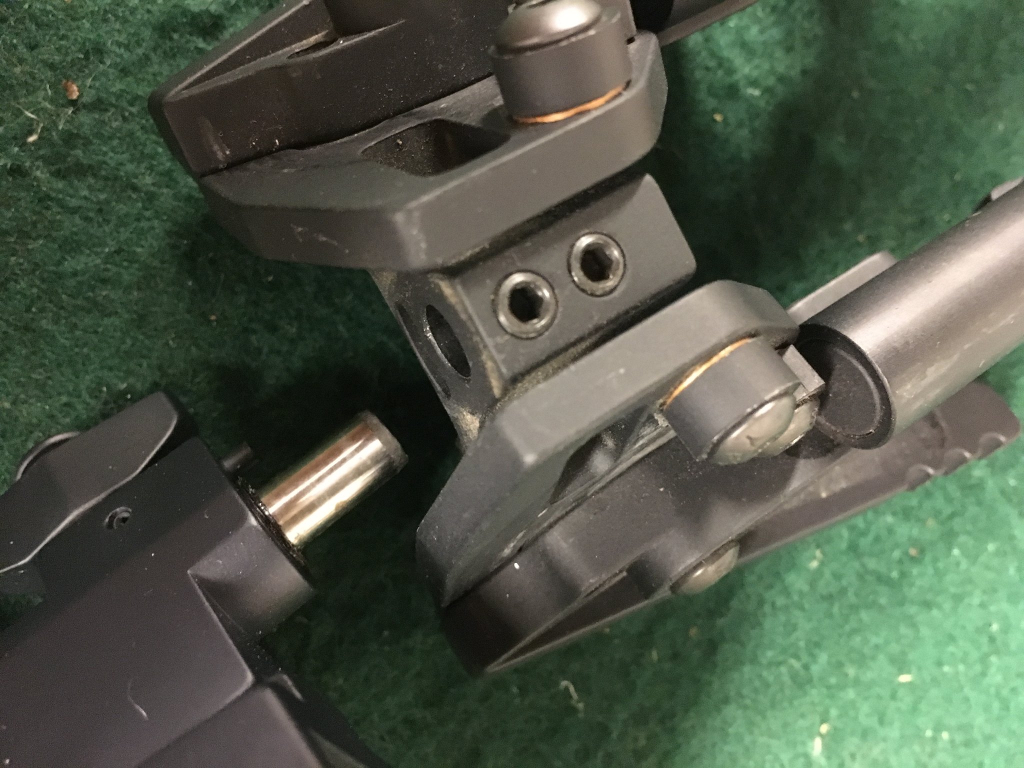

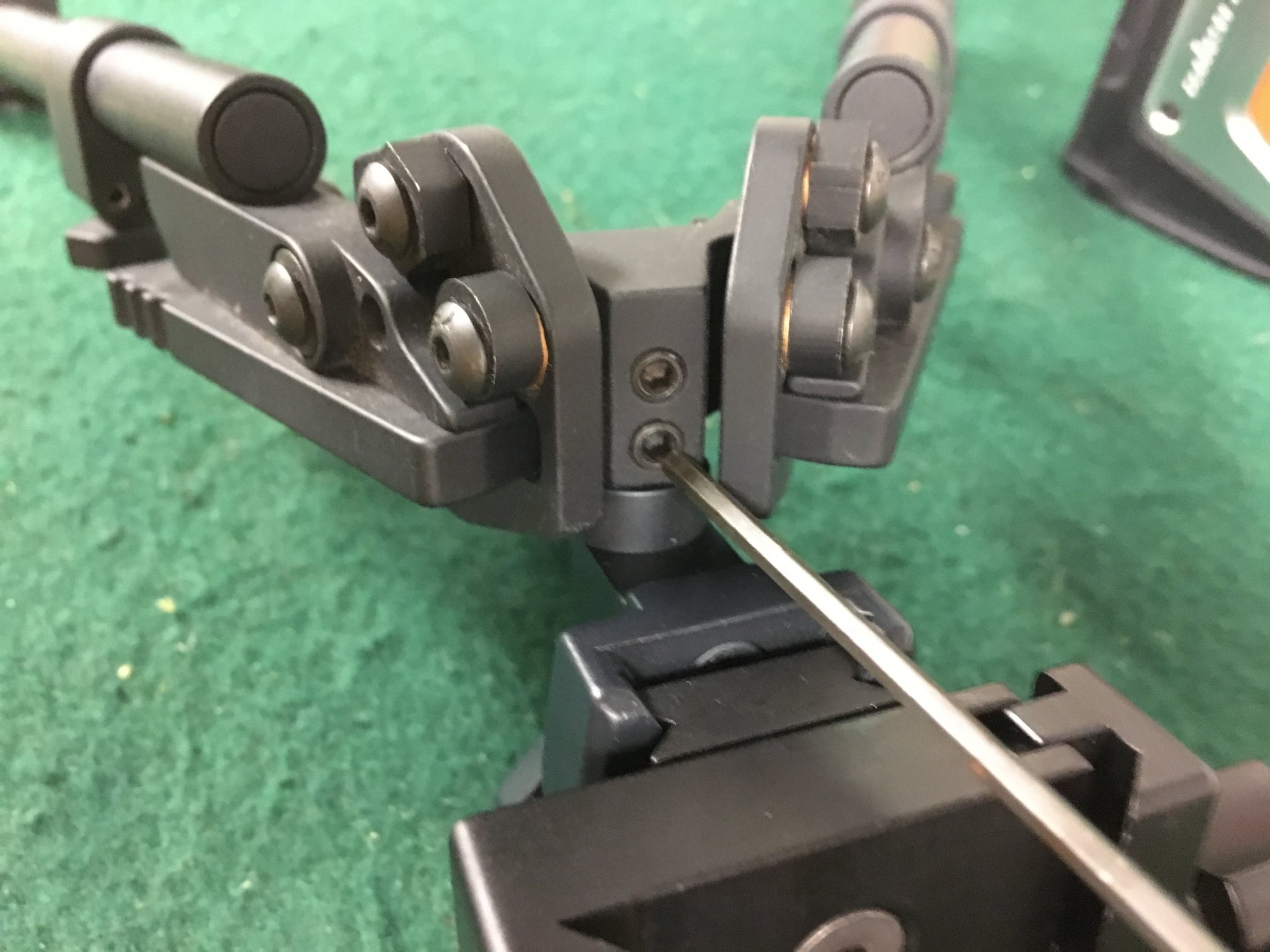

Ok
I got excited and pulled it out before bed, so we gotta be quick. When you look at it from the right end you’ll be able to see where I’m coming from. Just wrench down those two allen screws.

View attachment 7134926View attachment 7134927
Ok
Taaaaa Daaaaaa !!! Winner Winner Chicken Fingers Dinner !!! I'll give that a go for certain tonight. Thanks for pointing that out. Sleep well. ;)
