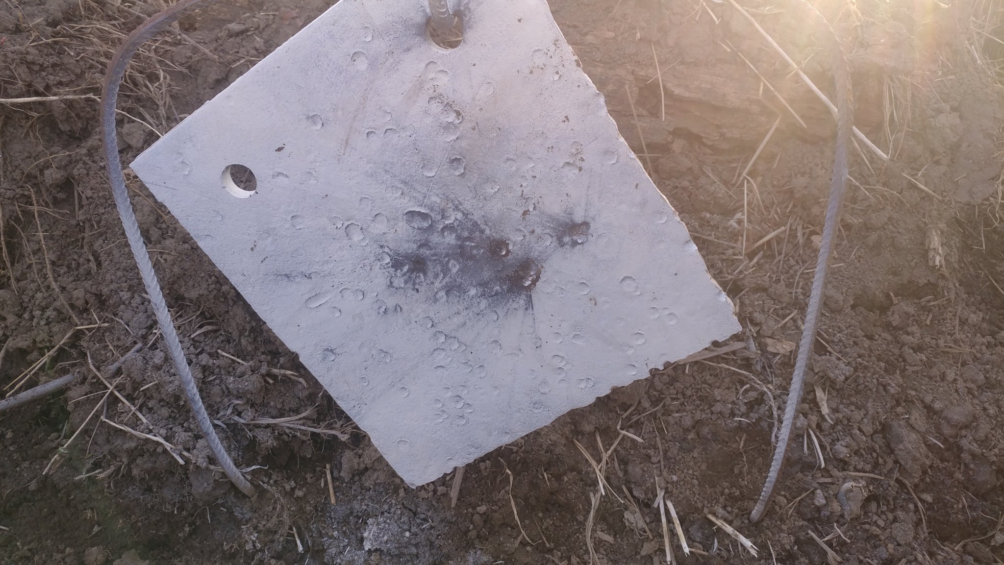

Every time I think I need a little more horsepower I go out and shoot a 6 round group like this at 500 yards in a +10mph wind with a 223 gas gun off a barricade. Then I say to hell with wildcats and I don't even have a heart attack when I can only find 5 pieces of brass.
Well put, I think the 224V is an interesting little round for an AR and will be a big seller. I myself may even build one eventually but it won't be because it has factory ammo since I still have 1000 pieces of SSA 68spc brass from before Nosler bought them out. I will just form my own and work up my own loads. I wouldnt however build a bolt rifle for this round considering there are far better choices. But I'm not knocking what someone else thinks would be a fun project. Its like the endless pissing matches between the 65 Grendal and the 68spc both are fine cartridges for their intended purposes just dont expect an apples to apples comparison of the two. One is better as a target round one is better as a short barrel hunting round. To the Op I say if it peaks your interest and gets you out shooting more build a bolt gun in 224V and have some fun.
