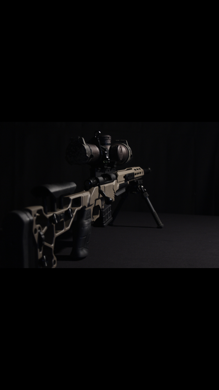

Well, i finished up the build for my brother.
-Howa 1500 24” heavy barrel 6.5 Creedmoor
- MDT ESS with skeleton stock, and arca rail
-Area 419 Hellfire muzzle brake
I’ve got my optics and bipod on it until he gets his funds built back up lol. Went together great, no issues. i like this rig so much that I’m gonna get one myself.
Thank you all for your input on this build, I’m sure he is going to love it!

On another note, those are some pretty fantastic pictures you have of it. These done yourself? I dabble in amateur photography myself. Both of my hobbies have expensive glass...
Frog05
KeepItSimpleStupid
Belligerents
Feb 15, 2017
244
175
49
Southern Illinois
@etn2type Thank you. Yes, those are my pics. I’ve been jumping into photography over the last two or three months. This photography stuff is expensive! Makes it tough to follow the advice of @ArmyJerry and buy more ammo.........but I do anyways
