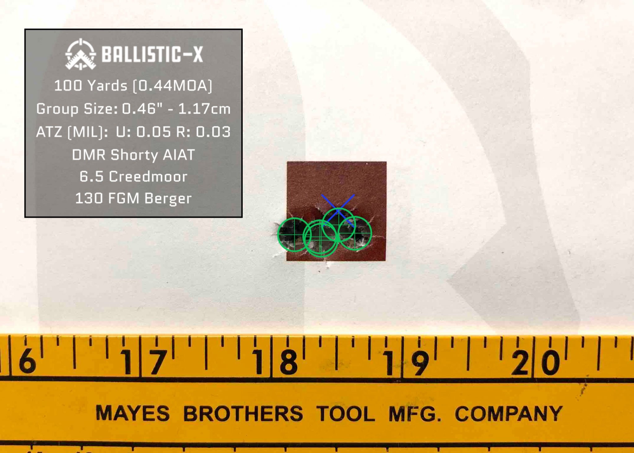

I finally got to try a box of the Federal 130 Bergers. The groups were a little tighter and the recoil did seem a little less, not that the recoil was much with the 140 ELD Match. I think I will give the Prime 130s a try.

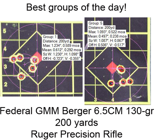

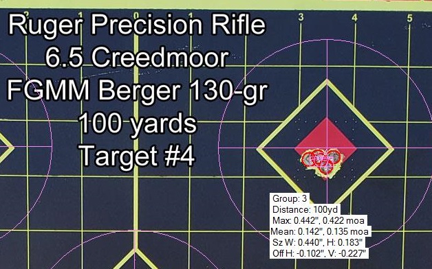

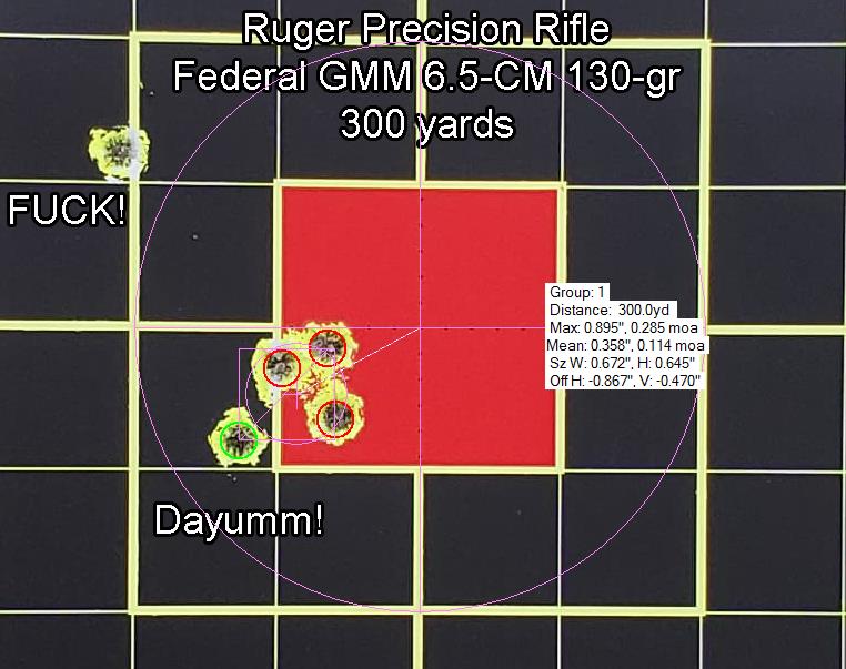

I've had some really nice groups with Federal Gold Medal Match Berger 130-gr in my Ruger Precision Rifle.
Even with the flyer, it was 0.757-MOA....

Hard for me to answer the question on consistency. It's at least as consistent as I am. :)
I have not shot it beyond 300 yards, though.
