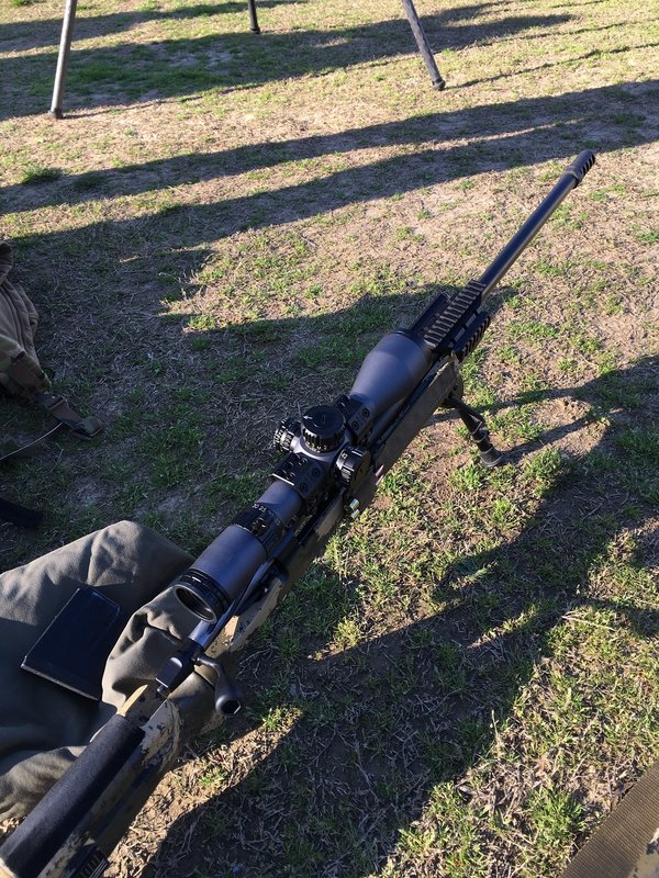

Shot this weekend at K&M and was fortunate enough to have Bryan Sikes as our RO shooting with us and helping us out. Awesome guy and shooter, couldn't commend him enough. I noticed a particular Bushnell on his rifle, to which i asked and he told me it was the new XRS, same glass as Gen II Razor and NF ATACR. So i assume LOW. Format is similar to the DMR II, though with half mil numerical indicator on the turret, instead of just a larger hash. Throw lever is integrated as well. I only looked through it once but it was substantially better than the ERS gen I i used today. This must've been what ETZoomin was referring to, which i suspected. A good friend in my squad also compared it to his Gen II razor and said it was just as nice. Now the big question will be price. Because if it's retail is below that of it's competition (Gen II razor & ATACR) you'd be hard pressed to find a better competition oriented scope for the money. I think Bushnell could be poised to shake the market up a bit. They'd be offering a solid line up from 1000/1200-1500-2000+.
Here it is. I didn't ask on the finish, but i assume it will be their black/FDE finish. Should've gotten more pics but we were running through stages pretty fast and i didn't pull out the phone much. IMG_1097.JPG

It seem like the parallax turret is unnecessarily large. Does it seem to anyone else that it's larger than the windage turret? I can't say I love that. Maybe I just have delicate sensibilities.
Fursniper
Captain, USMM (retired)
Feb 13, 2017
2,209
36
48
Arizona
#48
There's more "stuff" on that side to accommodate the illumination controls.
Feb 13, 2017
221
23
18
Seattle, WA
#50
Other optics companies have put the same "stuff" in the parallax turret without the kind of width that it appears to take up here. Maybe the angle of the picture makes it look more pronounced than it actually is though. It's not a big deal, but my preference is certainly for a narrower form factor. I don't mind the height of the elevation turret on an optic at all, or the size of the windage turret. It looks like the turret size in this optic is very similar to the Vortex Gen2 which is nice.
