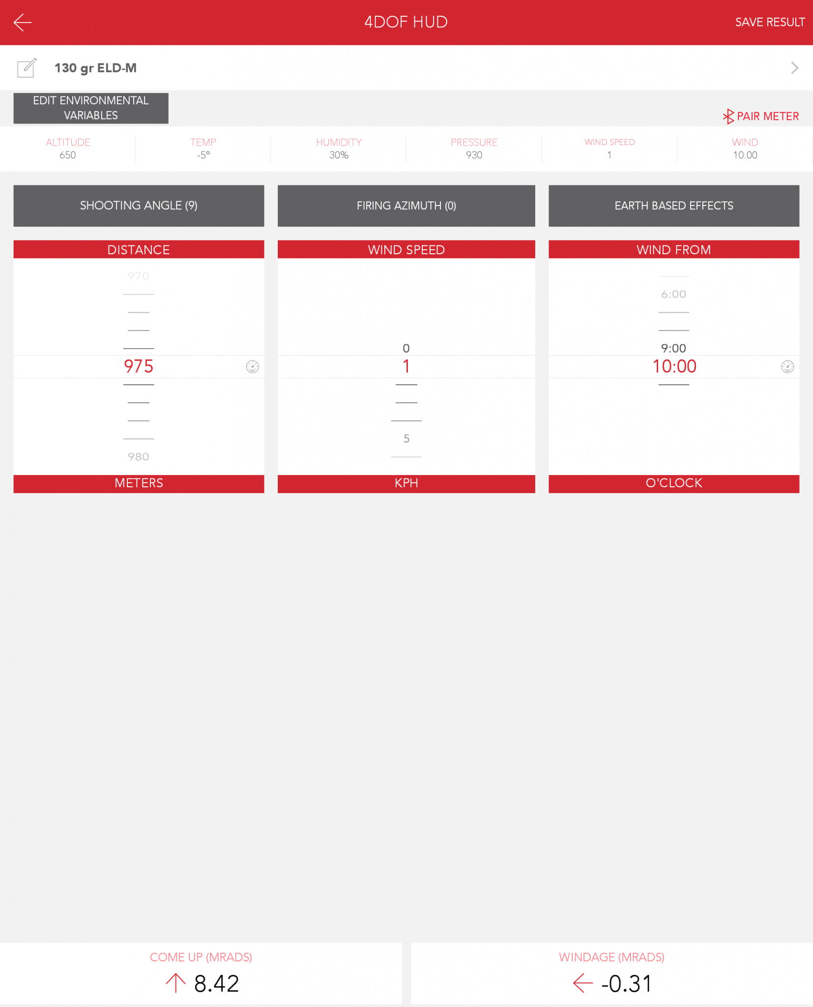

I entered your data into the 4DOF part of the calculator and was able to get pretty close (8.3 mils @ 975m). I had to adjust the axial form factor to .9 and then added a 10 degree firing angle - I assumed you were shooting up the hill not just down in the flat at that range. For what its worth, its attached.

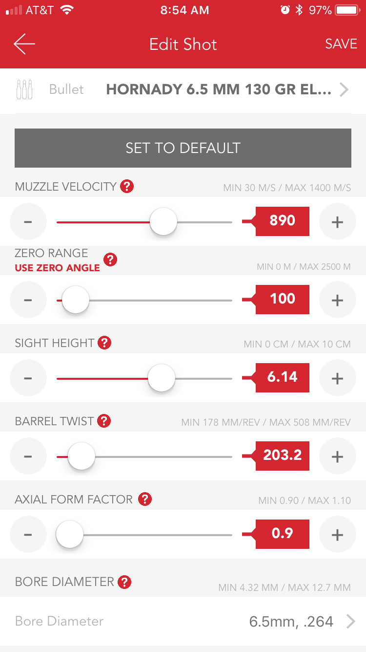

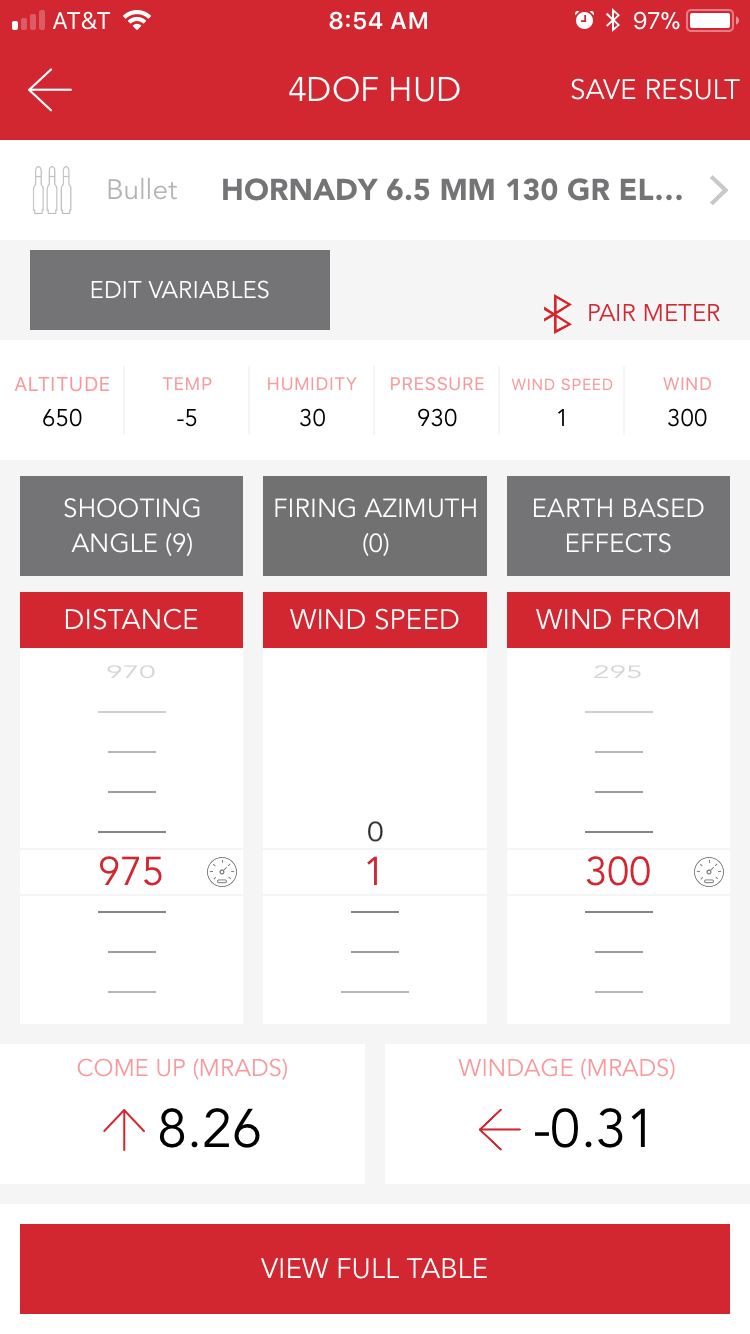

In your pic it looks like you are shooting uphill, is that correct? 4DOF asks for this info related to your scope at your zero range (zero angle) and at the target range (shooting angle).
Here is what I entered in the 4DOF calculator:
As you can see my dope had corrected for 9 degrees angle. I know my scope is zeroed at an official range at 100 meters and there is no angle between where I shoot and where I hit. I have not verified the tracking after it was new a year and a half ago. But my friend has a different scope so it is less likely that two quality glass is that much off.
As mentioned my real life dope was about 8,1 mrads. In the Hornady app you cannot addjust BC, but if I manipulate the velocity it would have been around 923 meters per second (3028 fps). That's 40 mps more than my dope. And that's not very likely since I have measured my velocity three times in the same temperature with a LabRadar. I wish I had brought the LabRadar at the shooting, but this was supposed to be just plinking and no scientific research 😊.
So the x factor here is still unrevealed to me!
As you see your dope differed from mine and only difference I see is the axial form factor. Why would that be .9? The firing angle was measured with a SIG 2000 to 9 degrees.

Changing scope height to 2.48 my app is showing 8.5 with the standard BC, adjusted BC to 580 gave 8.2 mil @ 1065 yds...not sure why/where yours had the 9.1 coming in but that seems high unless I converted one of your values wrong...like Steve mentioned above, could be getting some weird winds in the mountains also
I don't spot the difference in the input between our different results.
The result is reproduced four times. But all four on the same range. So it is possible it is the same type of wind making tricks with the bullets here.

Slight velocity bump and tweaking axial form factor to .9 gets really close...does this match your app with these inputs?
If I stay on the speed of 883 mps I get nearly close to your result:
That is closer to reality of the dope I observed. Can you explain this axial form factor? I read what was written in the help section but I am still not sure I understand the science behind it.
Axial Form Factor is Hornady's way of adjusting the custom drop curve (instead of changing BC value). Because the 4DOF calculator is not using BC, it allows you to customize the calculator to match your actual dope.

Also, I would like to add that I just input all my data into Hornady's 4DOF app and it exactly matches my dope from today. Pretty awesome. I may use their app more in the future instead of Strelok. I did not mess with axial form factor and left it at 1.

With all environmental data correct in Strelok and all other inputs correct the closest G1 B.C. that produces these drop numbers is .623. In Strelok Pro the G7 B.C. works out to be .298.
I did the same yesterday, and my data match a BC at .625, pretty close to yours. Cool to see that you get similar results as we did. Thanks for sharing.
And the results as started this post are verified. I still have to set the axial form factor to .9 to get the my dope in the Hornady app.
