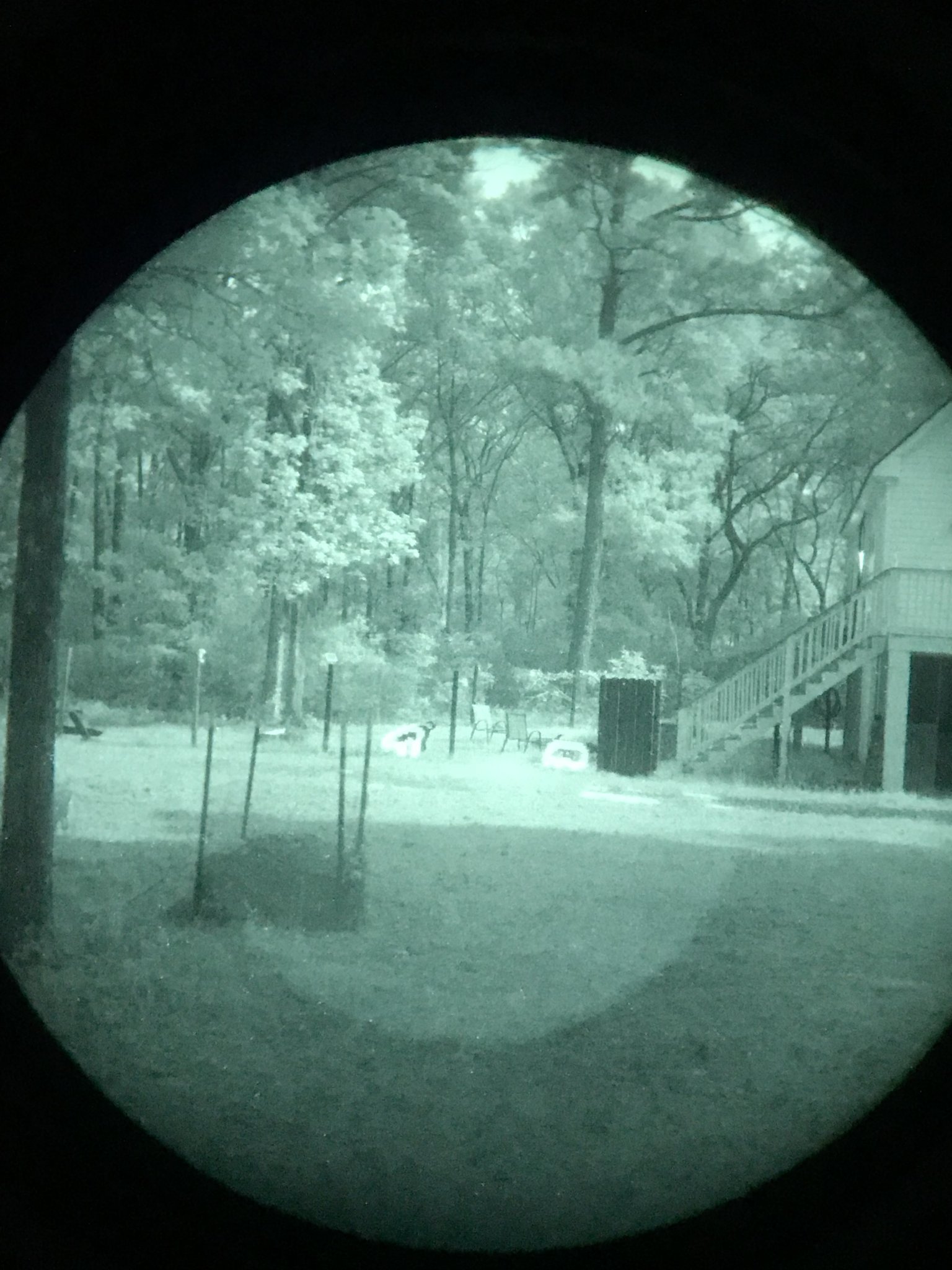

Best I could do for the moment, dogs in the backyard with AN/PAS-29A COTI and L3 UF WP tube.
It was pretty bright tonight, and the COTI does not photograph very well, and the dogs didn’t really want to cooperate...
Range is about 35 yards give or take, dog on the left is about 30lbs, and the one on the right is about 10lbs.
Will try to get better photographs later this week at a training event, but figured something was better than nothing.
~Augee

Is it just the photo, or the combination of WP and the Coti? Because I only see a hard to see white blur where the dogs are supposed to be.

The photograph is pretty bad—night vision doesn’t really photograph all that well, nor does the COTI, the naked eye visual is much clearer and cleaner.
Moreover, the setting that the photograph was taken doesn’t necessarily highlight what the COTI is most useful for, it was just what I was able to take last night to give a general idea of what it looked like with an UF WP tube.
