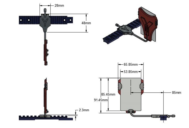

The BLAMM is used a lot but the Yow-Tech has a few differences. Toolless snap on to rail that can be removed between stages. Adjustable bendi thing length and slide in cards that can prepared ahead of match based on COF. Last difference is the pen is eraseable ink with eraser.

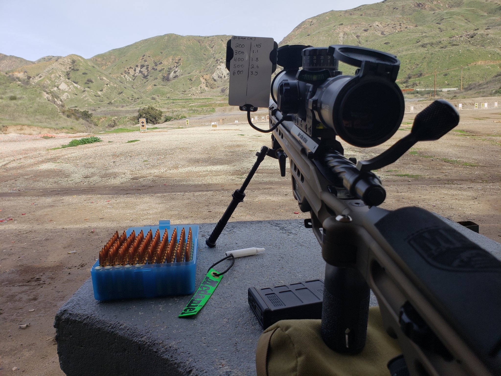

Dope Card Holder review:
Charlie sent me one of his dope card holders to try out and post a review.
I received it at the start of January and have been using it while building a new rifle and getting the dope dialed in as well as using it in a couple matches this Feb and March.
Compared to my homemade solution, this is a much slicker product!

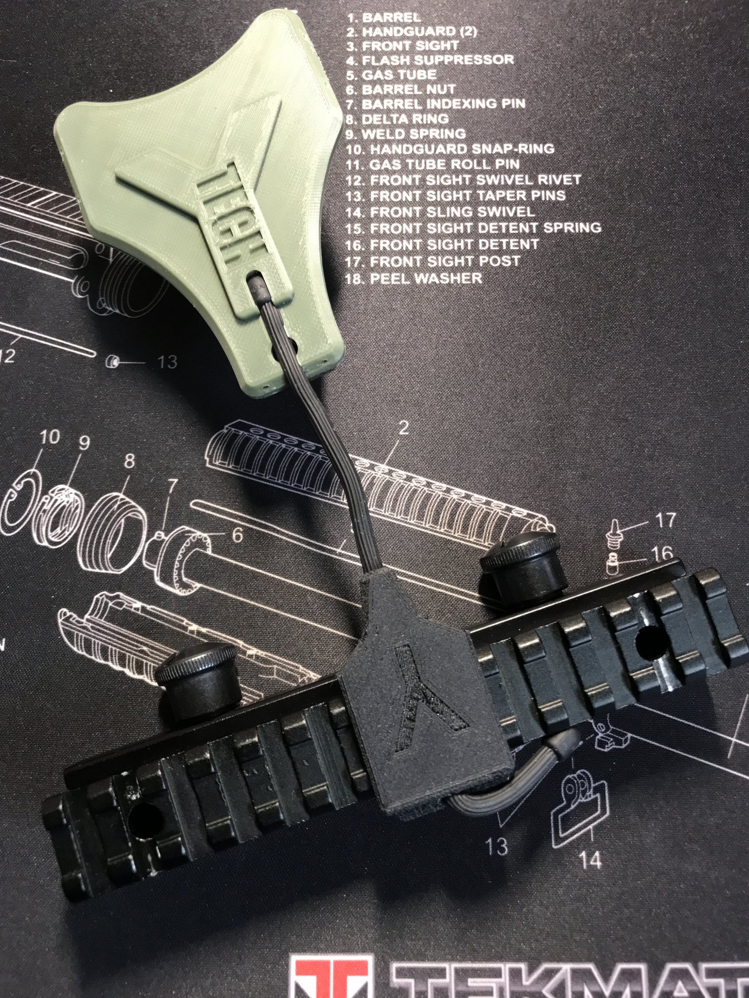

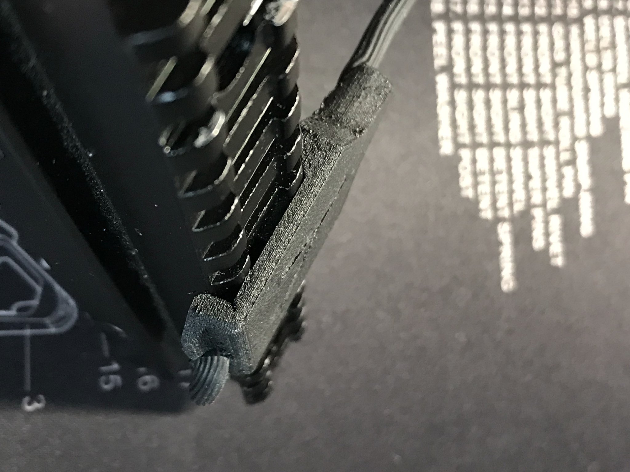

The picatinny attachment point snaps on easily and has never popped off. It stays on after taking the rifle in and out of my drag bag style case for the last couple months. No issues at at. If I want to take it off, it pops off quick and easy.
Flexible arm:
The rubber bendy thing works great. Place where you want it to see while shooting and it stays put. Bend towards rifle to store in the case.
Threading the bendy wire through the picatinny mount is a MUCH cleaner way to mount than my old solution of wrapping it around the scope.
The bendy wire protrudes through the picatinny mount a little which I thought was weird when I first saw it, but as soon as I used it, it became clear that this was on purpose to give you something to grab to easily pop the picatinny mount off the rail. Clever.
Card holder:
Looks simple, but after using for a while, it is clear that some thought was put into this.
The cards slip into and out of the holder very easily, but will not fall out regardless of the orientation of the rifle. (upright, sideways, upside-down)
The face of the holder does not rub against the back of the card when sliding it in or out which is important to keep from rubbing off any dope information that is written on the back side of the card.
Cards:
These are a nice size and the non permanent ink stays on them very well. The front and back are the same so you can use both sides. You have to rub the ink pretty hard with a sleeve or tissue to get it to come off. This is good so that your dope doesn't come off if the card rubs against things.
The ink comes off much easier if you spit on it or use a wet tissue.
This is good and bad because using it in rain could be an issue. Water drops don't cause the ink to come off immediately, but if anything touches or rubs it when wet, the ink gets messed up.
An easy solution that I have thought about, but not tried is to put a little clear plastic baggie over it if using in the rain. I saw some others here talk about possibly using a wax pen... haven't tried that either.
I got three cards with my dope holder. This is good for six stages if you write on front and back of each card. It is nice to write the dope for each stage on the cards ahead of time.
I suppose you could put dope for more than one stage on a side of the card, but I would rather not to make sure I don't make a mistake in the heat of shooting a stage.
I looked on Charlie's web page and it says the dope holder comes with 5 cards now, so that should be plenty for any match. Most of the ones around here have around 8 stages.
Pen:
Simple non permanent, erasable pen. The one thing to comment on is that it has a nice, fine tip to make the dope easy to fit on the card and still be readable.
Overall, I am very pleased with the dope holder card!
I have every intention to use it for this (and many more) seasons of match shooting.
It is much quicker than looking at dope on an arm band for me.
Thanks again Charlie for giving me this dope holder to use!! I hope the feedback is useful to you and others looking for a place to record their dope.
I'd highly recommend this product to anyone looking for an easy way to read/write their dope!
Cheers,
Mike
Reactions: Yowzilla
