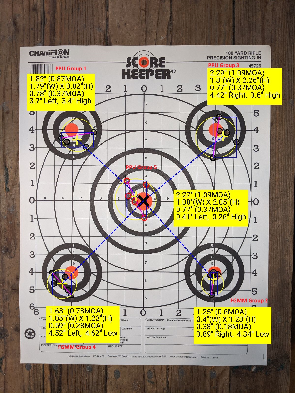

FGMM is very competitively priced, and IMHO, is still the Gold Standard. I also believe that handloading may save you a bit of money, but I haven't been able to handload more accurate (generically) ammo than FGMM, and I really don't think I ever will.
Should accuracy at 100yd matter? Accuracy always matters, but it matters more as distances increase; least at 100yd. The important factors here are cost and consistency. As answers go, IMHO; FGMM leads the pack.

Posted this on my other thread, but went out to try to make sense of PPU vs FGMM @ 200 yards and keep getting enough groups to build out a better picture. Alternated 5 shot groups. Always aimed at dead center and dialed for the groups, until the last group in the middle. Shot 3x5 PPU and 2x5 FGMM. It got dark on my last 2 groups.
Maybe all the variances are the small SD in velocity. If let's just say PPU was +/- 50fps, that's a half mil up & down + variances of me as a beginner shooter. I did nearly shoot a clover almost with FGMM, that'd been pretty cool.

Quality ammo matters, longer the distance the more it matters.
Practice does not make perfect, perfect practice makes perfect.
Every time you change propellant / jacket material, takes 3-5 rounds for barrel to settle down. There is a reason service rifle guys try to run a single powder, jacket material. Your test of alternating PPU / FGMM for groups did more to muddy the waters than not.
First 5 rds @ 100
Second 5 rds @ 200
Third 5 rds @ 100
Stock 700, 5R, 20”, 223, isn’t even bedded.
Berger 73 Match BT, virgin brass
Ammo matters if you want to learn, not guess what is happening, IMHO.
