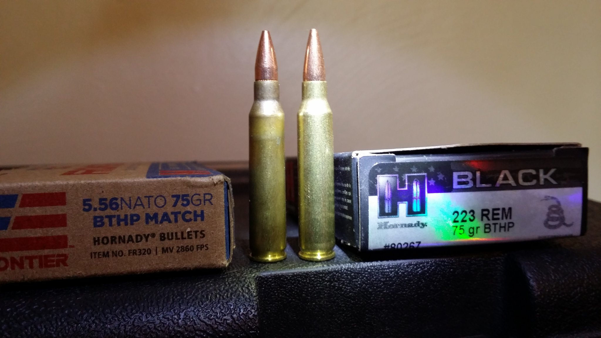

So these are the 2nd rounds Ivery found for good prices that my gun shoots well. Both supposed to be 75gr Hornady BTHP but they look different to me. The Black bullet looks like it would have a higher BC than the other. Anybody know what their using in this Frontier ammo?
20180604_163124.jpgSupposed to be Lake City production with Hornady bullets. The open tips on the Frontier bullets are a lot less even that the Hornady Black. The Frontier definitely has more MV because it's 5.56, about a Mil higher at 100y.

Your right. haven't tested to see if the Frontier once zeroed requires less dope like 500 and in. No chrono for me yet.
But isn't 5.56 usually hotter as a rule of thumb? Gun has an 18" barrel, truing my Hornady Black dope with Shooter, from 400-800 gives me about 2550 corrected. Haven't shot the Frontier out to distance enough to gather dope.
Just trying to figure out what the difference is between those bullets. The Frontier shoots well enough it's going to be my plinking ammo. Black shoots better.

The first rule of thumb regarding factory ammo velocities is to ignore all rules about thumbs. Typically real 5.56 Nato is hotter but there seems to be a lot of 223 ammo with 5.56 stamped on the box. A chrono really is the only answer.
You're right though, those bullets look different but I'm only aware of two different Hornady 75 BTHP Sku numbers, and its just the same bullet with and without a cannelure. Weird...

The frontier does have the cannelure but they still look to have different ogive profiles. Guess I'll just shoot the frontier to gather dope, true muzzle velocity and call it good. Not like Ill be shooting much past 800 with these rounds anyway. The black did well last range trip from 435-825.
Last target at 998 no joy, a few splashes spotted but mirage was heavy and I'm not sure how that bullet handles going trans.

Here is a pic of my 75 BTHP Steel Match ammo. Looks more like the Black profile. There is definitely a different bullet in the Frontier line as even the BC is different and listed at .355 vs the 75 BTHP .395 BC.

Most has been covered, but T2 (with cannelure) vs. non-cannelure 75 hpbt profile, different ogive radius. The T2 (with cannelure version) has the same or very similar nose geometry to the lighter weight .224's (50-55 vmax, etc.). Can be a little easier to get to shoot because more bearing surface is in the throat. Case head to ogive numbers will be longer on the T2. Frontier is Hornady bullets loaded @ lake city.
eta: 2860fps is likely from a 24" accuracy test barrel.
