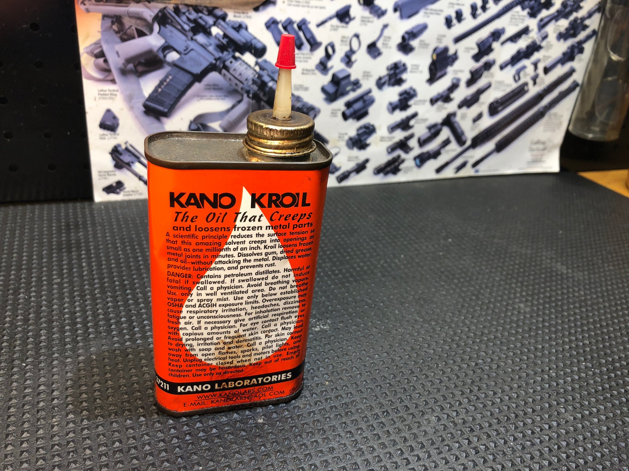

Most thread locker's e.g. Loctite's Blue / Red / 620 are anaerobic cyanoacrylic adhesives that stabilize (cure) when the threaded fasteners are mated together - these types require various levels of thermal release to break the chemical bonds; other's such as Nyloc and Vibra-tite VC3 are quite handy as they form a stiff compressible fluid on the threads for repeated installations - these types of adhesives are not subject to release by hydrocarbon oils, nor do they require heat to remove / release the fasteners. Kano Kroil ("the oil that creeps") is the industry benchmark (Liquid Wrench / Blaster etc.often incorrectly offered as an equivalent ) for dissolution of age dried oils, rust etc that have frozen fasteners and its use does not involve thermal application nor does it have any usefulness on releasing thread locker adhesives. Finally, thread adhesives such as Rocksett are silica-based adhesives that require 1200-2000 degrees of heat to release, which is why it is often recommended as a "thread locker" for muzzle brakes / suppressor applications as these mounted accessories can almost get that hot with rapid firing. Rocksett is released by the simple process of submersion in water for a period of time, NOT heat application, as it would require such high temperatures as to alter the metal tempering of the parts.

Most thread locker's e.g. Loctite's Blue / Red / 620 are anaerobic cyanoacrylic adhesives that stabilize (cure) when the threaded fasteners are mated together - these types require various levels of thermal release to break the chemical bonds; other's such as Nyloc and Vibra-tite VC3 are quite handy as they form a stiff compressible fluid on the threads for repeated installations - these types of adhesives are not subject to release by hydrocarbon oils, nor do they require heat to remove / release the fasteners. Kano Kroil ("the oil that creeps") is the industry benchmark (Liquid Wrench / Blaster etc.often incorrectly offered as an equivalent ) for dissolution of age dried oils, rust etc that have frozen fasteners and its use does not involve thermal application.
Thanks for the very informative post. I'll guess that we stumbled on an area that you know well. 👍

I use kroil for cubrication and general cleaning. electronic parts cleaner for the hard to reach parts or AR lowers that was suggested in a previous post I made a few months back. Carbon killer and lastly white Gas to soak stuff in.
