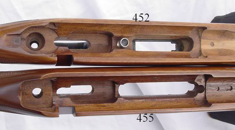

#5
Thanks for the pics. Seems the 452 has a third action screw. No dice then.

The wood screw is the front screw on the 452.
In a chassis, you might be able to get away with drilling the extra hole right behind the mag and be good to go. The two mag wells look really close.
It looks like it's doable. Maybe hit up some of the CZ nuts at rimfire Centra to see if any of them have done it
Any pics of the chassis your looking at? You would have to counter bore the back screw hole to handle the dovetail nut for the 452 also.

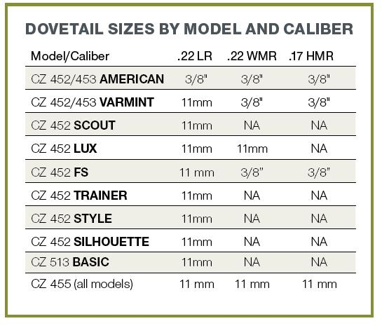

As a lefty, my only option with CZ is the 452. With all the options and accessories seeming to be geared towards the 455, I'm curious whether the 452 would drop into some of the chassis options for the 455. I'd have to modify the chassis to accept a lefty bolt but I'm more curious as to whether they would be compatible.
Thanks
I haven’t found a good option for 452 lefty stocks. I ended up bucking up for a vudoo barreled action.

The European 11 mm rimfire dovetail is universal. Whatever fits one will fit all. That includes the 452, 455, and every other European made rimfire. Yes, the Tikka T1X too.
I just picked up a used Area 419 scope rail for the CZ 455 to try on my CZ 452. The dovetail on the 452 is NOT the same as the 455. The Area 419 rail for the CZ455 does not fit the 452. I guess I'll have to give the EGW a try.
Proves nothing since I bet Area 419 does not have access to the 11 mm dovetail drawings with dimensions and tolerances; and instead measured a couple of samples of the 11 mm dovetail to reverse engineer it into their rail.
When you do that, you inevitably are going to find that your part doesn't fit everywhere it should because you have no idea where the samples you measured were in relation to dimensional tolerances.
The rail on my CZ 452 is not 11mm it is 3/8. I noticed that EGW makes a 3/8 and 11mm Rail for the 452. There must be variations in the dovetail, hence EGW making two different variations for the CZ 452.
CZ stupidly made the 452 and 453 American and certain calibers of the other 452 and 453 models with 3/8" US standard rimfire dovetails.
They fixed the problem with the 455 and now 457, where the 11 mm European standard rimfire dovetail is the only one used.
Great info. I sure wish they would have made the american in 11mm I really like the Area 419 rail vs the EGW.
