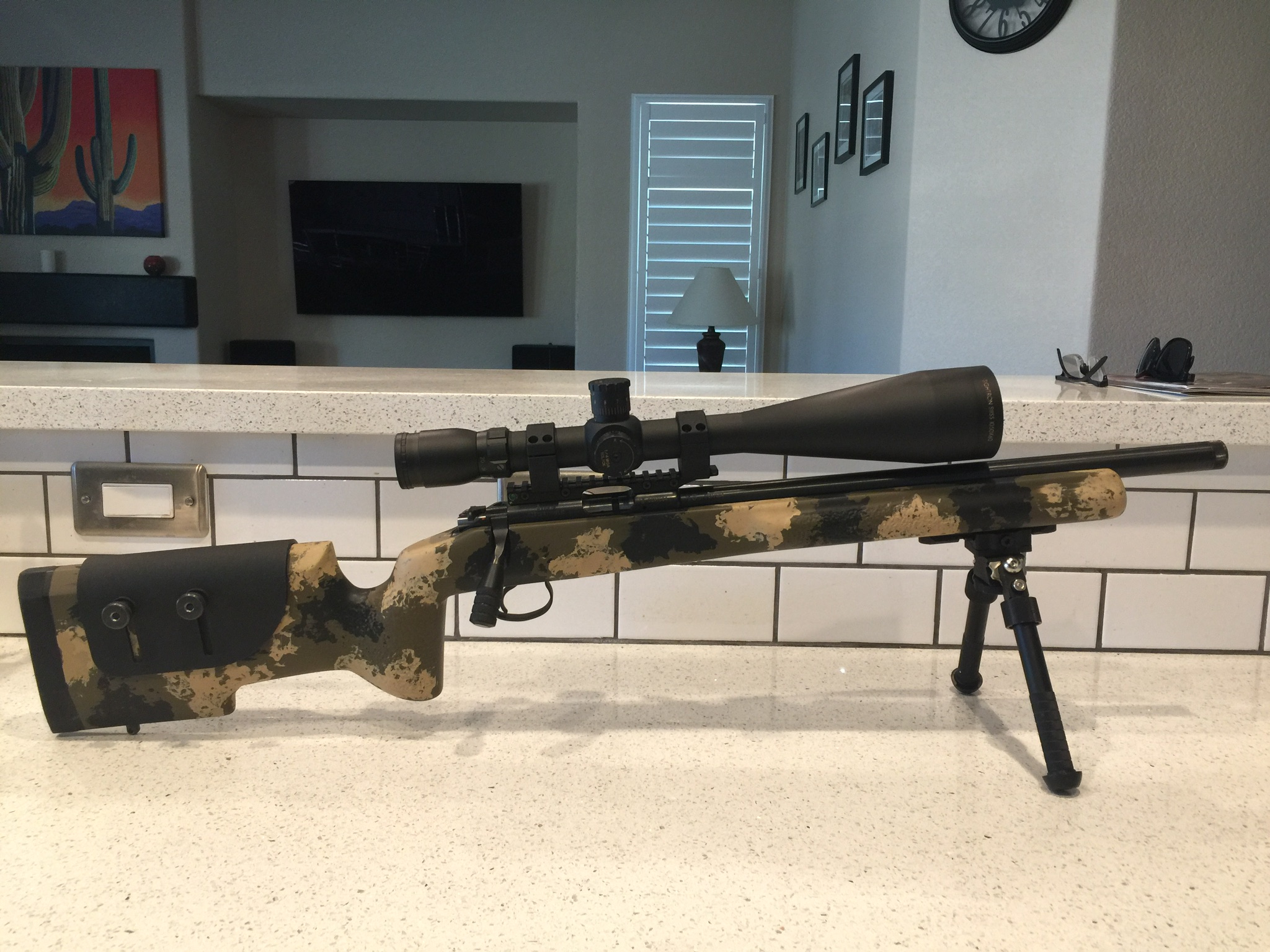

Would you happen to be able to tell me how high the 419 is? I'm looking to put a 56mm objective on my Trainer and wondering if 1" (height) rings will work. I cleared a 60mm with 1.18" and a the DIP rail. So I assume I will have plenty of room.
I use the Area 419 and medium Vortex Precision Rings and my Sightron SIII has a 60mm objective and it clears. I think the vortex medium ring height is .89”

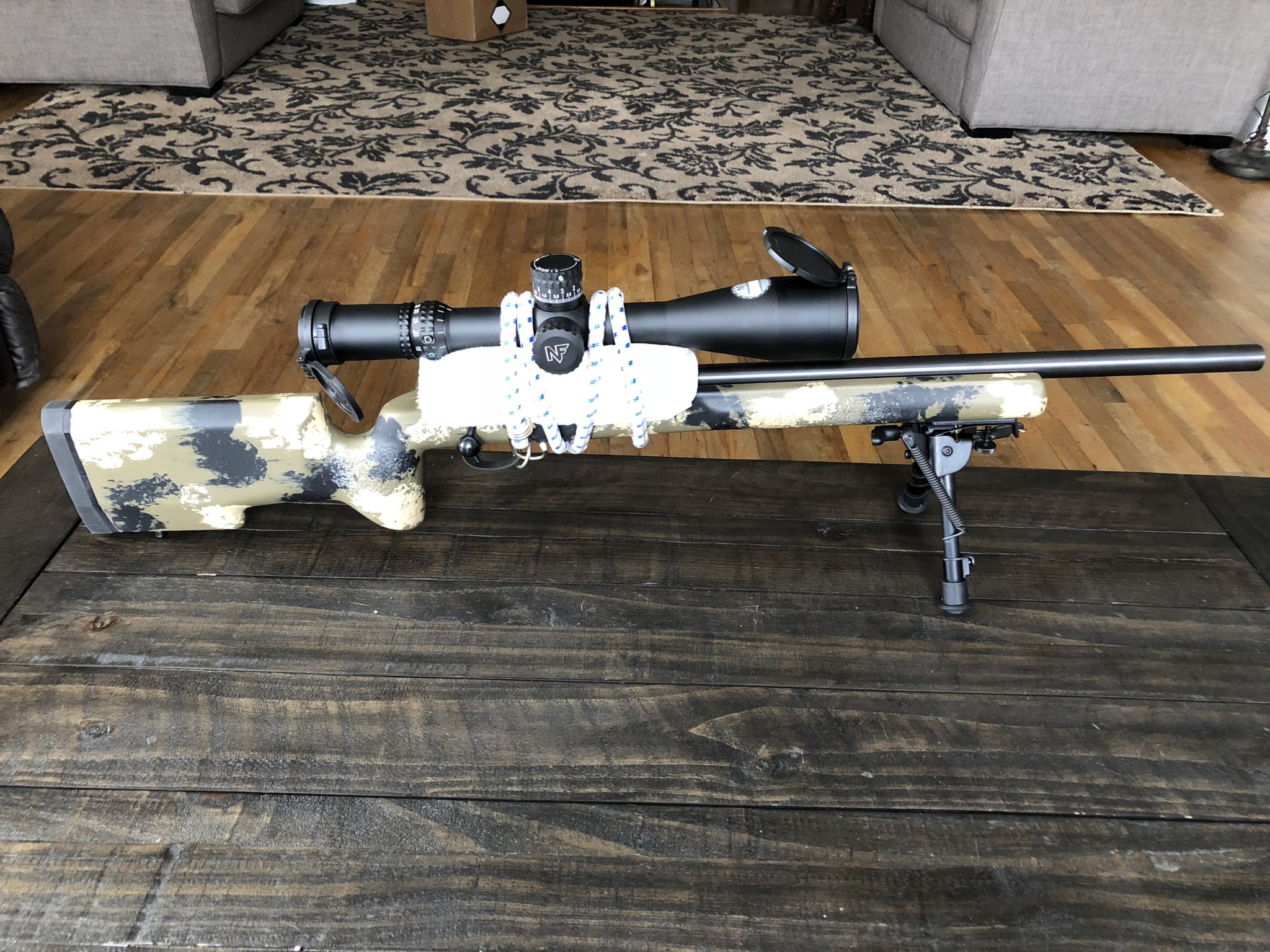

Ordered a 15 moa. Although 3 Kirkland diapers seem about perfect as long as you apply the correct amount of tension to your bungee cord 🤣850207AE-AA7E-480E-B916-44F6F4842988.jpeg
