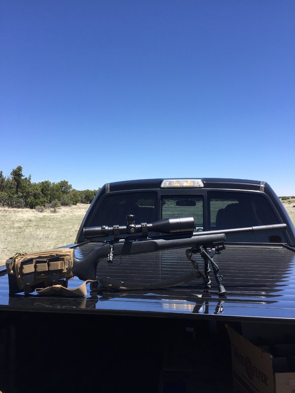

I have the 455 with the Manners stock. Only things I added were a Timney trigger, Lilja barrel and Vortex 4-16 FFP.
With Lapua Center X I normally warm up with 5x5 groups at 100 and can average well under 1". Then we start putting 1-2 MOA targets out and do UKD drills which for a 22 can be quite tricky as even a 2-3mph at 200 yards+ will make you miss.
Have been curious what it will do if I have it bedded or anything else looked at by a gunsmith, but think its just splitting hairs at this point.

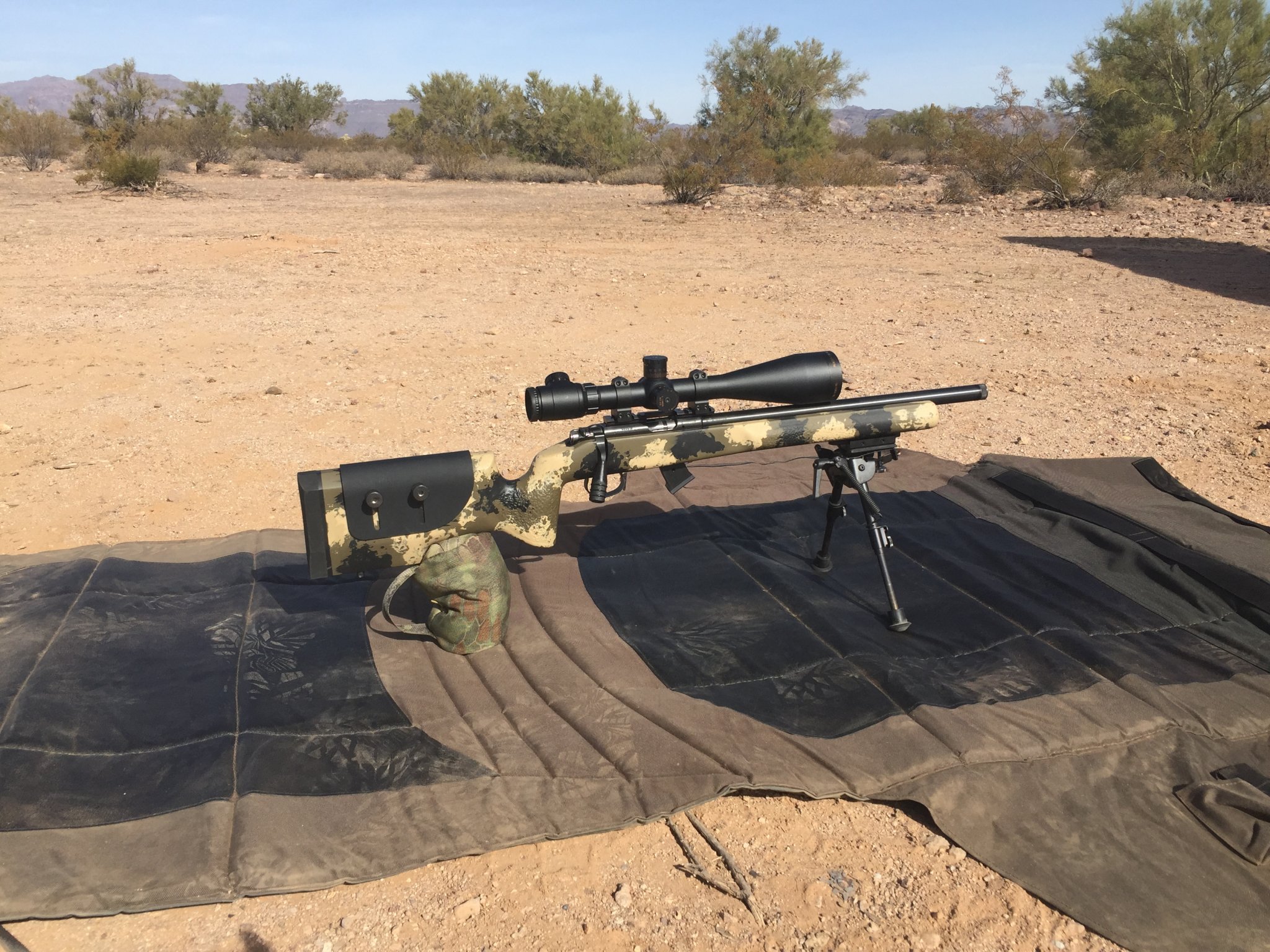

I like my VPT the Manners stock is awesome.
