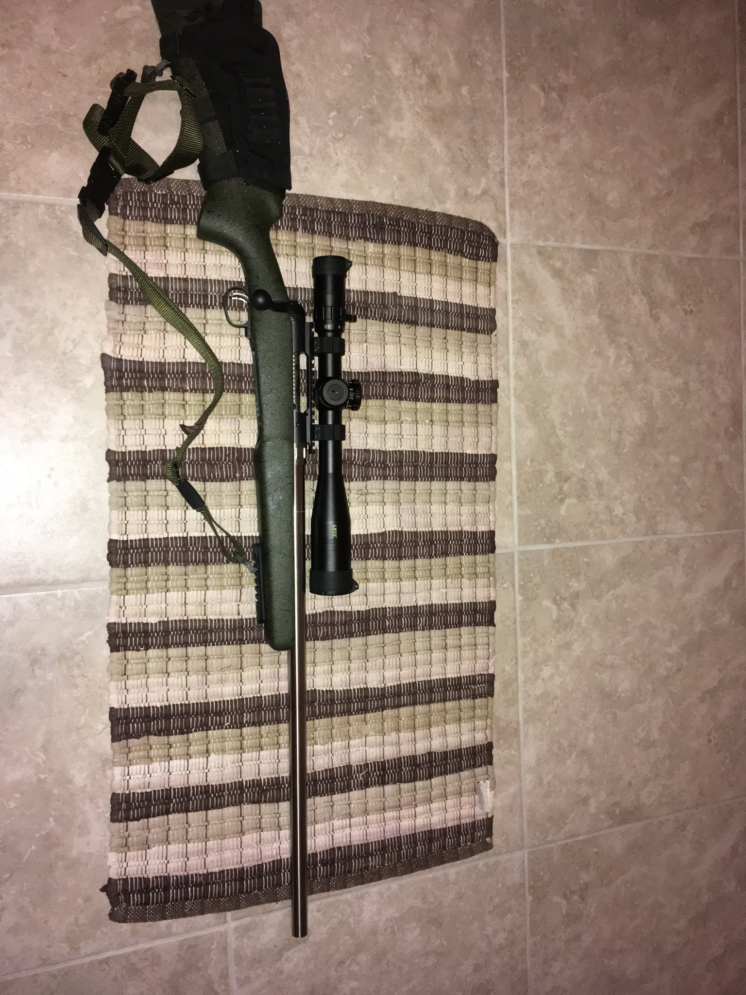

I have a Savage model 10 with a 26” Criterion barrel chambered in 6.5 creedmoor. I’m planning to cut the barrel down to make it more maneuverable.
It’s a backup gun, but I use it to introduce friends and family to long range shooting. I had long range hunting in mind when I put it together, but it really only punches paper and steel now.
I’ve done plenty of research and am leaning towards 22”, but would welcome suggestions. I don’t reload and plan to stay with Hornady 140 eld match ammo. I won’t be threading the barrel, it will have a recessed crown whatever length ya’ll help me decide on.
Before pic:

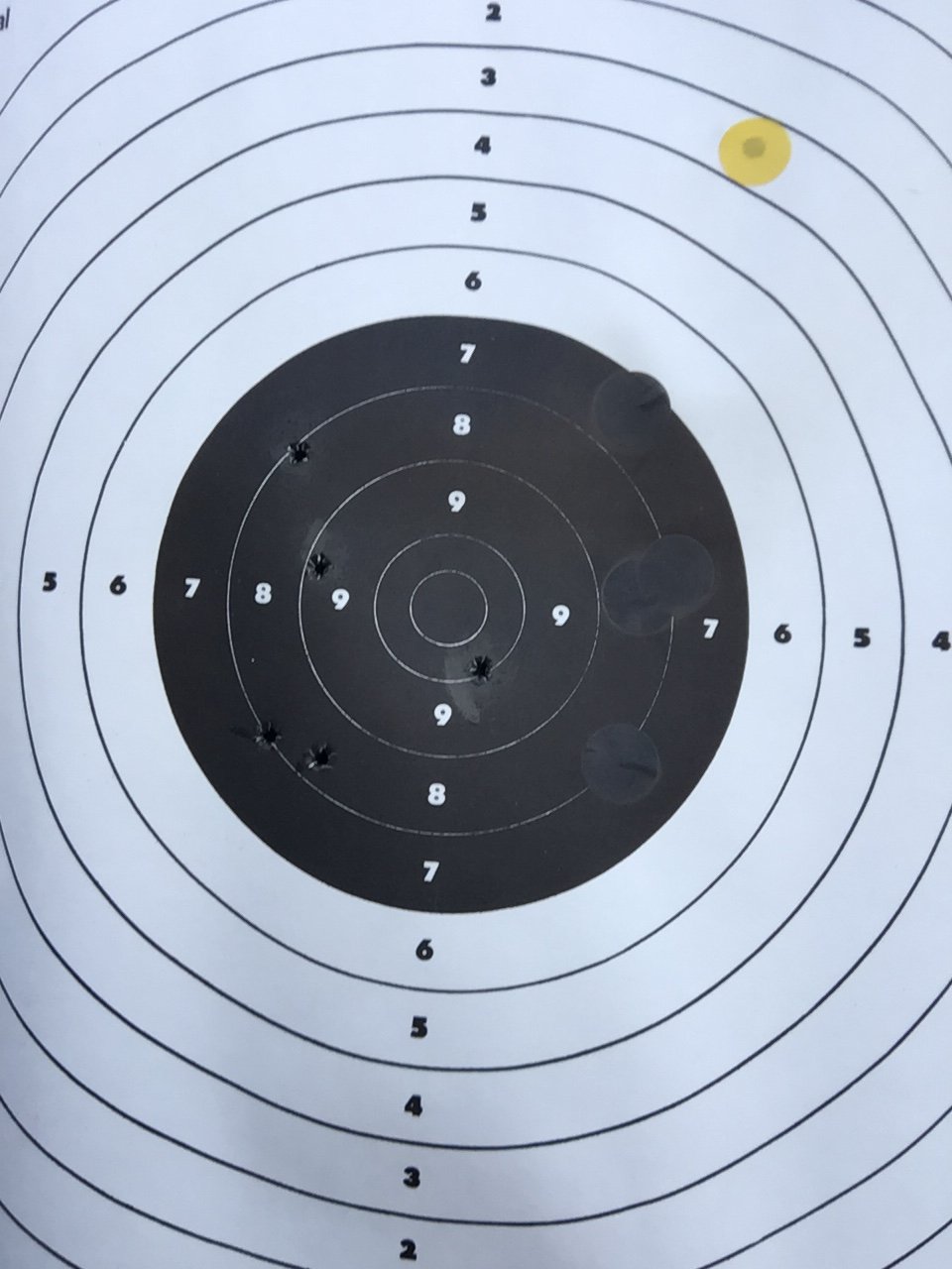

This rifle shoots pretty good, it’s absolutely not one of those record setting criterion barrels though. I hope it tightens up a bit with a shorter / more rigid barrel. It Shoots about 3/4 moa today, sometimes better almost never worse. I’m just not content with it, so I’ll stop dropping my other guns and hopefully see a positive improvement!

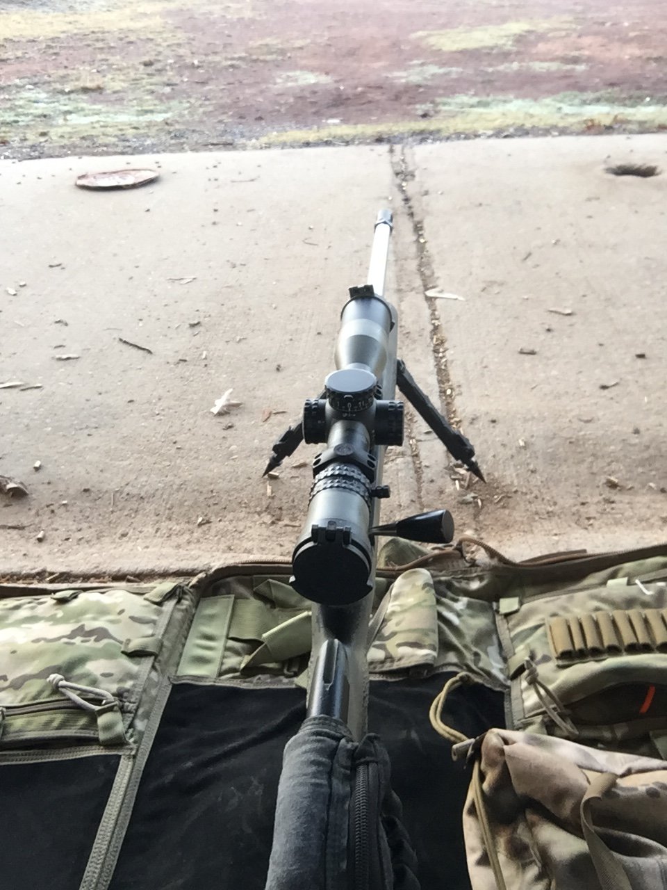

Alright, I just picked up the barrel and installed it. Thanks for the info guys, I ended up going 20” and I like it!
