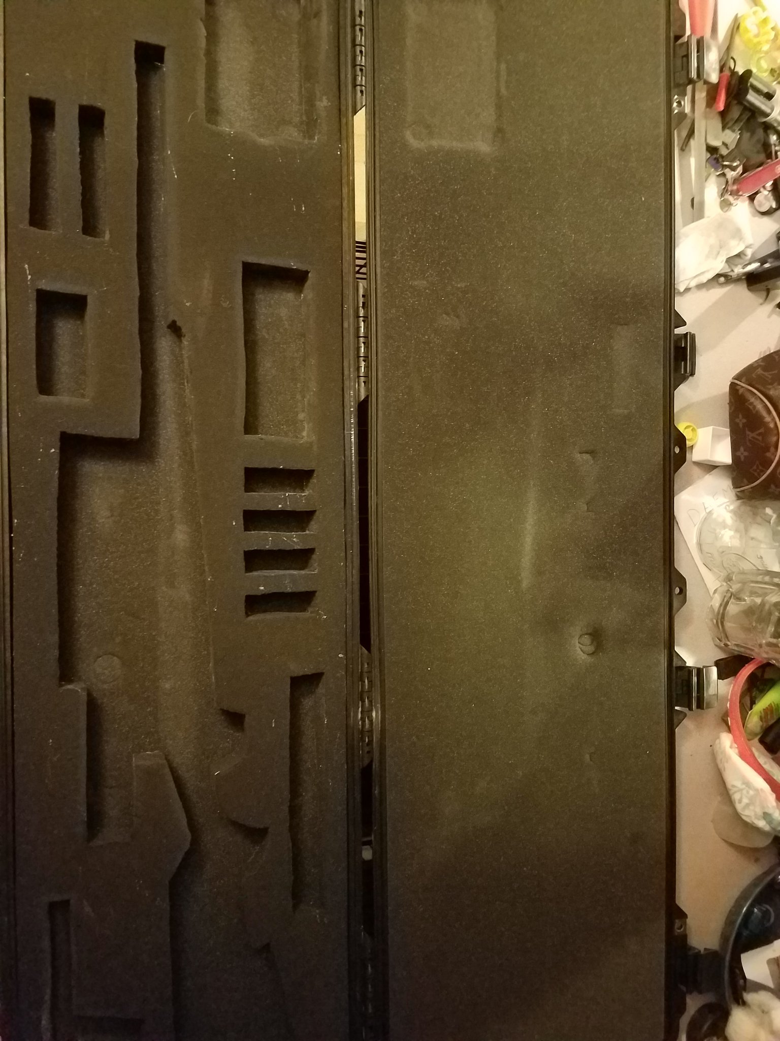

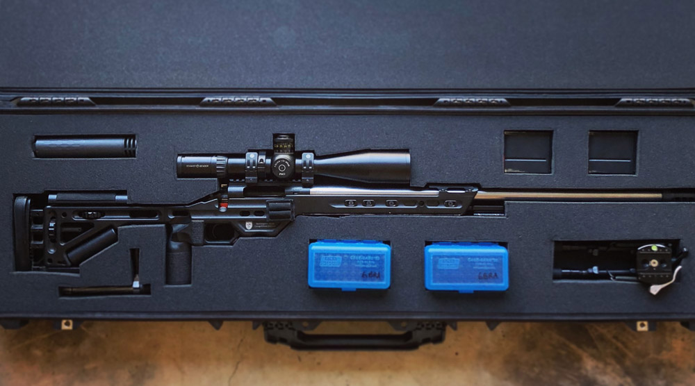

How many of you guys have had custom foam work/cutting/layouts done for your hard cases? Who did you use and what was your experience like?
I came across a thread a while back on here where someone had got some custom cut foam from Cobra Foam Inserts so I decided to give them a try. Well 7 weeks later and still no foam. And it was just a single piece of cut foam. Not like I ordered 14 different configurations. And I have to chase constantly for updates and I keep getting the.....
Needless to say I'm quite disappointed in my experience with them thus far. They have offered me a refund when I last tried to get an update but at this point I feel like I'm committed to riding it out unless I have a better alternative. Which brings me back to my question for you guys.
What other companies have you used for Custom Cut foam work for your rifle/gun cases what was your experience and average wait time for your order? At this point I'm ready to get a refund and move on as I have zero confidence that I'll ever get my order but I at least would like to have another option I could go with first before cancelling.

Lol I know @spife7980 , I tried that last time and it looked like Michael J. Fox had cut it blindfolded. Maybe practice makes perfect and I'm not opposed to trying that again but those layouts that are Lazer cut look so freaking clean. Saving the freehand method as a last resort for now.

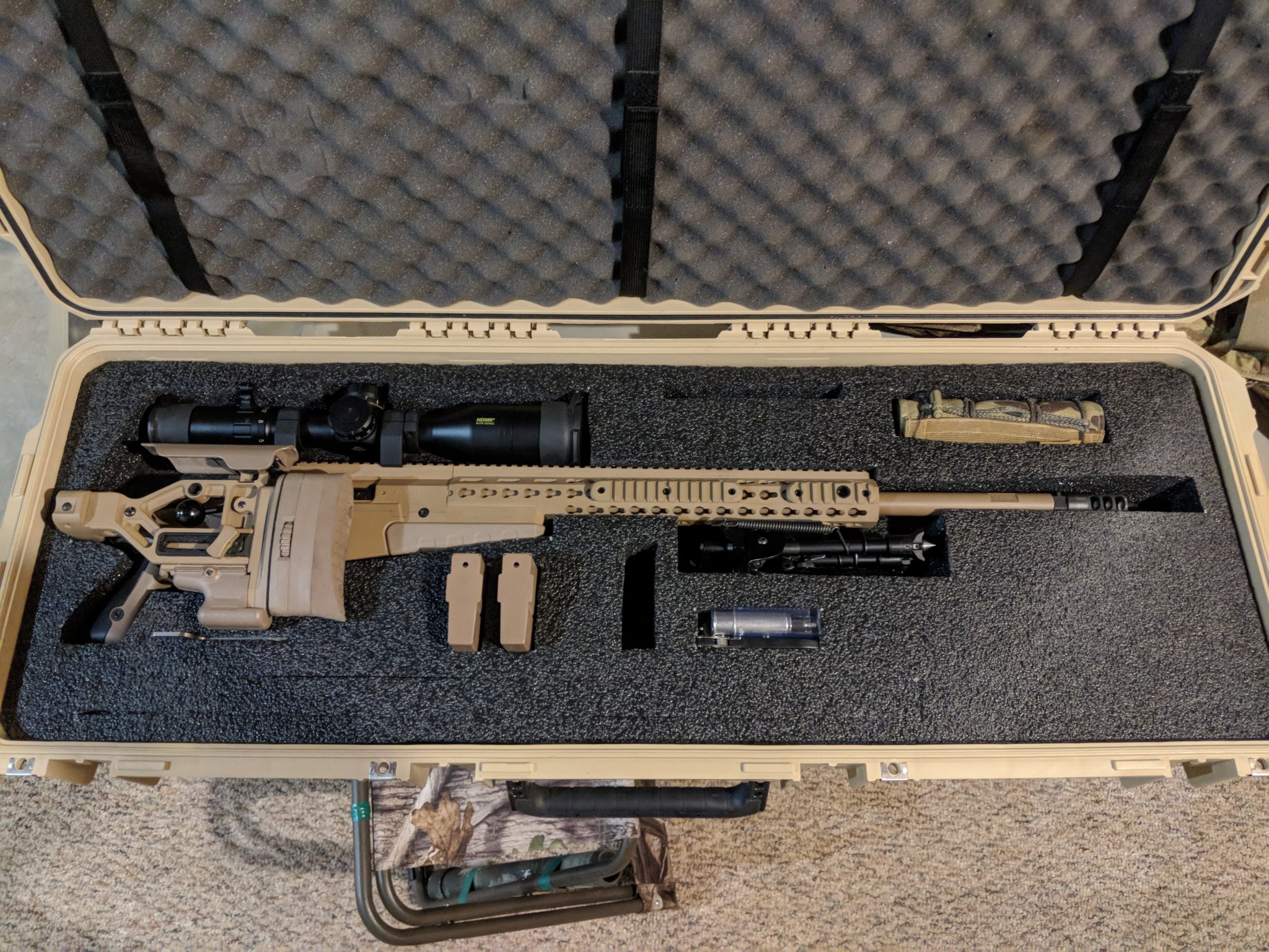

I did mine and it turned out very clean looking. Get one of those utility knives with the extendable snap off blades then run it out as long as it will go. Use a straight edge to guide the blade path and keep the knife vertical. You'll have to change the blades often, I only got about 2 foot of cutting before the blade dulled enough to not cut the full thickness of the foam smoothly with no tearing. Went through a whole pack to cut the layout for my pelican but it turned out good.

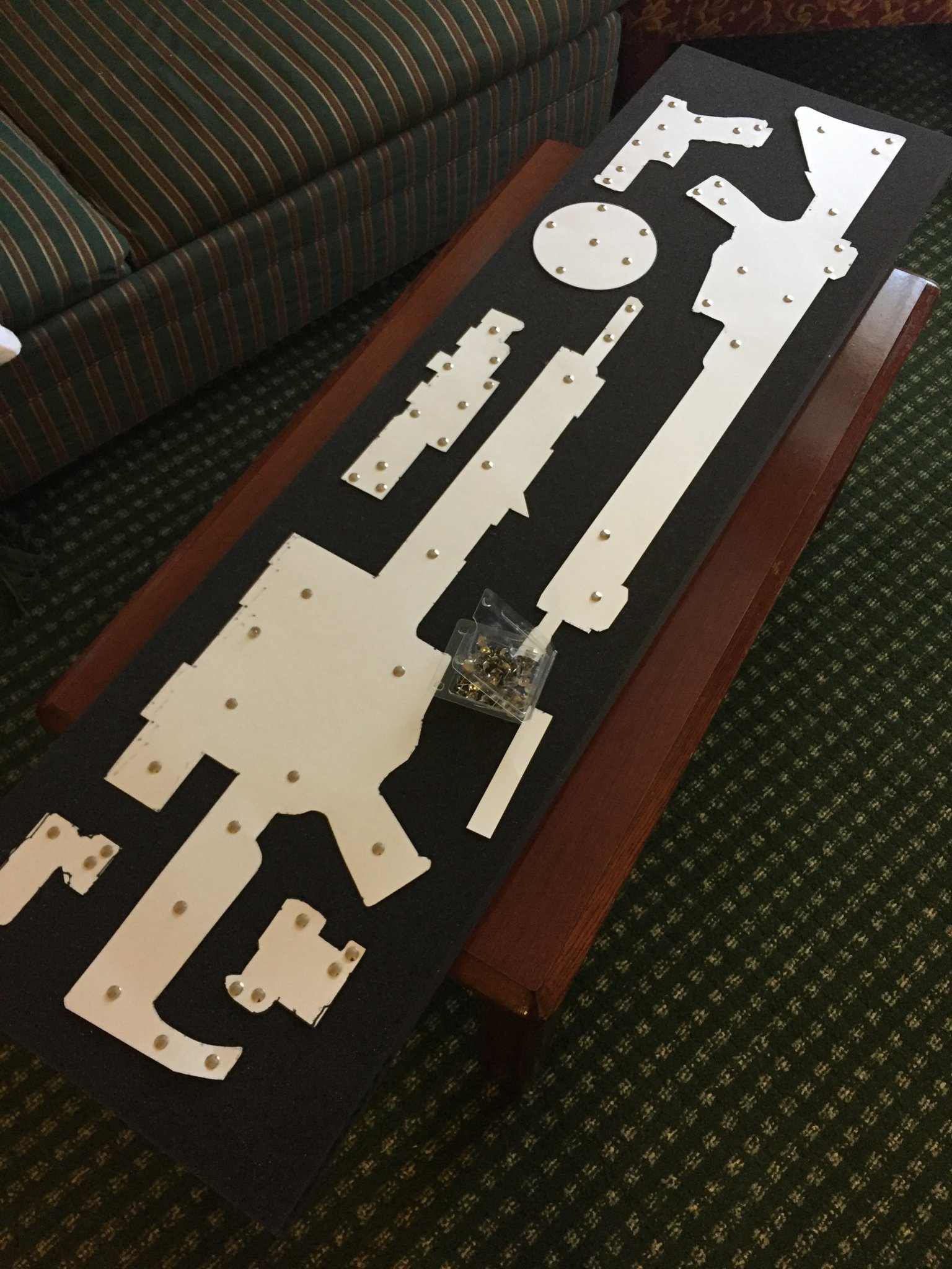

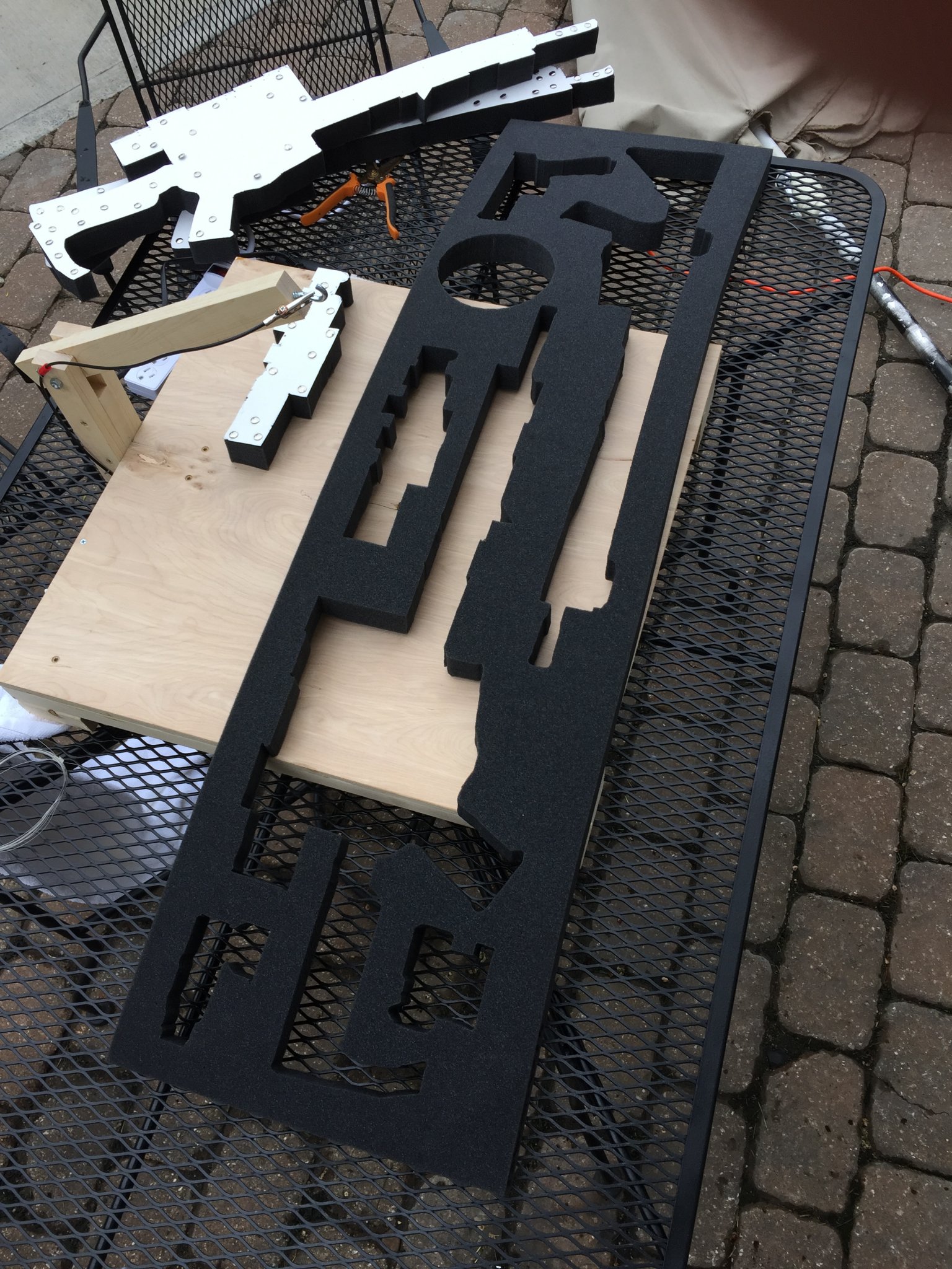

You can build a homemade hot wire cutter with some wood, transformer and wire. Directions can be found online. Once built I trace my gun on some poster board, cut it out and tack it onto the foam so it doesn’t move and then follow the cut out with the hot wire. Works excellent and can be done for maybe $30-40. You’ll then have the machine to cut foam for all your different guns and changing set ups.
Here’s some pics. The homebuilt table allows you to easily move foam around with both hands to get an even cut.

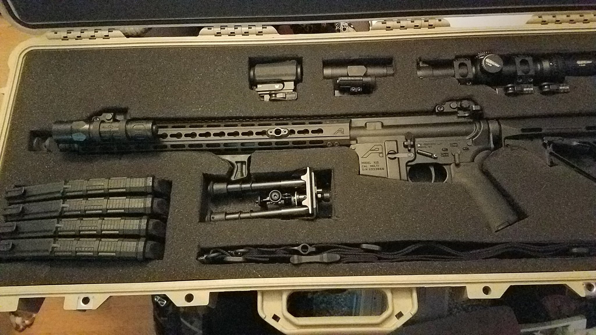

So finally got my Cobra Custom Foam (total of 8 weeks)! Funny enough, the same afternoon I ordered 2 foam sheets from Amazon to cut my own I got the shipping notification from Cobra. I held off on doing my own cutting until I could see what I might have done differently with my Cobra foam. Didn't make sense for me to cut the same exact pattern myself that I had paid Cobra to do for me.
Anyways, overall happy with the job Cobra did. Still extremely disappointed with the overall customer experience though. Would most likely go a different route next time or just stick to cutting my own using the various tricks and tips all you guys have mentioned above in the thread.
Looks like it's well done, nicely laid out.

How much did it cost you?
It was $105 total which included the custom cut middle foam which was glued to a bottom layer as a backer. So all in all not bad for 2 pieces of foam which cost me $70 on amazon for just the foam itself. Albeit the Cobra foam isn't quite as stiff/dense as the factory Pelican foam it is damn close.
