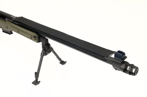

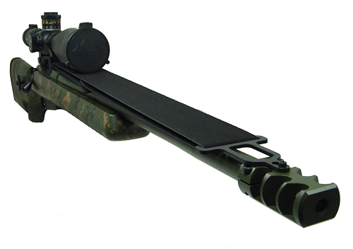

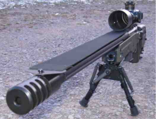

One more important note: When shooting across relatively flat terrain, the lower you are, the worse the heat shimmer will appear. Get up from prone to a bench height and images can clear up significantly. You can further reduce the heat induced haze or shimmer if you can shoot from an elevated FFP or to an elevated target; better yet across a valley doing both :)
the added heat coming off the barrel making it worse.
If your getting the heat haze off your barrel, on top of the target stuff.. it is going to be really tough and it really is time to let it cool, blow on top of the barrel and shoot quickly or possible use a heat shield.
