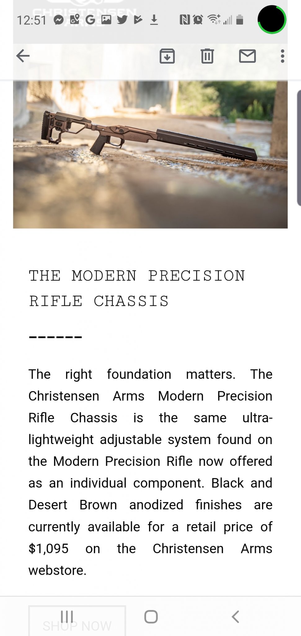

For those who asked in the past. Christensen sent out an email today that they now sell their chassis. It has an MSRP of $1,095.

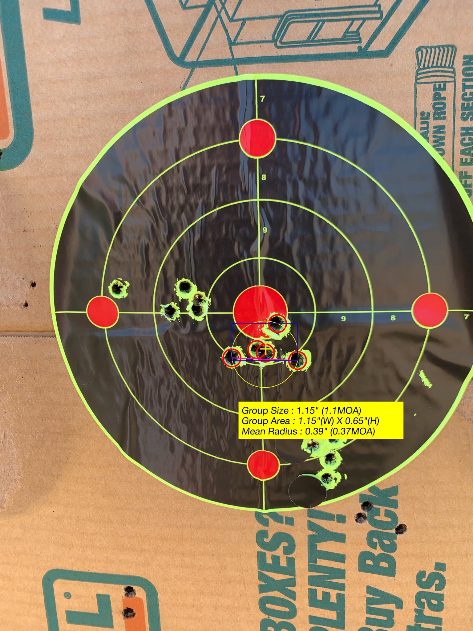

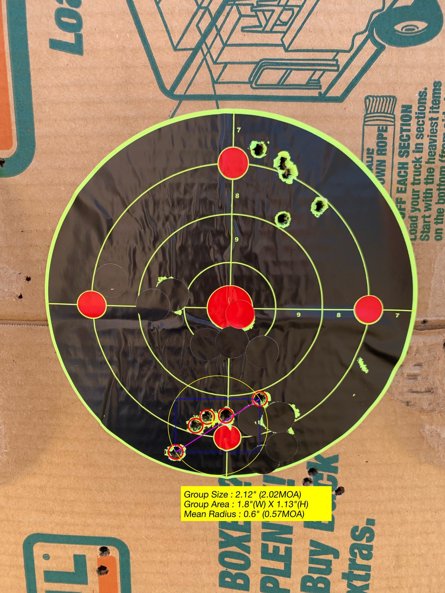

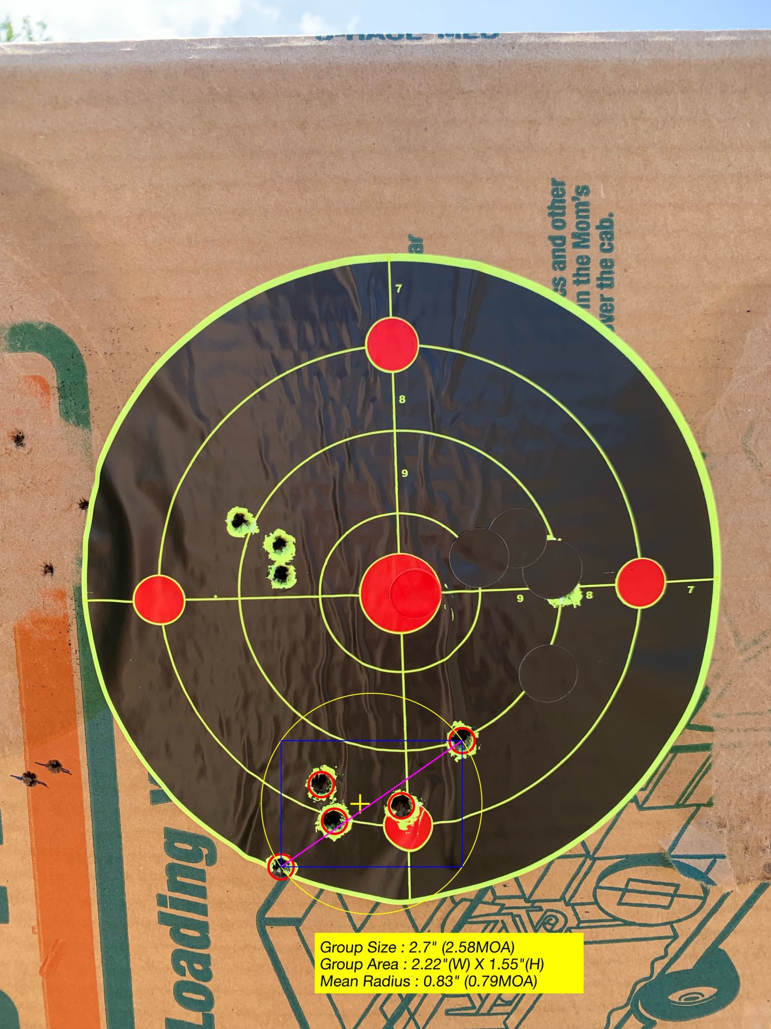

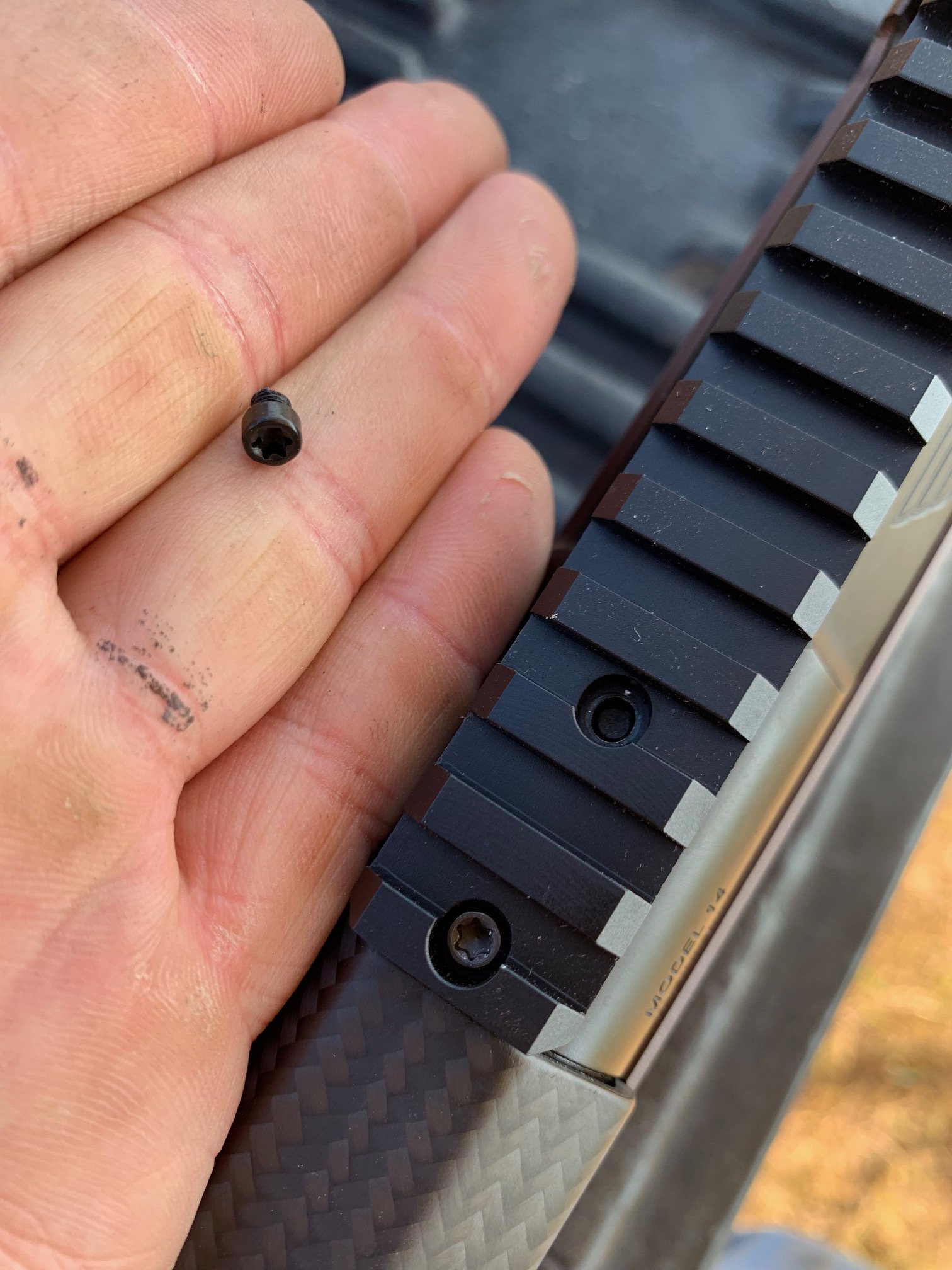

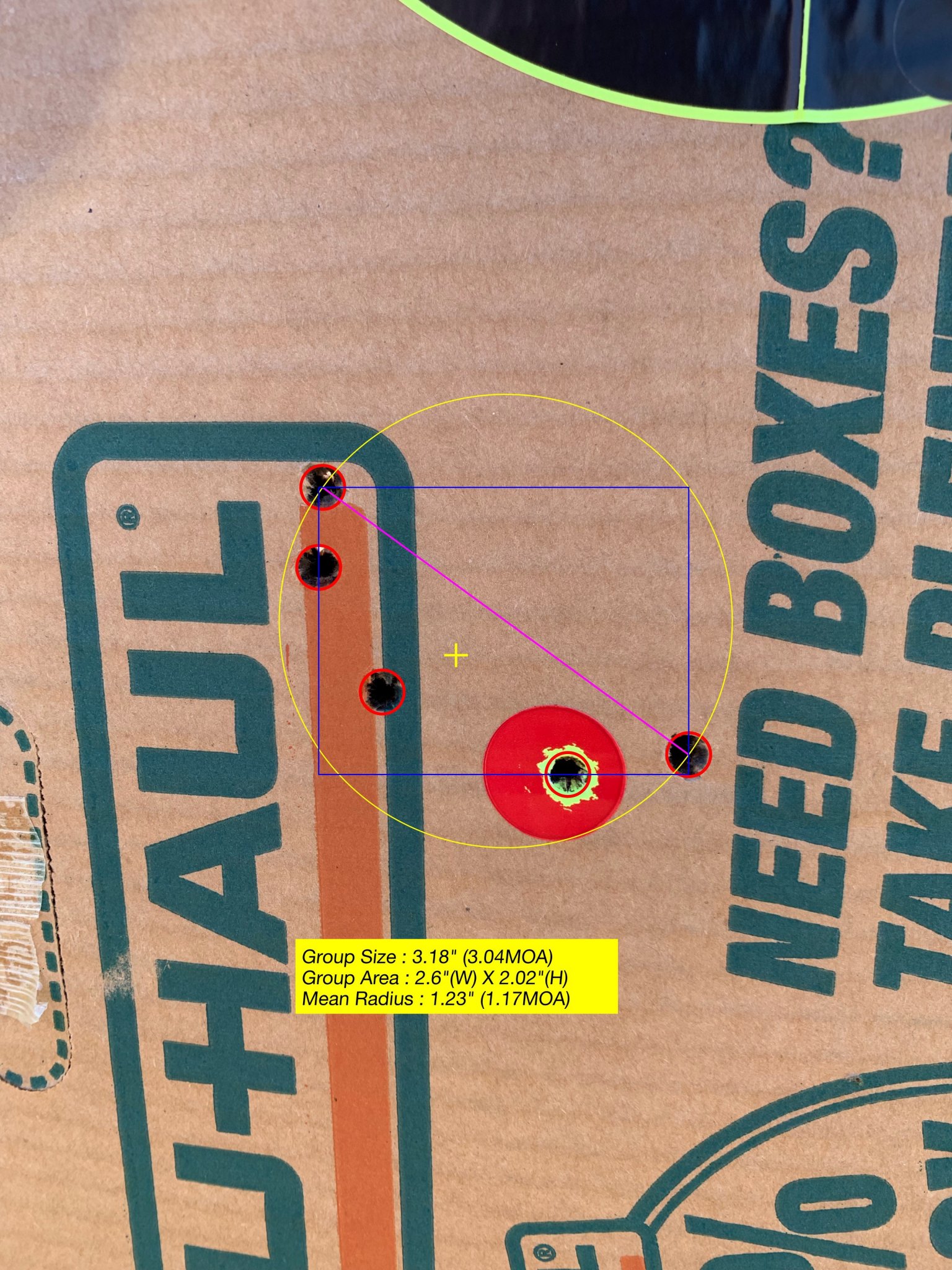

Picked up a MPR chambered in 300 PRC from EO about two weeks ago, and have been disappointed. FYI my first Christensen rifle.
I broke it in the first weekend of having the gun using Christensen's break in steps on their website and 4 boxes of Hornady 225 ELDM and 212 ELDX. Throughout the entire break in process it never printed under 1 MOA and hovered around 2-3 MOA (forgot to take pictures). I was not immediately discouraged as sometimes it can take a while to tighten up throughout breaking in...but it didnt. So I give it one last cleaning and put it up.
Fast forward to this past weekend. I take it out to shoot and go to check torque on the scope bases and scope rail and notice one of the four rail screws had sheared off (partly my fault as I should have checked the torque on these before installing scope). So I'm thinking that this has to be causing the accuracy issue. I go ahead and tighten down the three remaining screws to 25 in-lbs and put the NF NXS back on it to see if it will group any better. NOPE, did not help at all. I did get one group at 1.1 MOA, but that is the best I have seen and haven't been able to duplicate. FYI I shot 5 shot strings with about 15 mins in between each. Ammo was 212 ELDX or 225 ELDM, the only factory 300 PRC ammo available.
FYI I have been shooting it with a SiCo Omega, I tried it w/o and same results.
It's very hard to spend $2k+ on a rifle and to see it shoot 2-3 MOA groups. Has anybody seen accuracy issues like this from Christensen? I will be calling them today to see if I can send the rifle in, will report on what they say.
Attached is 4 of the groups.
