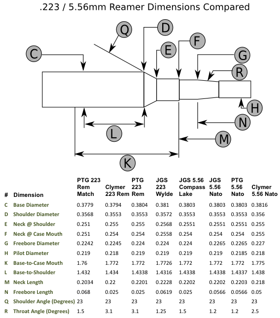

So...
.223 Wylde
.556 CLE Match
.556 MOD 0 (Noveske and the V Seven Match off-shoot)
.556 Israeli Match
@260shooter, I've reached out to Craddock...still waiting on a response

So...
.223 Wylde
.556 CLE Match
.556 Israeli Match
I've got the first three of the 4 you list. Several Wyldes, couple CLE, and one Noveske. Cant tell any difference.
And btw Mk262 and the CBC, different lowers with worn springs, buffer weights, and different gas hole sizes in the barrels, created more problems than the chamber design for me.
Once the function problems were identified, the accuracy was the same. Ymmv.

So...
.223 Wylde
.556 CLE Match
.556 Israeli Match
Be interesting to see the drawings and specs..... might all be essentially the same
