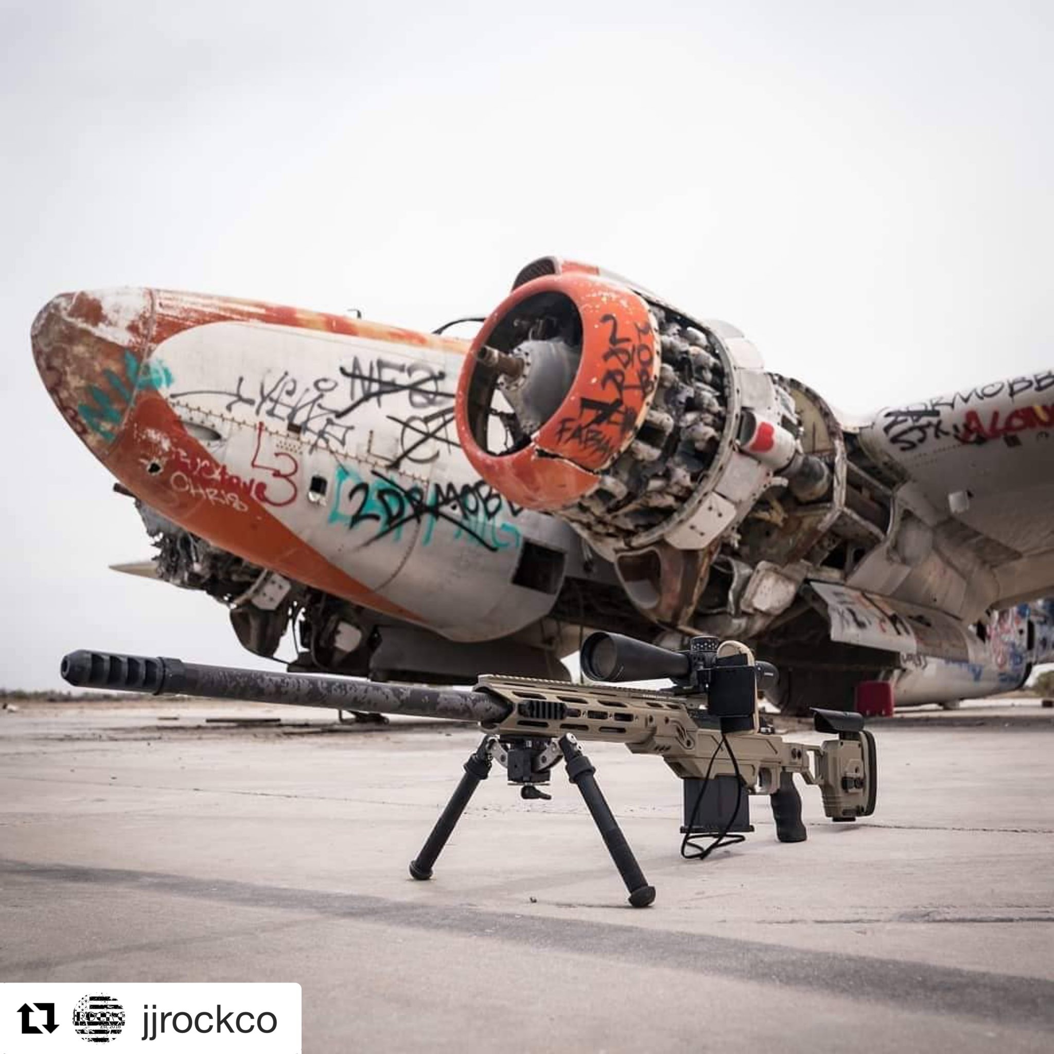

Team JJ Rock will be using Proof Resesrch Carbon Fiber Barrels this year in a number of ELR matches including KO2M, South Georgia ELR, WLSC and the Q creek event.
Good Luck and great shooting

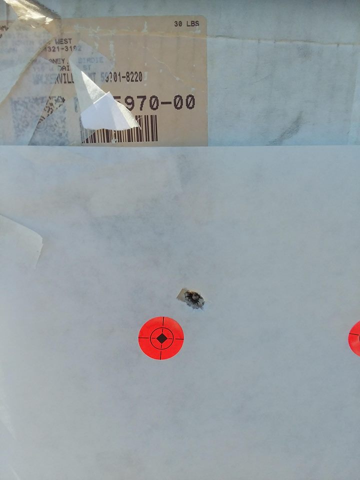

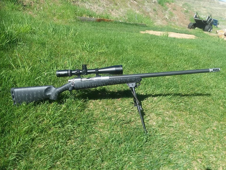

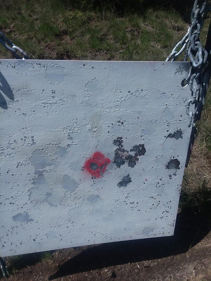

The most accurate rifle in my house is a 300 win mag with a CA Sendero CW barrel... This gun will almost shot one hole at 100 yards .. Gun was also just to easy to do load work on as everything we tried just shot well.. The main consensus is that proof are better barrels overall... My next build i am going to try a Proof as CA hasn't had any barrels available for a while now..Pics of rifle, 100 yard 3 shot and 804 yard using up rest of ammo from load testing.... Dave
