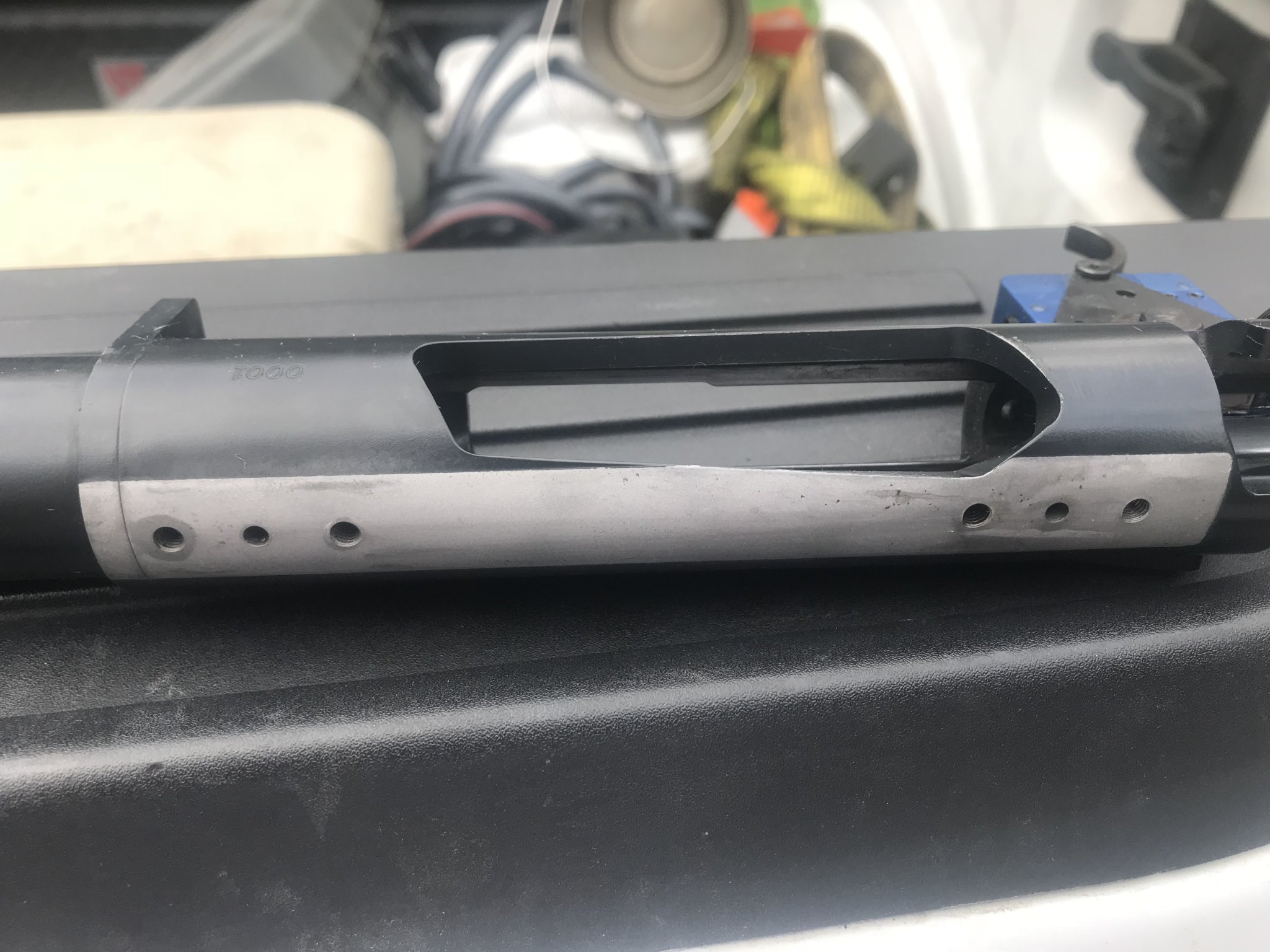

At what point or time frame does Cerakote start to wear off and chip around high traffic areas? Bolt, bolt handle, etc etc.
This barreled action has 1183 rounds on it since December.

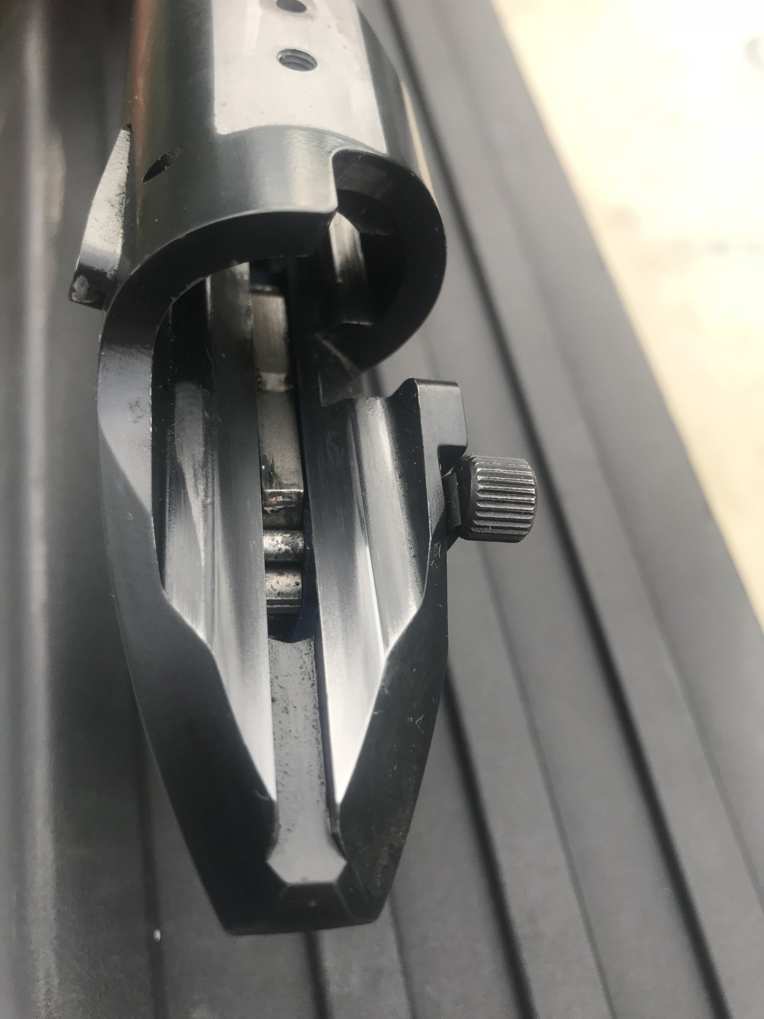

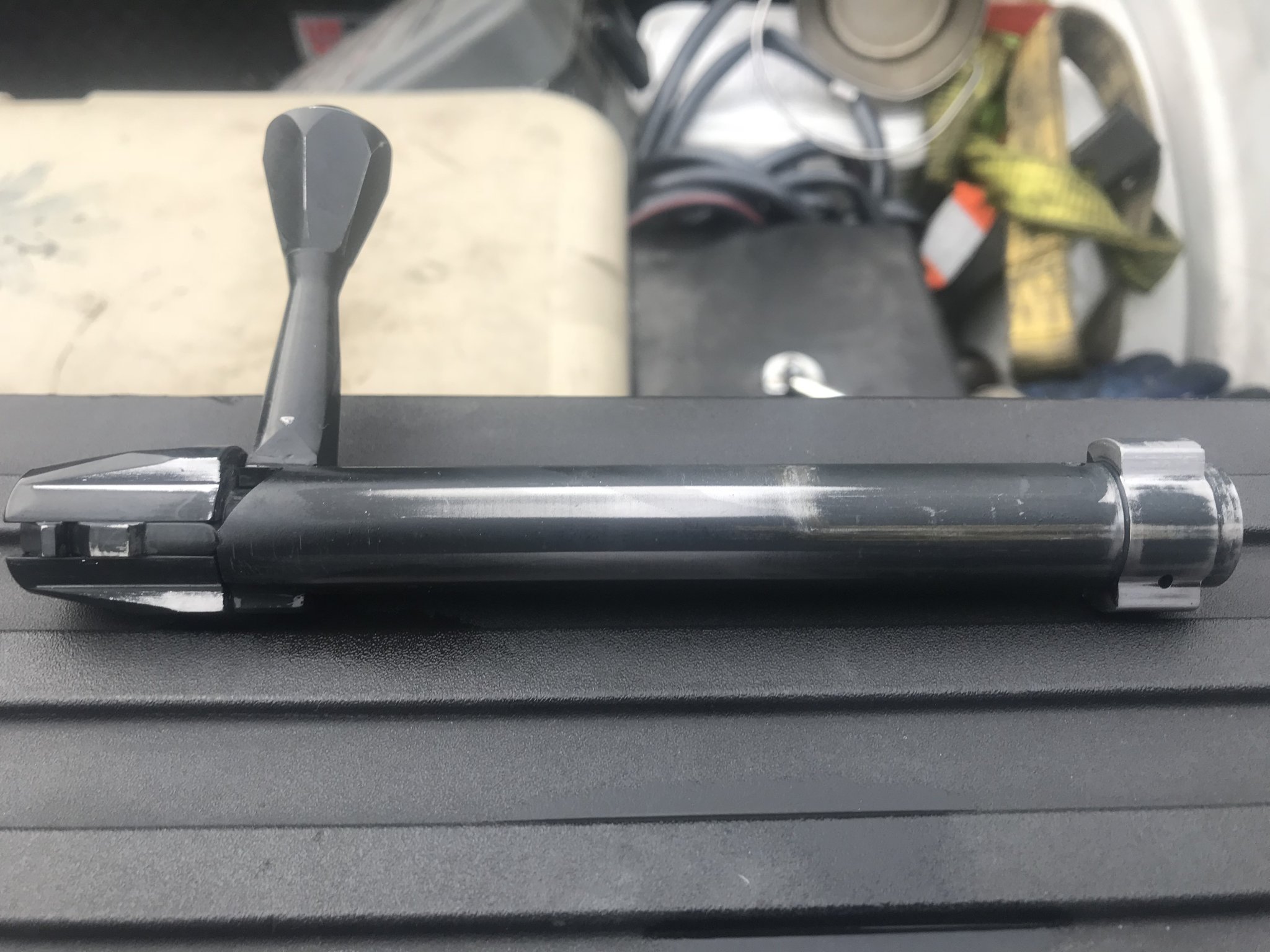

If it’s applied properly and cured fully it’s gonna take a hot minute to wear it down. My first rifle, that was cerakoted six years ago, and has had three barrel changes (over 8k rounds) and who knows how many dry fires has some signs of wear on the bolt where it touches the action during cycling and the bolt handle has a shiny spot where my hand has worn it.

My scope base came loose Saturday. I got around to loc titing the bolts yesterday. When I took it off I noticed he didn’t remove the base to Cerakote. He left everything together.

And that makes sense but it was obvious that he removed the base and blasted it then reinstalled it before spraying.

Who did the hex machining on the bolt?
