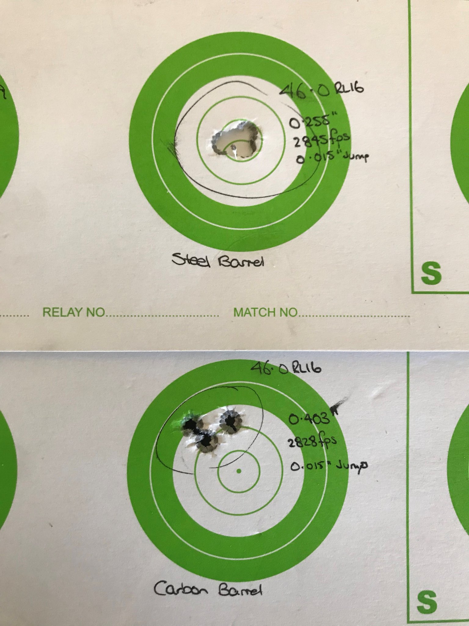

This was the last lot of load dev at 100m with two rifles using the same load. The top target is using a proof research steel medium palma barrel and the bottom is with a proof research carbon sendero barrel. both barrels are 26" in length. I initially got quite pissed off with the carbon build when I started shooting it as it was shooting at MOA or just under, turns out I'm actually just really shit at shooting lightweight rifles off of the bench.
The carbon took about 120 rounds before it sped up.
How do expect the 2 rifles to shoot the exact same load and retain the same accuracy from both?
It's a starting point, I don't expect it to be retained. I am interested to see how long it remains similar for though using the sierras
