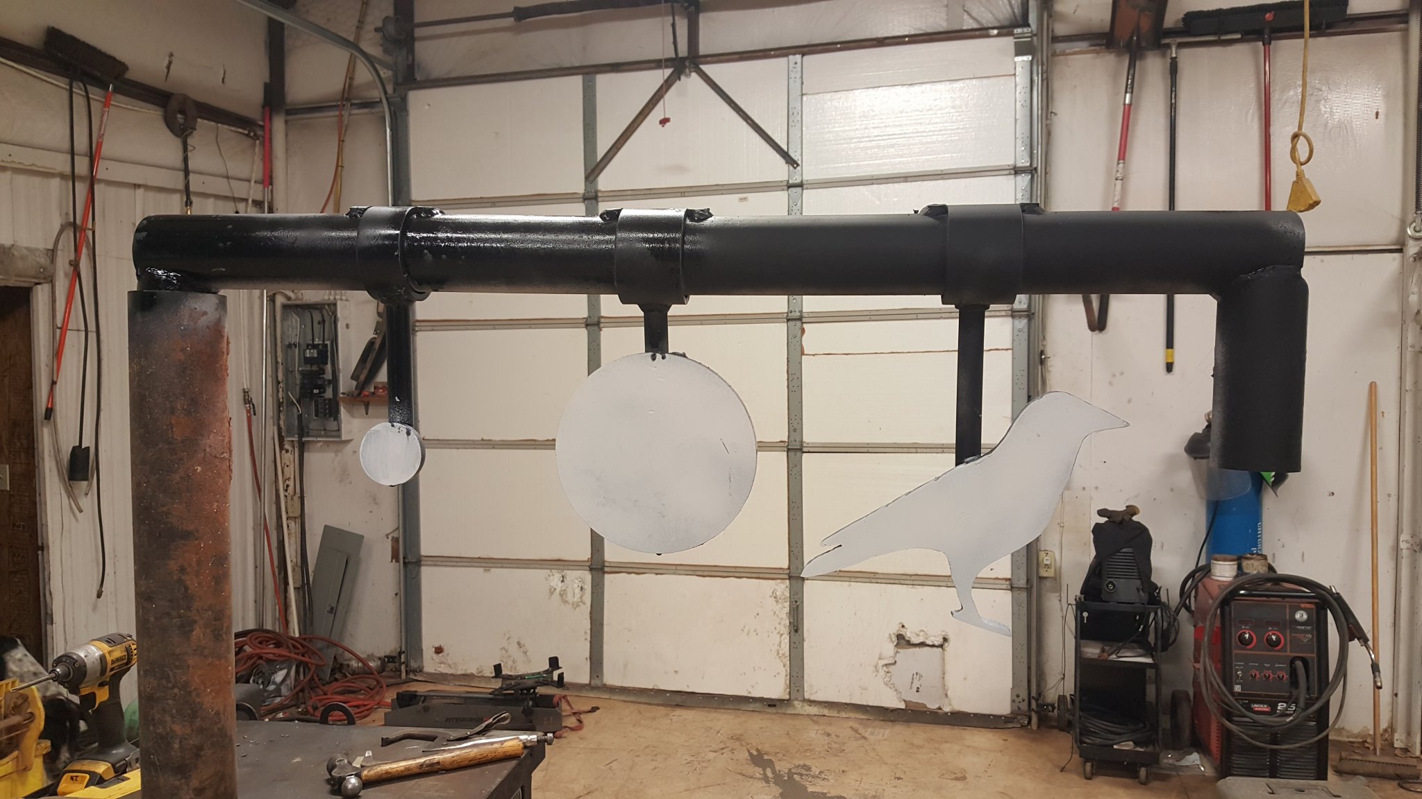

Shooting at metal is fun but there is risk. I have steel plates set up for pistol, many times during rapid fire the plates will swing back past their tilted forward position.
Sturgell
Belligerents
Dec 21, 2012
9
1
6
31
Oklahoma
#18
The 3/4 scale crow and the 5" circle are 1/2" and they just kind of make a smack, no ring, no swing. The 1.5" on the far left is 1/4 or 3/8 it's noisy and spins like crazy.
I have made others that hang from chain and they ring really nice and have a lot more movement. 20180111_140952.jpg
