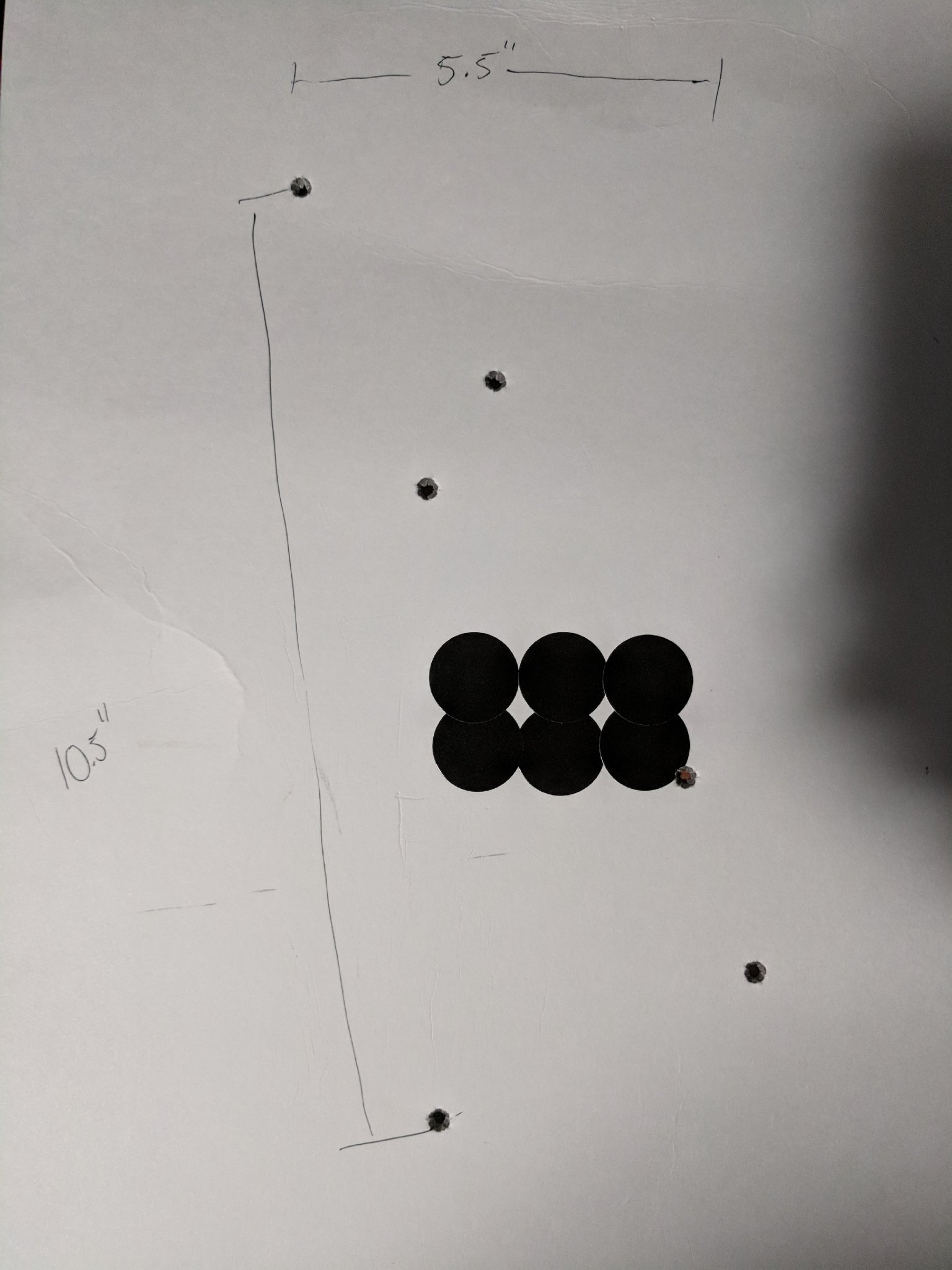

I tested the effects of this on accuracy today and it is VERY noticable. 6 rounds single fed by pressing all the way into chamber and then releasing bolt shot .7moa. 6 rounds may feed shot at 2moa. Another set of single feeds shot .8moa.
I've never had to go more than 3-4 thousandths with other semi autos so it makes me think it's something to do with the lighter bcg and heavy spring.

Plunk test goes fine in all my lots. Using both a Lee fill size and Hornady Custom Grade full size. Both had this is but Lee was better after increasing nexk tension to .006". It's better now (.003-.010") but still problematic for long range shooting. See picture for group at 1060yds shot a week ago.
Width is half moa and vertical is .95MOA (10.5"). I'm not however ruling out another issue: rear bag settling. Tested slightly different bag hold and pressure (increased pressure) and found group to tighten substantially at 100yds. 2838fps StDev 18 ES 38. Ironically, if you take a min max of velocity 2823 and 2853, the difference is .8-.9moa elevation, nearly identical to the vertical spread in the group. And the same load (exact ammo made for MSR10) produces an ES of 15 in my bolt gun, so it's something related to this gun. I used to get ES of 18-25 but it's gotten bigger due to unseating (At least I think due to that.. )
