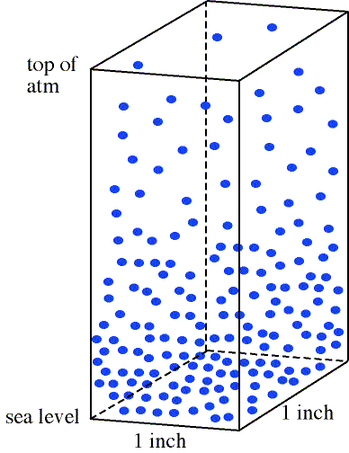

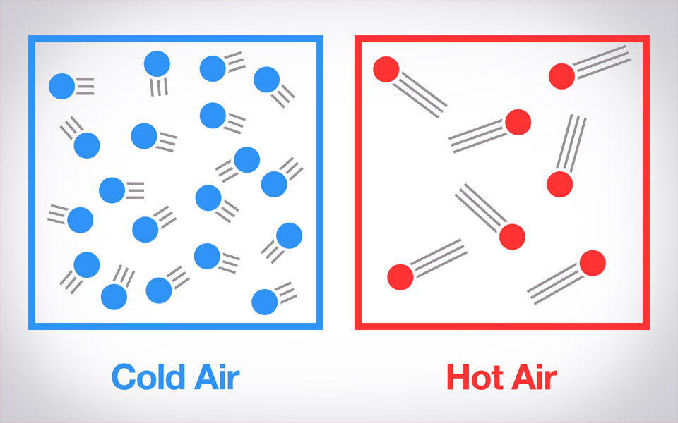

Air Density
Bullets Like:
High Temperatures
High Altitude or Low Station Pressure
High Humidity
Less parasitic drag on the bullet
Fewer dots mean less drag on the bullet
Altitude is a factor of air density in shooting
Hot air excites the molecules and they move out of the way, cold air masses them together to stay warm.

I’ve taken a few thermodynamics and chemistry courses, I understand the theoretical effects of temp and air density (please don’t take that as me being rude, I’m just explaining my background). I’m mostly confused at the massive decrease in drop that I saw. I need to increase my MV from 2740 to about 2875 to line up with what I saw, even after accounting for the DA shift and AJ, which just seems wild to me.
