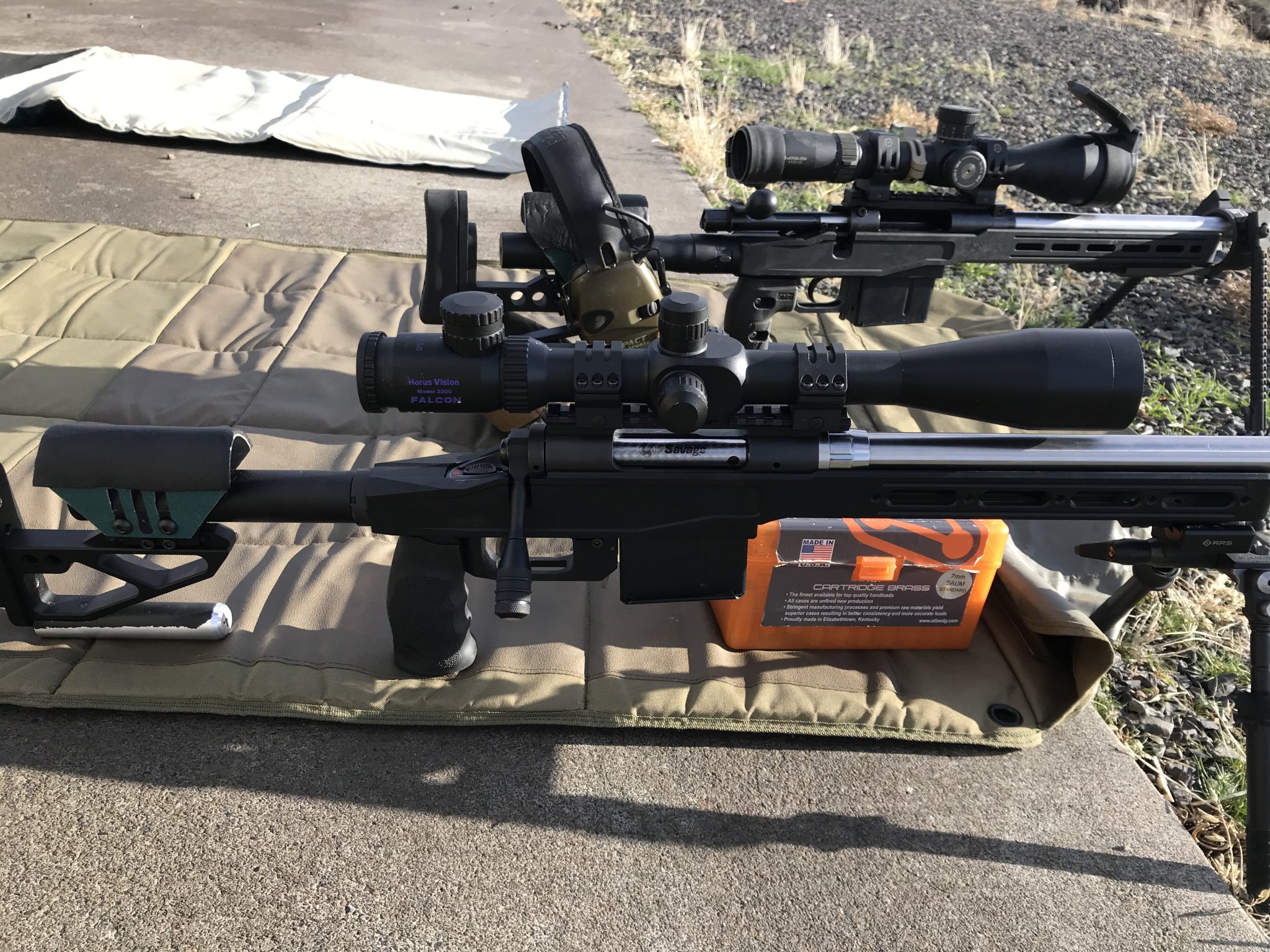

Similar to my situation. I wanted a rifle for cheap and I wanted to get into reloading. I ended up buying a TC-Compass in 6.5 CM. cost me $280.00 I bought a trigger kit and upgraded the bolt knob. For Glass I went with Athlon Aries BTR which was really more than i wanted to spend but is a quality optic IMO for the price point. The TC_compass will shoot about .5-.6" (3-shot) group at 100yards. After that the barrel heats up, but will still be at about an 1" with 5 shots. For me that was running 140gr ELD-M ammo with H4350.
While shooting the TC-compass I am buying (pc-by=pc) the custom rifle I want. More of a heavy bench rifle. I will keep the TC-compass for hunting duty cause it is nice and light. If you want to learn more about the TC Compass and reloading take a look a Jonny's Reloading video's on YouTube. He got me into reloading and I learned allot from his videos and Panhandle precision videos.
As far as reloading. I went with the Lee Classic cast press. It is a nice entry level single stage. That said If i had to do it again I would have spent a little more and got something better. I, planning on selling my Lee Classic and upgrading to a Mech Marksman. For powder measure I use a Lyman Gen6 Digital powder measure and when I precision load I verify weight on a GemPro 250 scale. I prime off press with a Frankford arsenal hand primer. I like it cause I can sit in front of the TV and prime all my brass while watching a movie.
All in all for reloading, I have quite a bit of money tied into it. Reloading to me is therapy so i love it. I don't really do it to save $$. More of a hobby!

This savage 11 shoots awesome but is a bit of a money trap and has ejection issues now on its third barrel.
The cheap In cost of a savage has possible limitations in the future but isn’t an issue if your ok with that going in.
I’m still perfect satisfied with me Lee Classic Turret
