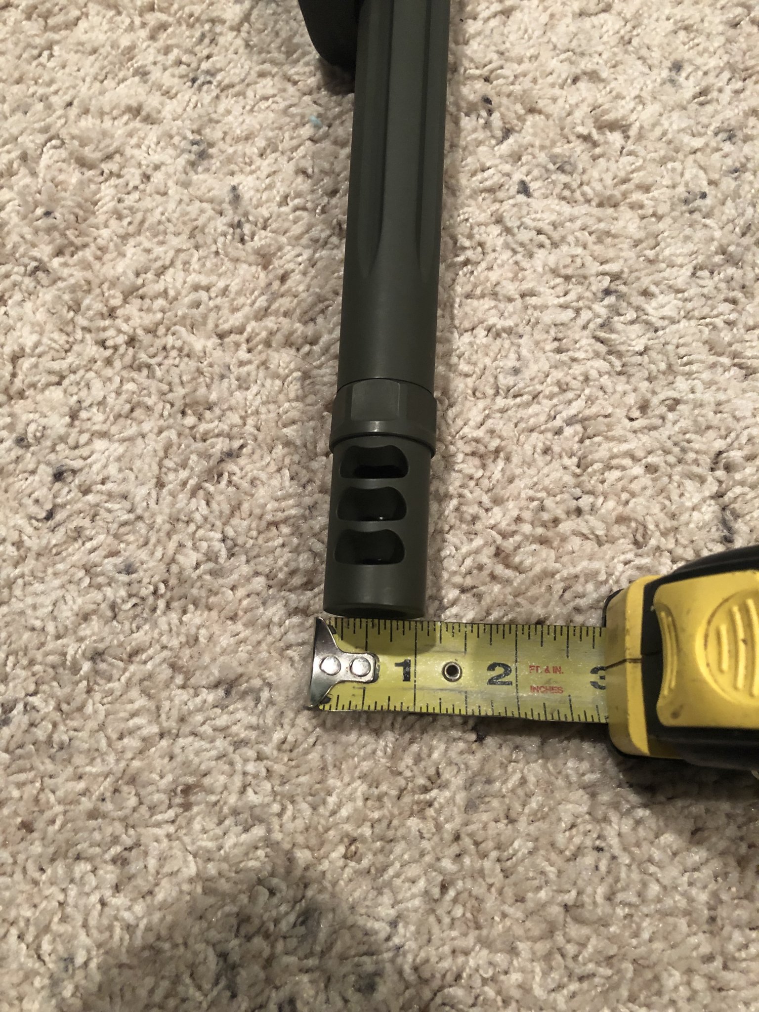

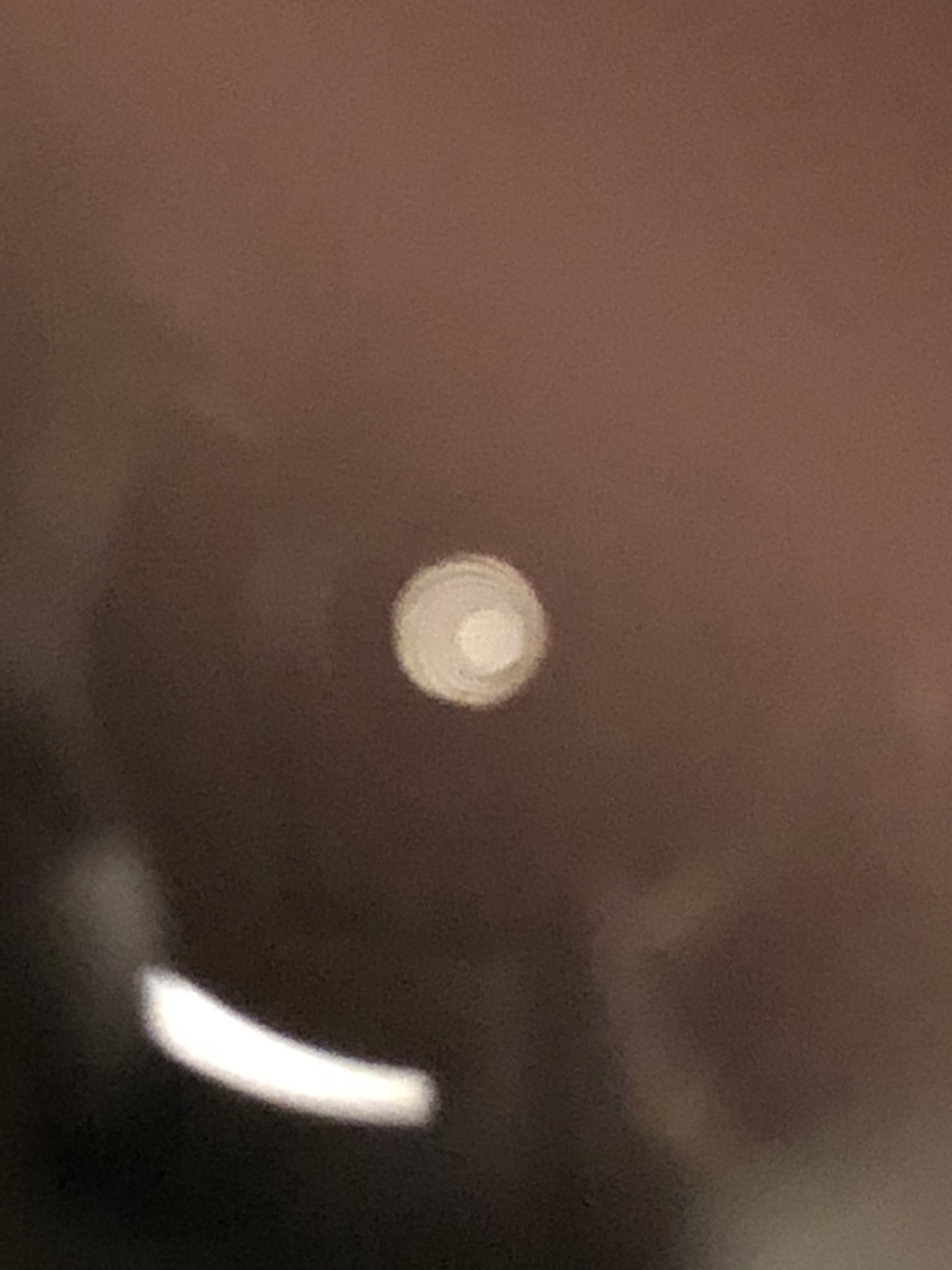

Purchased a rifle third hand (owner #2 never fired it) and the thing looks pretty much brand new. It was a custom build from G.A. and I’m finally getting it ready to zero. My question is do I go through the process of scrubbing it after every shot assuming it’s never been broken in or do I just go with it and see how it does? I can try to provide a picture of the bore but as I’m sure you guys know that is a rather futile endeavor. Thanks in advance for any help you offer.

I know ultimately it’s whatever I choose to do or not do. I’m just trying to keep it the 3/8 MOA gun I believe it to be. I didn’t want my inexperience with a precision firearm to cause damage or affect the accuracy.

Considering my barrel is about an inch thick I’m not so worried about that. I’m not sure what the profile is I’d call it “bull”. It’s stamped GA so I’m thinking maybe Bartlein. Either way my wallet will be smoking before the barrel if I shoot that much.
