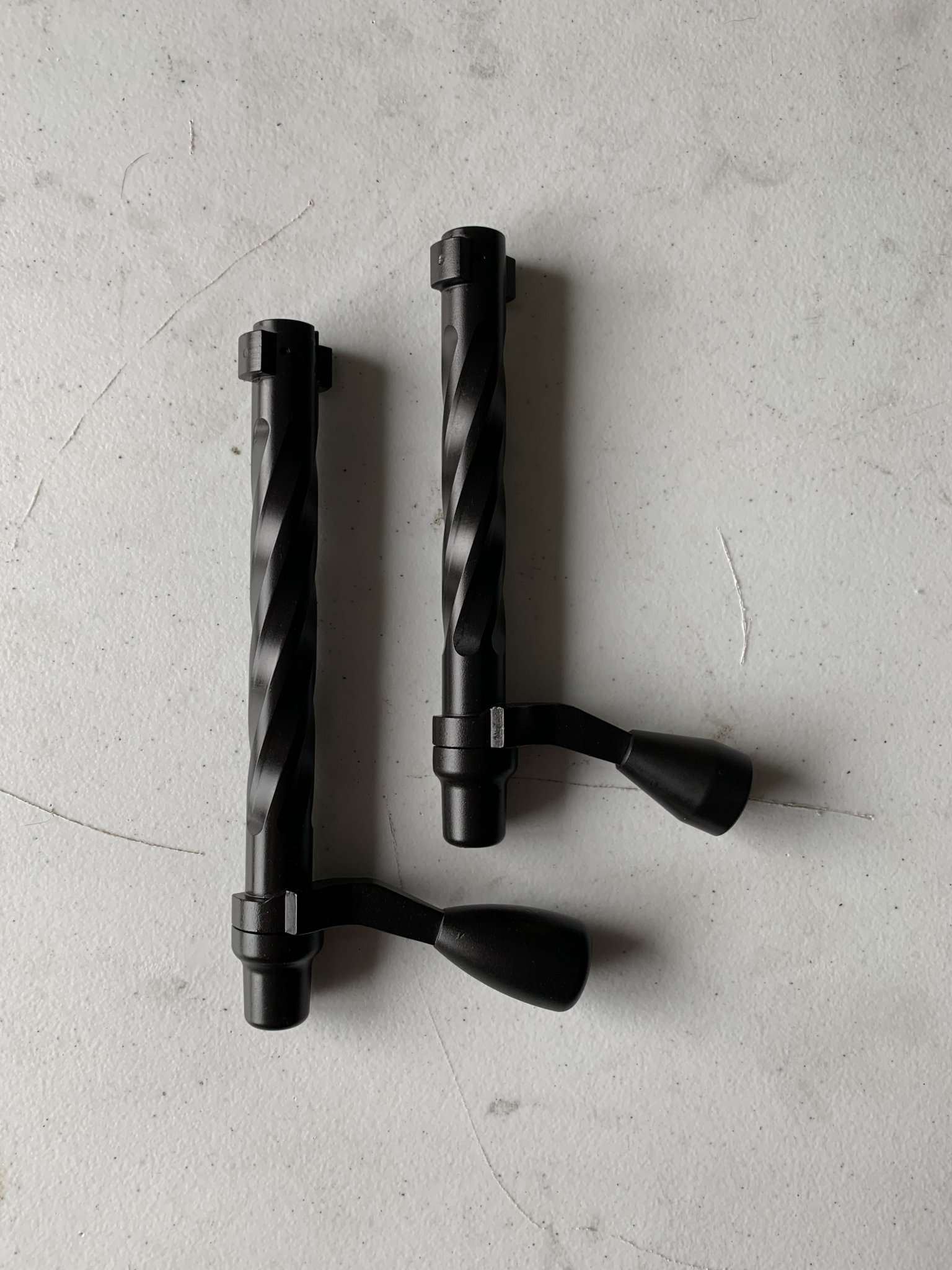

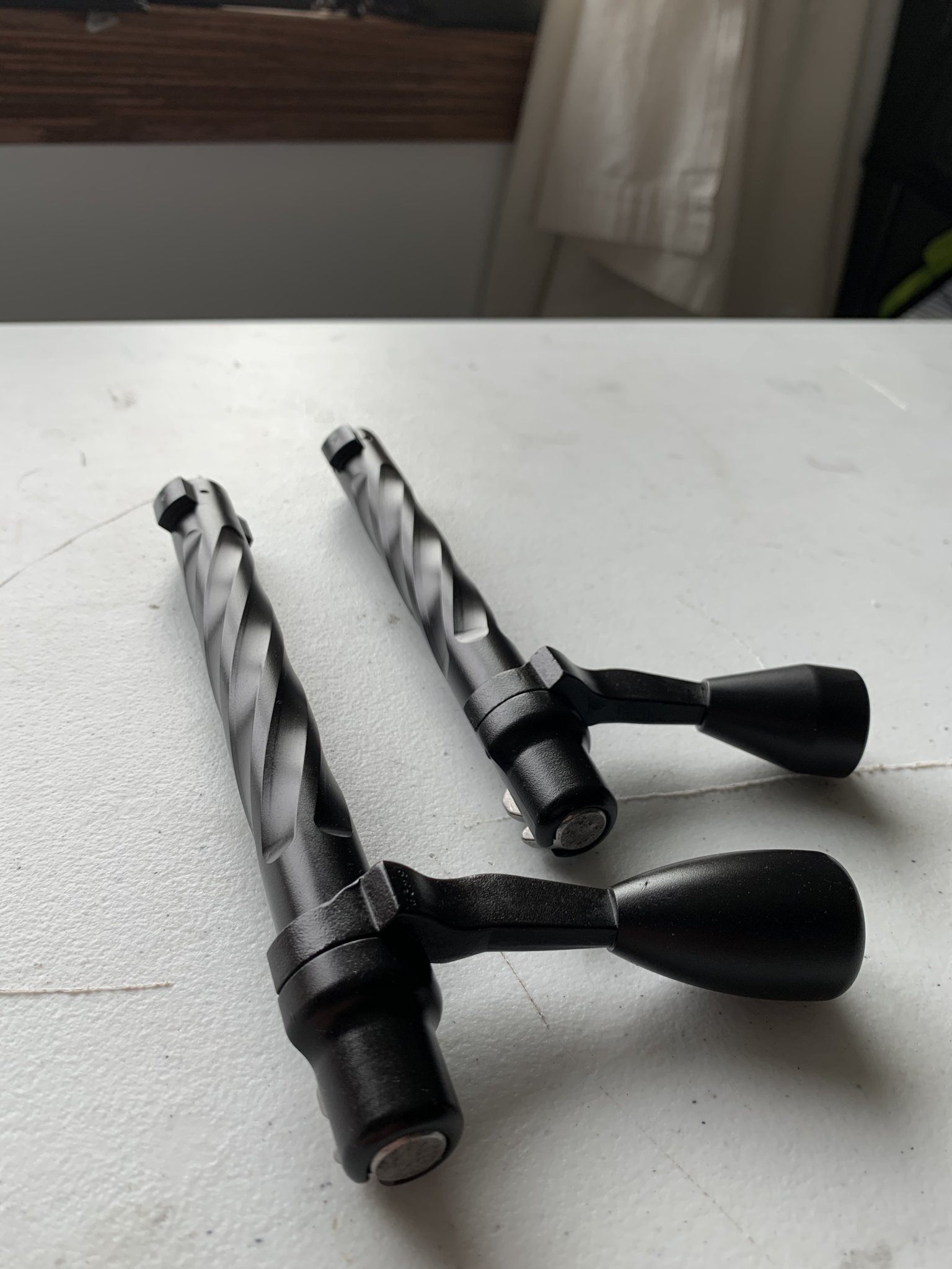

It came down to buying the Bergara Premier bolt for $300 or having LRI flute my current bolt for about $50.00 (includes shipping) and I decided to go for the LRI option. I know that the Premier bolt has some other advantages like ease of cleaning, already fluted, and is a drop in however, I couldn't justify the extra $250.00. If the LRI options doesn't work out then I will purchase the Premier bolt. Thanks for the recommendation.

I’ll add to the above and note both were also cerakoted by LRI as well. Which could attribute to the smoothness

Thanks for relating your experiences with LRI. Everyone says that LRI is a great company and provides terrific gunsmithing. Mailed my bolt yesterday. Will let you know how it turns out.

They also emailed updates with pics of my bolt from receiving to shipping it back. And turn around time was about 2 weeks if I remember correctly

Just a follow up on my bolt fluting experience with LRI. Any business can learn from the way LRI runs their company. They keep you informed at every stage, email when part(s) received with full description along with an assigned job number, a completion email with a photo of your part(s), a shipping email with tracking information, a follow up email ensuring that you received your part(s). Finally, the customer service was excellent and the bolt workmanship outstanding.
