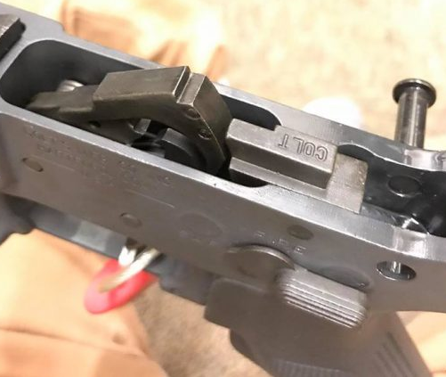

I recently purchased a complete Mk12 Mod 0 upper from Precision Reflex Inc. Unfortunately, the lower it's being mounted to is an early (PreBan) style with the Colt Sear Block similar to the one pictured.

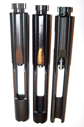

The bolt that came with the upper (similar to the far left in the image), is of the newer variety and doesn't have the cut out to clear the block like the old one did ((similar to the far right in the image).
My question is this: Without modifying either the BCG or the sear-block, what would be the best course of action? I believe the bolt was headspaced at the factory so would the best option be to change the bolt between the bolt carrier groups? Would it be better to get a whole new bolt and have it headspaced?
Any help would be appreciated as I'm extremely cautious with safety issues.

If the only difference is the cut out in the carrier it doesnt matter what carrier you put the bolt in.
Your question of getting another headspaced bolt is irrelevant since it wont change anything with the carrier.
Personally I would have just bought a new lower so you wouldnt have to deal with the oddball parts.

I would sell the lower and get a new one. This isn't a bolt guns. Bolts are interchangeable items. Easiest and best route is to sell the lower and get something that doesn't require random oddball bolt carrier.

What would happen if the sear block accidentally fell out?
Well, nothing. The thing is, the rifle I build off of is a brand-new, unfired PreBan Colt HBAR and its never been fired. In the ban states, its worth about $2500. Should I ever want to sell it, Id like to to continue being in relatively original condition.
That was my thought. I was just looking for confirmation that the bolt is the critical part in headspacing and the carrier is relatively immaterial. Thank you!

Somewhat off topic. Did Colt use what would have been an M-16 lower? Looks like the selector labels were irradiated and the block is pinned in the sear holes?

#9
Very much doubt it. Looks like more fuckery from Colt on their older rifles, like large pin lowers. Odd for sure.

The pre-ban Colt lower had that sear protection bar. You can have it milled-out, and still have a pre-ban lower. If you like the half-moon carrier, then keep it. Use the old bolt or get a new bolt. Lots of options. Like others have said, you can keep the lower or sell it, and buy a new lower. I like the M4 lowers for a Mk12.

I have a pre ban Colt lower. It had the sear block like the one pictured. I had the top part of the block milled off and use normal bolt carriers. It was milled flush with the top of the lower receiver.
